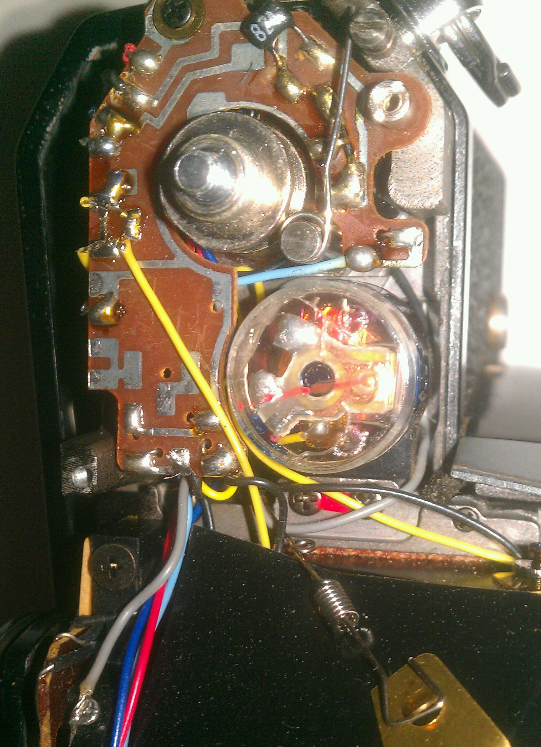

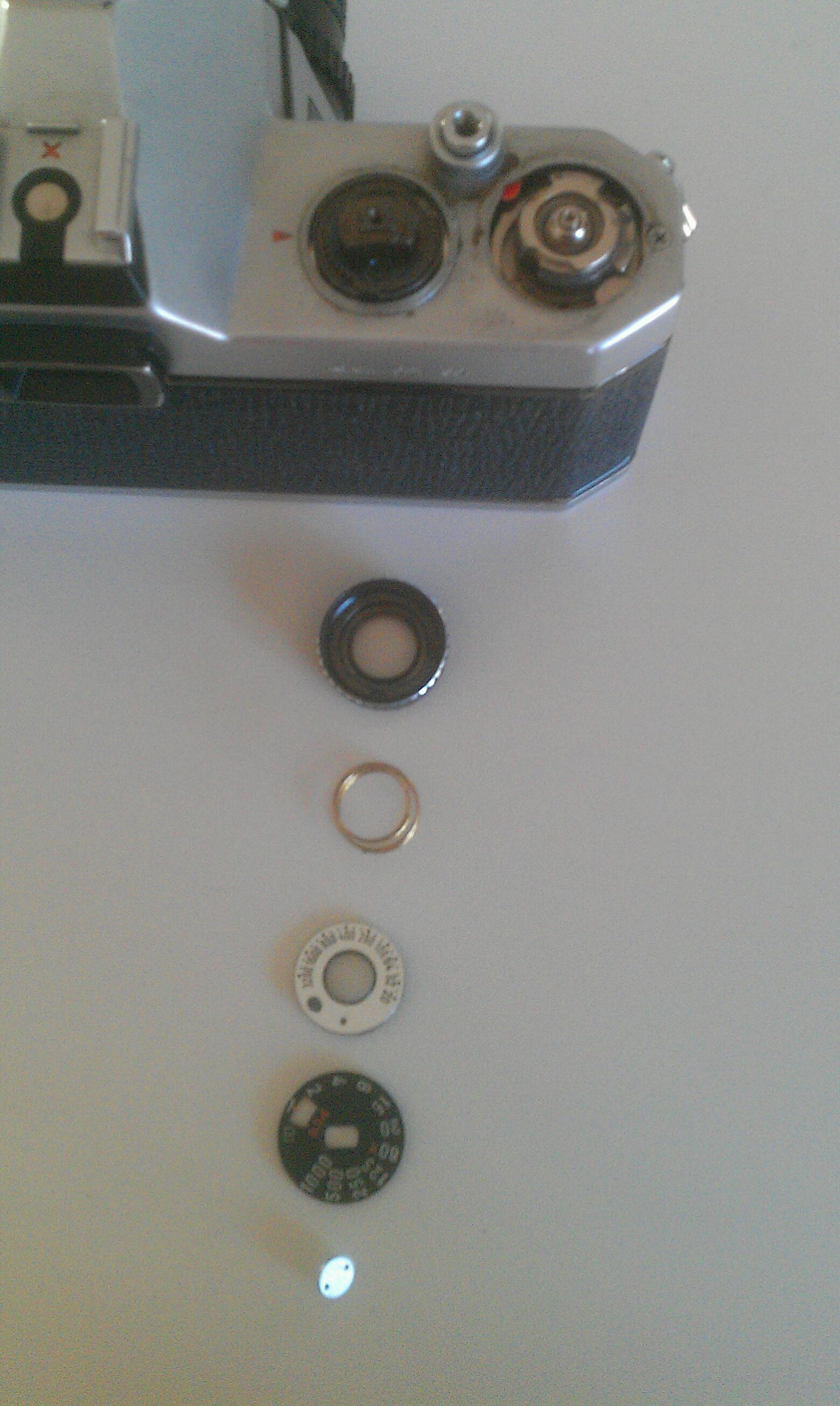

Photograph every step. Note the orientation of parts to each other even though something seems symmetrical - it may not be or it may have a small tab or pin on it. Be aware of the position of a part when the camera is at different settings. Take notes.

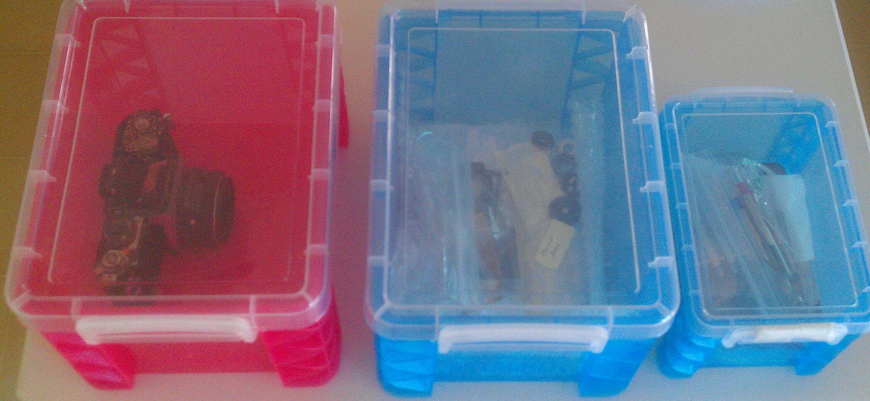

I place all related items in dedicated sealable bags, then everything goes into nice little boxes.
