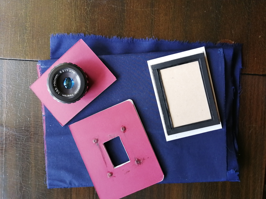

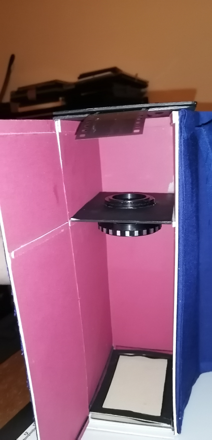

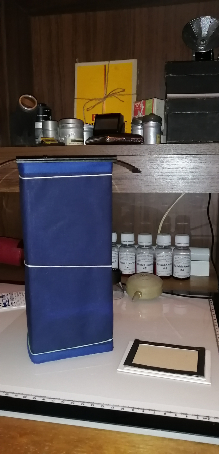

I brought a Mascot version of one of these home from a friend's shop to research for him some years ago.
As I'd photographed it beside a bookcase, I had reference points to take measurements years later and devised a scaled down version to take with me interstate to show my nephew and niece.
It's fixed focus and makes 6x9 prints from 35mm negatives. Scaling it back up to use 120 film or 4x5 would be easy enough, but I was aiming for tiny. The enlarger, a couple of small trays, and a small box of Ilford Ilfobrom 6x9 paper takes up less than a couple of pairs of socks in a suitcase. 😁
It still sits on the baseboard of one of my enlarger , but never got past the prototype and test run stage. It packs flat, with the lens being the thickest component at around 2½cm. I used a torch to make the exposures and I was using my two tealight candle powered safelights at the time - so, entirely portable, wireless and could well be used with sunlight. (I did try a quick cyanotype outside, but only proved that a great deal more exposure was required.)
My profuse apologies for my poor photography; these were merely explainer pictures when discussing it with a friend via text:
