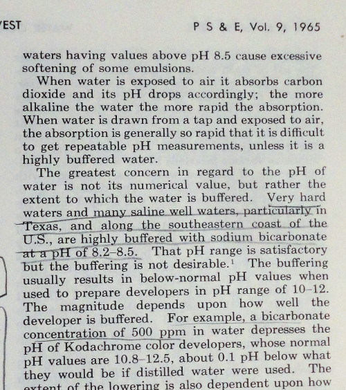

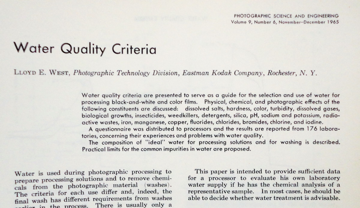

I'm gonna attach an excerpt from the only published water quality paper that I know of... it's from 1965, by Lloyd West of Kodak...
Basically the same thing as what other posters have already said..
