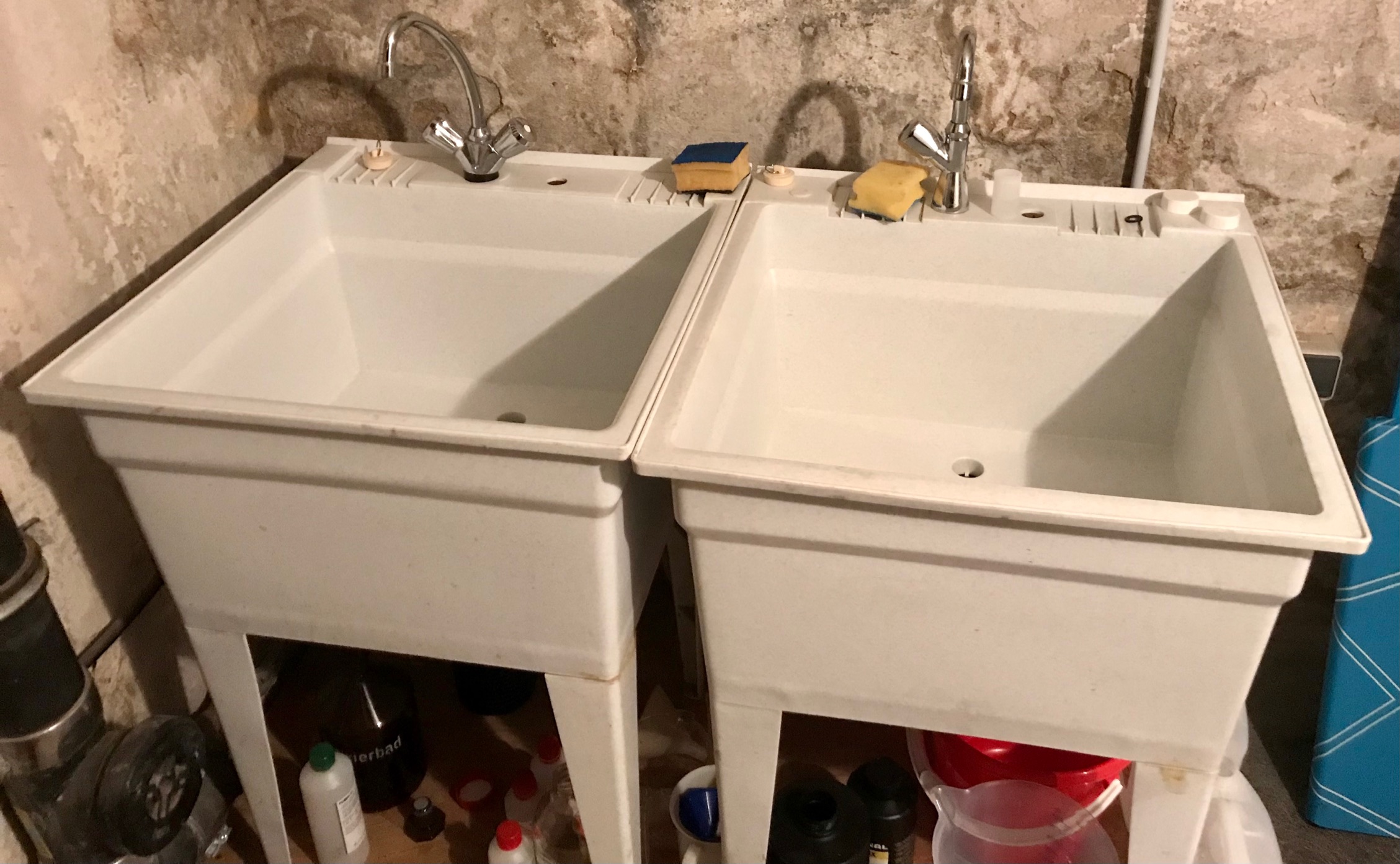

I need to print some larger prints from 4x5 negatives on 50x60cm paper. It will be RC paper for now but later I also want to try fiber at that size.
My sinks are only 52x50cm and look like in the image below.
How could I handle 50x60cm sheets using those sinks?
I guess it wouldn’t be a problem that the paper is slightly bent while rinsing but I need to find a way do constant add and drain water. I can’t come up with a good idea for that.
Drain pipe with an inner circumference of slightly more than 60 cm and a length slightly more than 50 cm, and some means of keping the pipe rotating in the sink.
I am not sure if I understand it right.
So the drain pipe would somehow stick in the outlet or be connected to it and the drain pipe would stand upward.
There would be no water in the sink but just inside the drain pipe together with the paper which would be rolled inside and the rolled paper would also „stand“ vertically ?
New water would constantly flow from the faucet into the pipe and constantly leave through the outlet?
No - that size of pipe will fit on its side in the tub.
Use the tub as a big, high sided tray.
The print goes into the pipe, against the pipe's inside, with emulsion facing in, and the pipe goes into the tub, and gets rolled back and forth between the edge and whatever you are using to make sure there is enough water in the tub, until the print has been washed,
