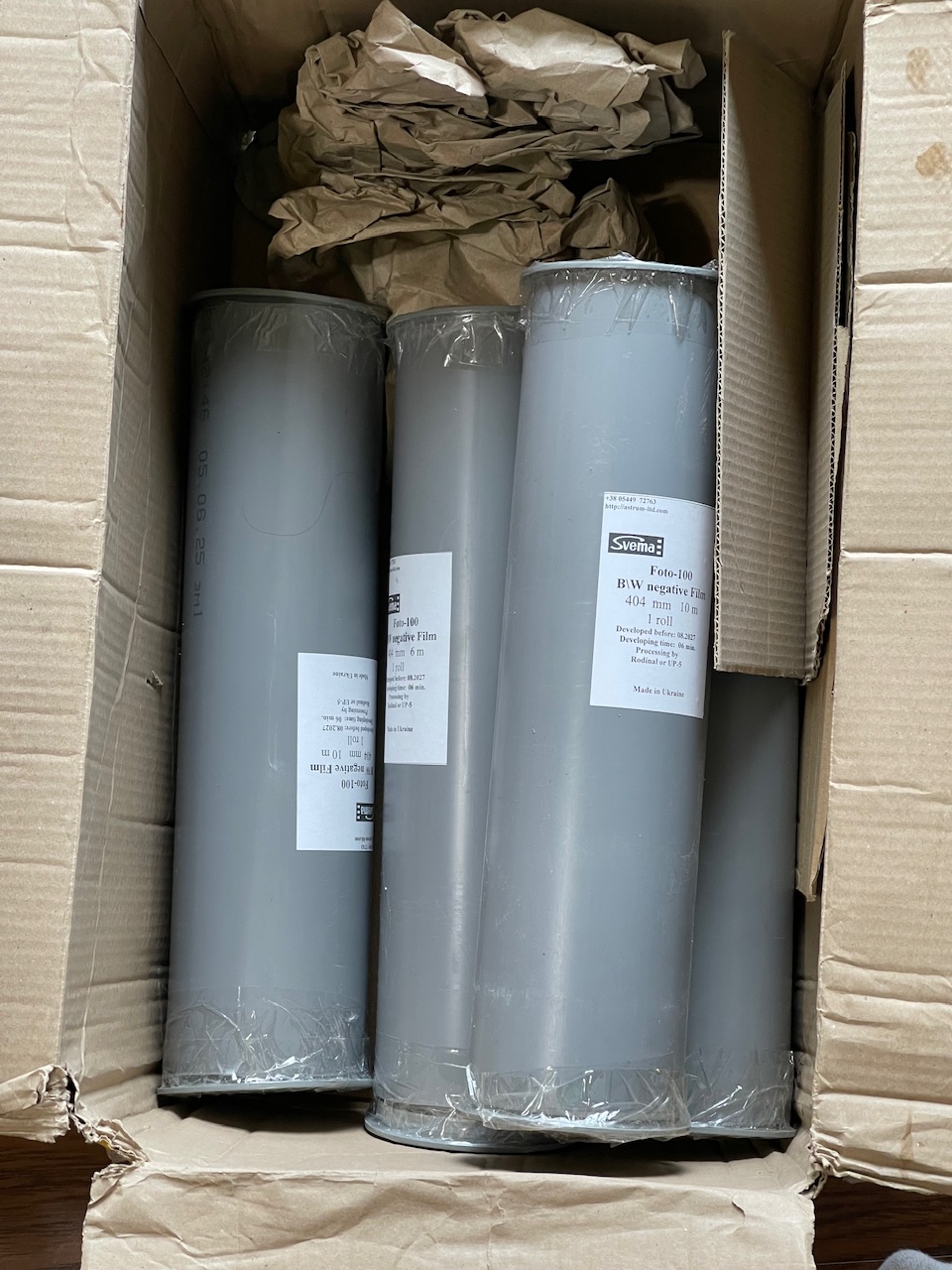

well, pertaining to the origin of my question, the film for these is here and it’s enormous! Now I need to find a new box to ship these in because the one I was planning on using isn’t big enough lol
