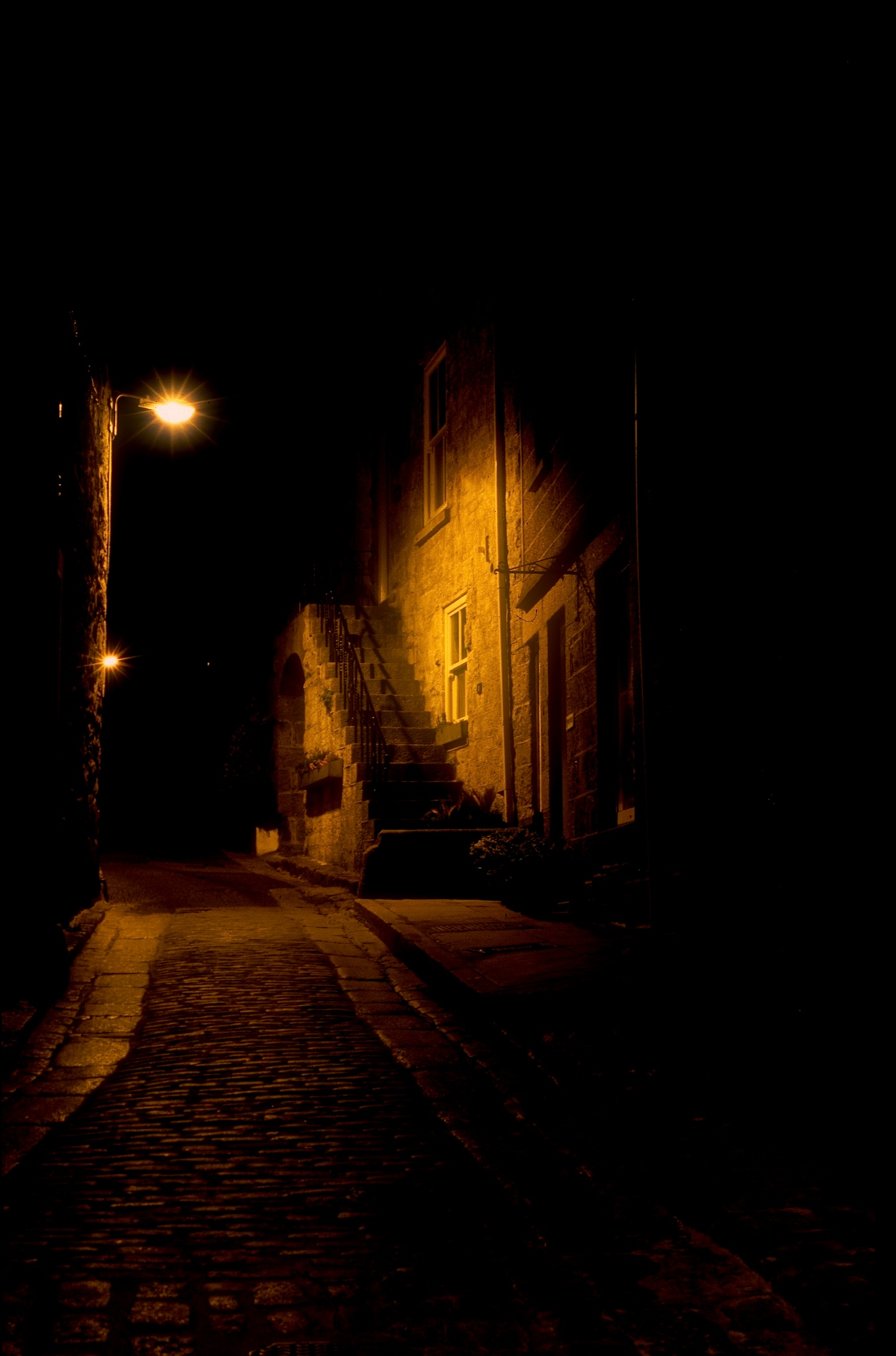

All very informative, this. Thanks guys. I had a basic understanding of RF before this but now much better.
My longest exposure was 25 seconds, if I recall, using Fuji Velvia (attached) to photograph a St Ives cobbled street. So I'm not used to thinking beyond that.
