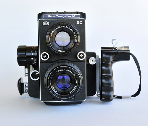

I had the Konica Omega Flex, my parents gave it to me when I graduated college. It's not really a TLR, rather direct view unless the user had the 45degree reflex finder. No waist level viewing, and while good in portrait mode, using it in landscape mode was a trick that I never got use to. Sold a year or later and got a Mamiya C33, which I later sold as it just too heavy.
The Koni-Omegaflex M mentioned above is a 6x7 TLR introdued in 1968 the same year as the Pentax 6x7. I'm not sure there were any earlier 6x7 cameras.

Koni-Omega Rapid cameras (but not the Koni-Omegaflex) are very out of favour and inexpensive these days. They are on the heavy side, but not huge. The lenses and the big viewfinder/rangefinder are great.
