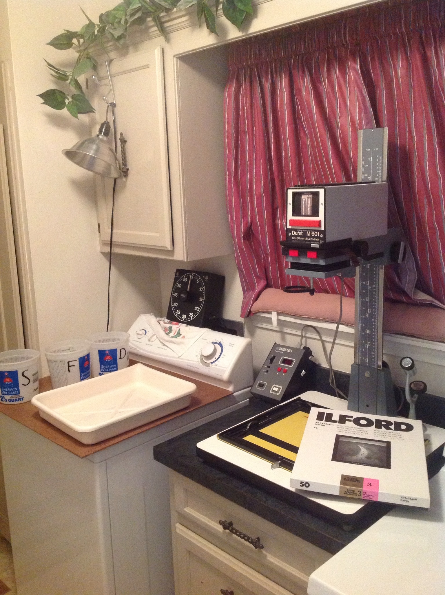

I have prints on my office walls, 8X10 and 11X14 from 35mm, 6X6, 6X9 and 4X5, most folks commment on the detail in the prints made from 4X5. On the other hand I dont see how you can fit a 4X5 enlarger into your workspace. As you already have a 6X6 enlarger you might consider an SLR with a 6X6 or 6.45 back, or move a C700 with 6X7 system, SLR or rangefinder such as Konica Omega 100 or 200 with a normal and wide lens. On the other hand a 2X3 Speed or Crown with a 6X7 basck will provide some movement, but if you want to use a couple of differnt lens you will need to move from the ground glass back to focus and then back to the roll back as the rangefinde is only set up for 1 focal length. A Horseman has differnt cams for differnt lens, but are still pricy.

Do you do your own processing and printing? If yes, then you already have gear to process 120 roll film. 4x5 (or any sheet film) is another ball game, and will likely require investment in more than the camera.
Printing? Will your current enlarger take a 6x7 or 6x9 negative. Even so, will it take a 4x5? If you do have a 4x5 capable enlarger, do you have the enlarging lens for the format (also true for 6x9).
