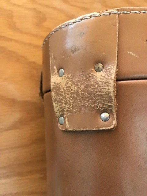

Recommendations please:
Svenedin
Mar 19, 2016
1,191
Surrey, United Kingdom
Med. Format RF
The surface finish is falling off and the leather looks very dry which is going to mean that hinge is at risk of falling apart. Personally I'd use neatsfoot oil and let it soak in to try to restore some suppleness to the fragile leather. It will darken the leather and may need more than one application. After the neatsfoot I'd just use a high quality shoe polish to improve the surface appearance. Kiwi Parade Gloss (genuine turpentine base) is my favourite (for my shoes too).
Truzi
Mar 18, 2012
2,650
There is something similar to neatsfoot oil that is made for lighter leathers and allegedly won't darken them. I'll try to remember to check out the bottle when I get home and get you the name. I've not used it yet, though, but bought it for leathers similar to what you have posted.
mgb74
Jan 24, 2005
4,773
MN and MA US
I remember a lengthy discussion about this a while back. Apparently the neatsfoot oil today isn't the same as it was a while ago.
Bottom line, what was recommended was some special and expensive concoction used by book restorers.
Helios 1984
Aug 4, 2015
1,846
Saint-Constant, Québec
What about mink or dubbin oil? I've been using this stuff on my winter boots for years, it keeps the leather flexible. It will darken it a little bit thaught.
Svenedin
Mar 19, 2016
1,191
Med. Format RF
It’s true that neatsfoot oil will darken the case from its appearance now but the oil will dry to an extent so the darkening is not as dramatic as it first appears. Also the current appearance is probably lighter than when originally made due to drying out and fading.
mshchem
Nov 26, 2007
14,613
Iowa City, Iowa USA
Sno Seal. It's an old wax/bees wax boot dressing. It's great stuff. Used to be hard to find backpacking stuff. Now it's everywhere.
Found it - Lexol NF Leather Dressing. I've not used it yet, but bought it for the same purposes you mention.
If the piece is strong and you're just trying to keep it functional, the oil should be fine.
If the leather is weak or thin you may also find someone who can remove the rivets and put a reinforcement behind the leather to take the load. That would be more important if you were trying to preserve the aesthetics of a weak piece.
wyofilm
Nov 12, 2017
1,158
Wyoming
I use Fiebing's saddle oil on my saddles. Great oil. It will darken the leather. Leather looks pretty dry which puts that hinge at risk. Keep in mind that too much oil will weaken leather, too. You will know the right amount of whichever oil you choose if you apply multiple applications without slopping it on. You will see just how thirsty the leather is. When the oil stops going in easily, I would think about stopping.
guangong
Sep 10, 2009
3,589
I buy nearsfoott oil at the local farm store and have used it successfully to restore old prewar camera cases, dried out horse leads boots and all kinds of dried out leather goods. It does darken the color of the leather especially where scuffed, but so what? At least th item is usable again. I apply generously to really dry items, let it soak in and then apply lightly a couple days later.
craigclu
Sep 8, 2002
1,303
Rice Lake, Wisconsin
Leather Honey will put moisture back without changing the appearance very much. It's very versatile and works well on everything from shoes to leather furniture and car interiors.

Sirius Glass
Sirius Glass
Jan 18, 2007
50,338
Southern California
I treated the hinges and straps with Neetsfoot oil once. It did not make it wonderful, but I expected that. Would it be a good idea to treat them again several times several days apart?
