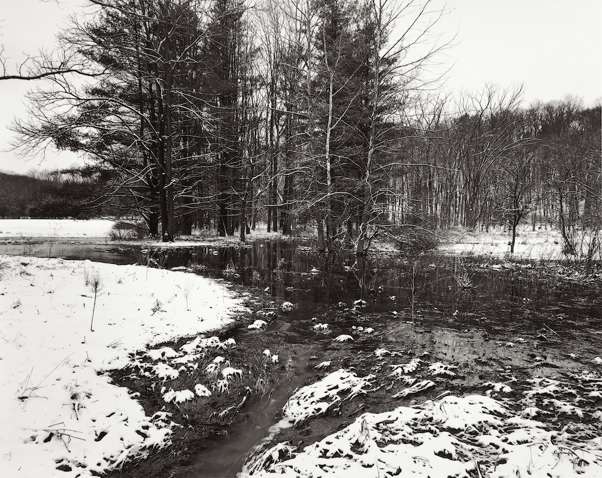

I take my 8x10 out in the winter. I pack a small kit with a single lens and only 3 film holders and a tripod. Good boots and gloves and winter jacket. Metering, development and printing are kind of a trial-and-error art. Some work and some don't. Here are a few 16x20" prints on Ilford MG FB. I especially like these two because the snow on the distant branches makes them more visible in large prints.
Also, I don't stop down too much, since I enlarge. So usually f32. I try to avoid 64 and 90 if I know I want a huge print with fine detail.

To avoid blown out exposures, use an incident light meter.
