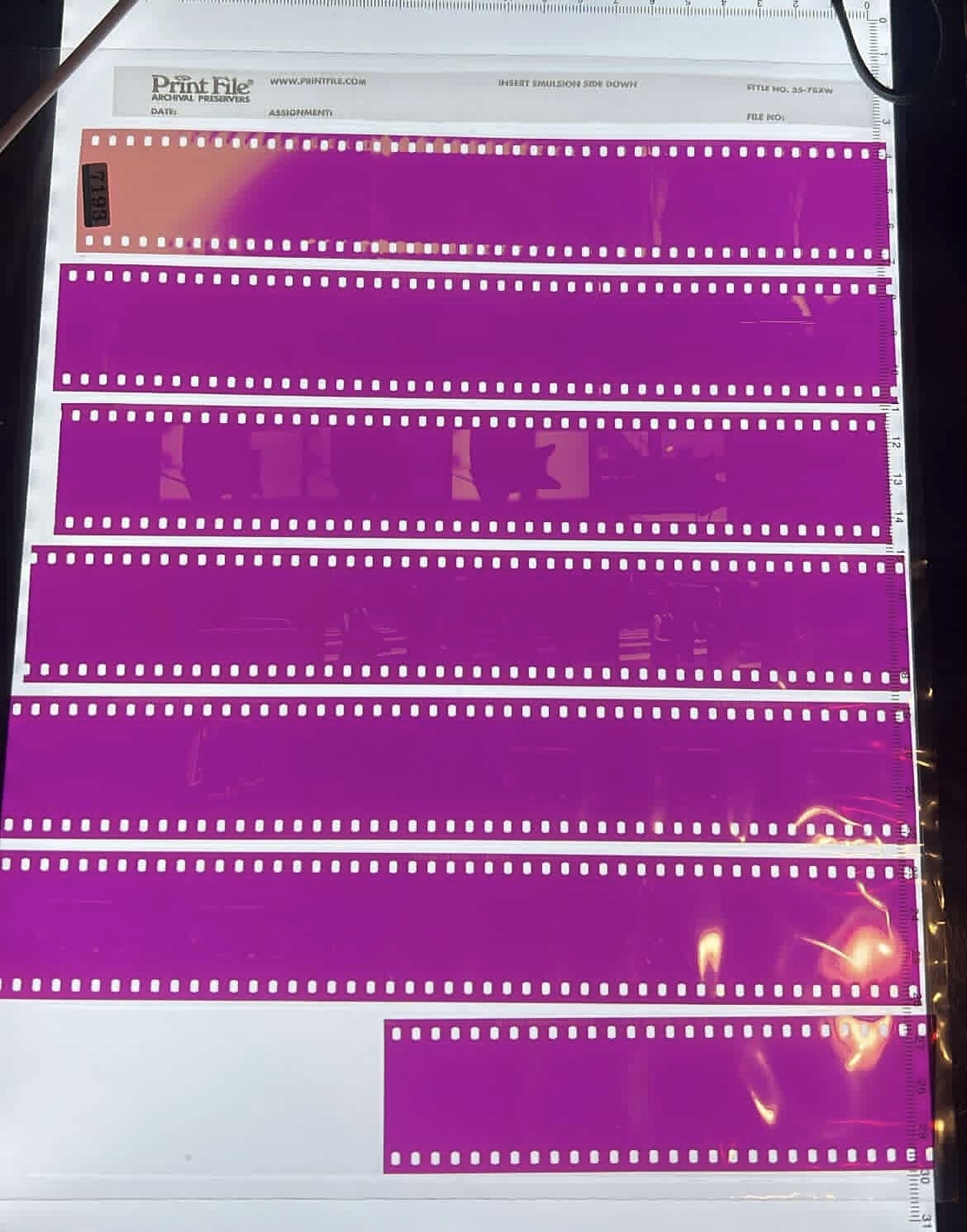

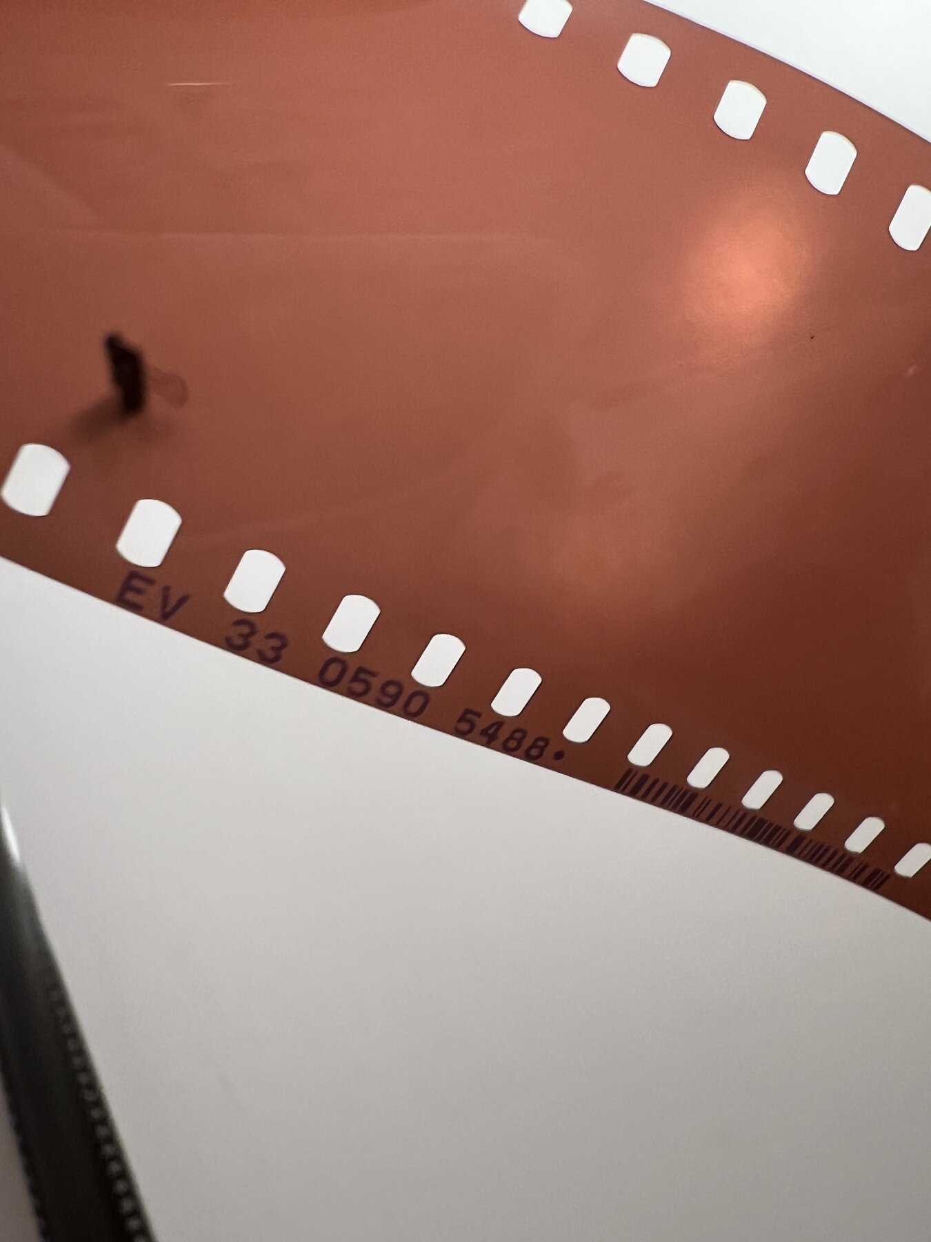

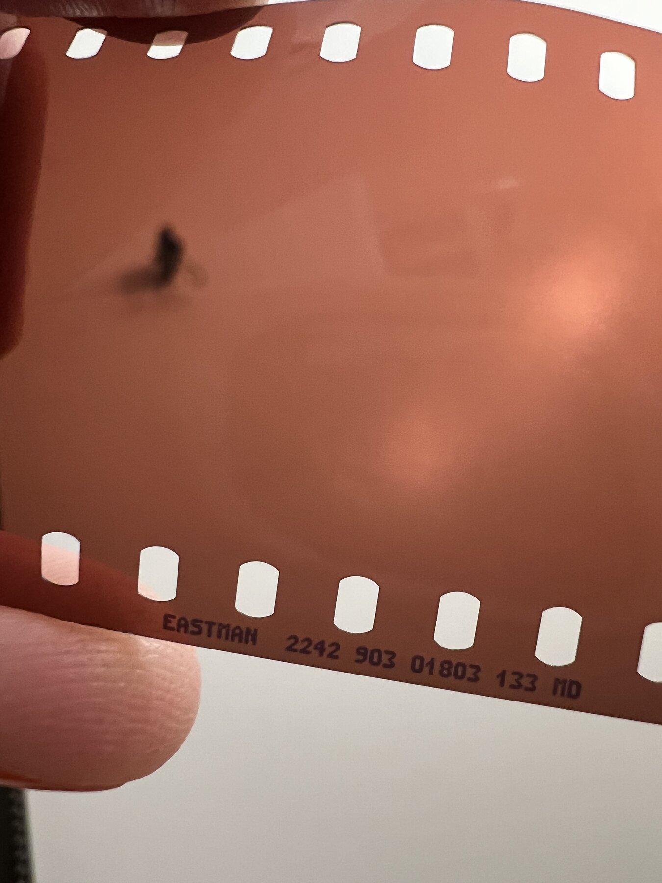

I was recently gifted a good length of expired Kodak Eastman 2242 35mm film.
There isn’t much info about this stock online, so shooting and processing it was done with a bit of guesswork.

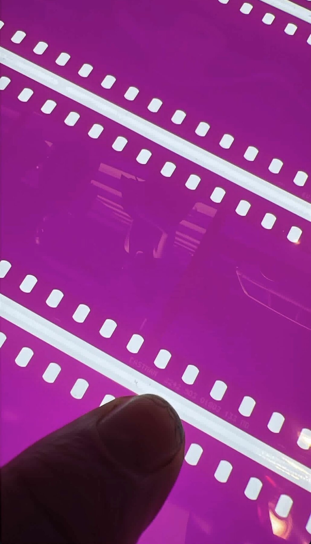

My friend processed it with E6 chemicals and got very pink, results, almost nothing showed:
Yesterday I processed my test roll in C41, without much results either (probably only 1 picture in the whole roll was visible):
Both were shot at 50 - 100 iso.
Is there a way to "extract" more results out of this film stock?

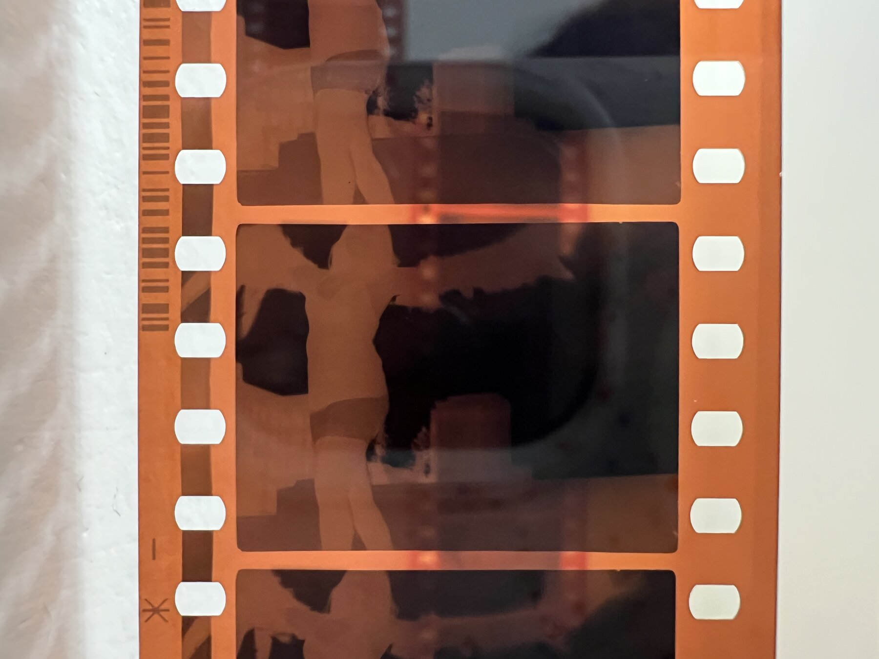

I got lucky yesterday.
At first I tried processing a roll shot with SLR using somewhat old CineStill C41 chemicals for 12 minutes, but that didn't reveal much unfortunately,
I got more lucky processing the 2242 in Rodinal, with 40ml + 960ml (1+25), for 7 minutes, variation on this chart.
The shot was motion picture film shot at around 1/60 of a second.
Lost the color, but since I'm mostly shooting motion film with it, it's giving me hope that I can use it for something decent!
I'm not sure if it's worth keeping on experimenting with color chemicals with this film stock, and I'm not sure why the difference was so stark between the 12 minute C41 bath and the 7 minute Rodinal bath. Obviously one bath was stronger but I thought the extended duration would make up for it.
