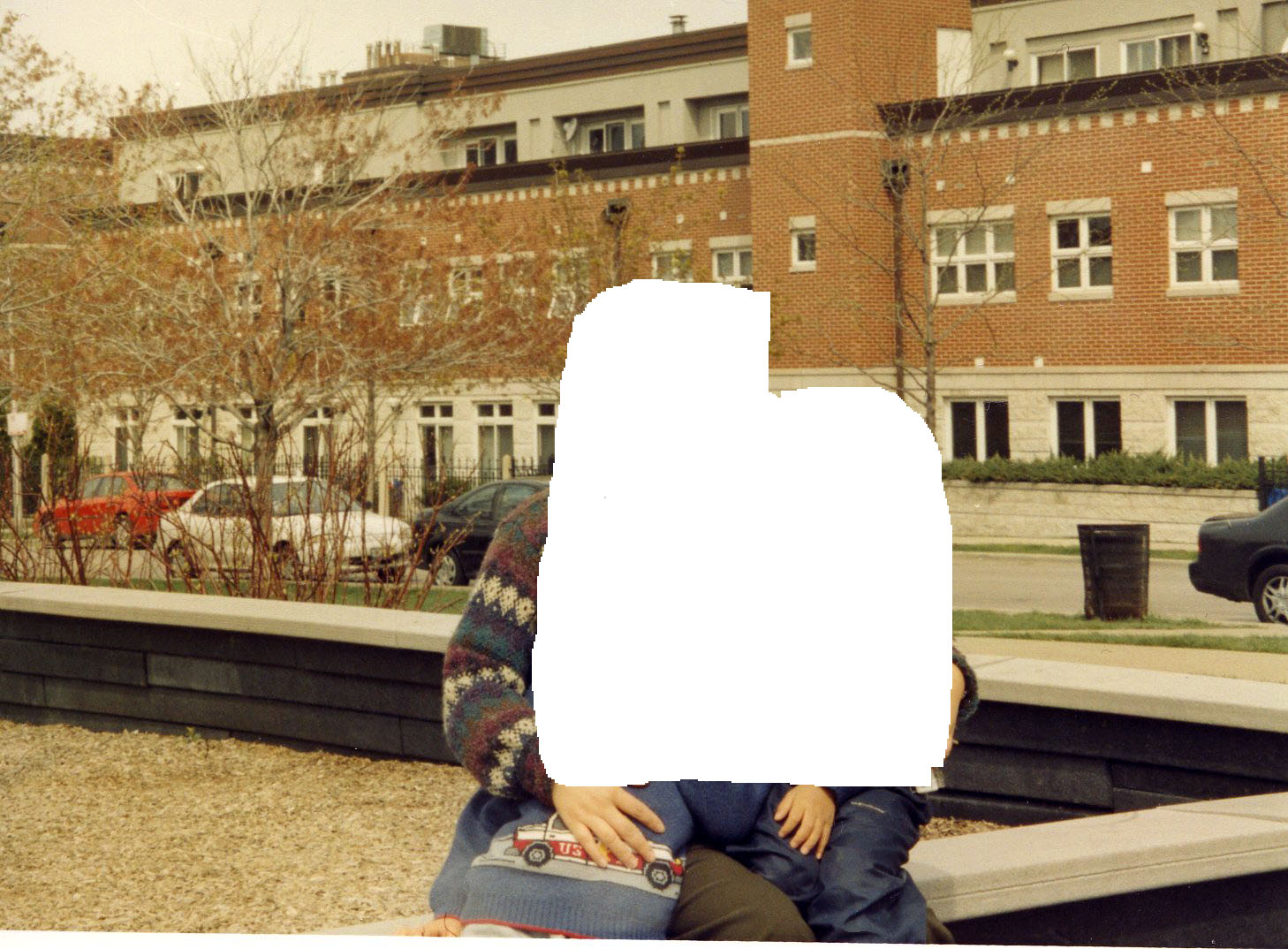

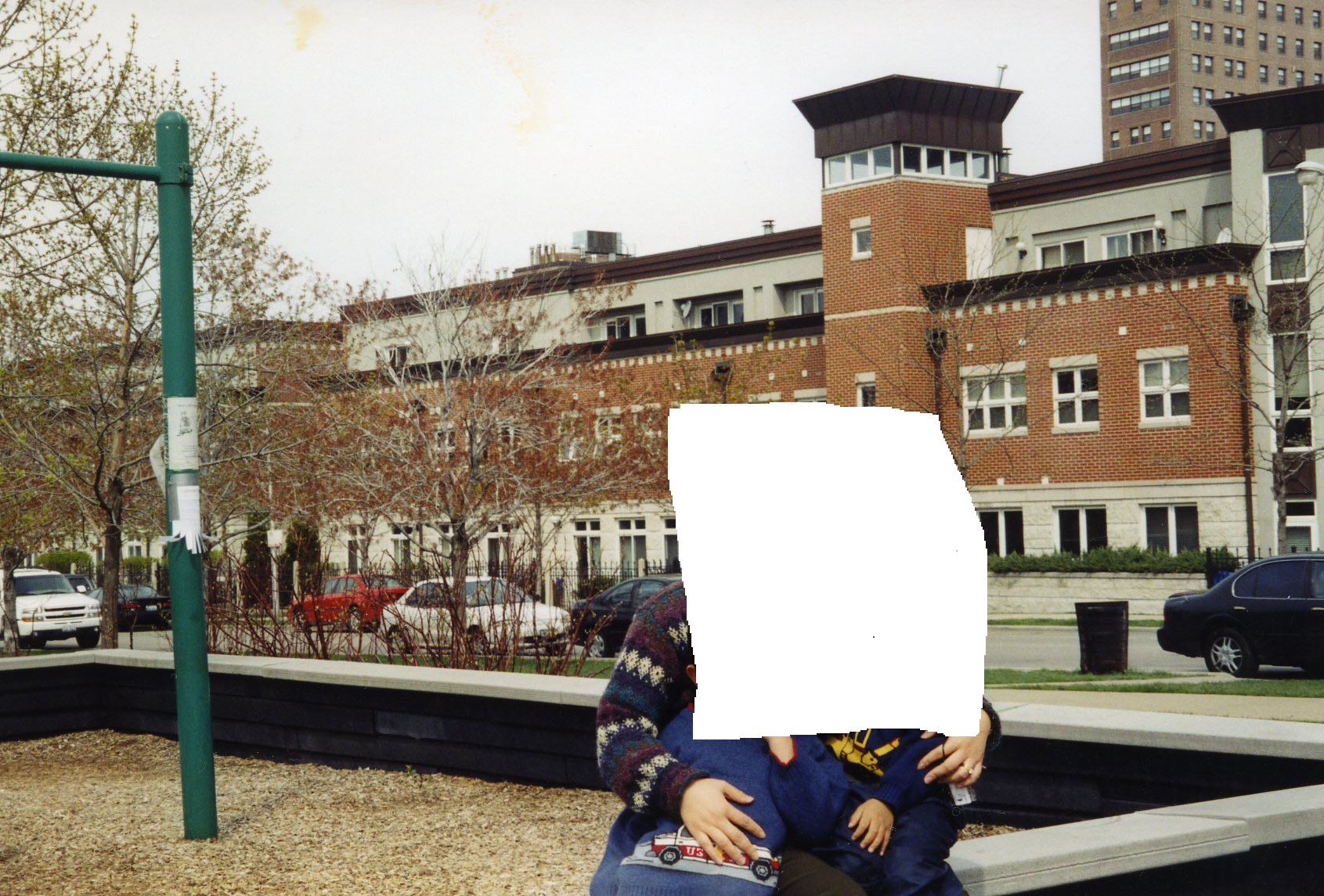

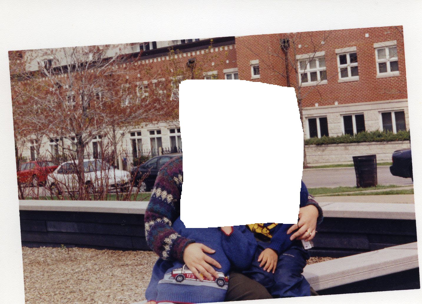

Below are the test print scanned using Epson v700 with dust removal.
img006.jpg img006autocolor.jpg img006autoContrast.jpg img006autoTone.jpg img006autoAll.jpg
First one is original, color is off
2nd one is after Photoshop auto color
3rd one is after Photoshop autoContrast
4th one is after Photoship autoTone
Last one is after all Photoshop auto adjustments
Clearly the color balance is off. Probably it is on the Cyan side. I do not see a lot of changes on the contrast and tone changes.
How do I know the auto adjustments made in Photoshop? Judging by the print after autocolor, the paper looks good. It brings back the vividness.
For comparison, I attached two other photos, one is the original shop print, the other one is my previous test print with Super C paper:
The super C test print is a little red or magenta. But it still acceptable.
What do you think of the color balance I should make on both the PIII and Super C papers? Are the densities ok?

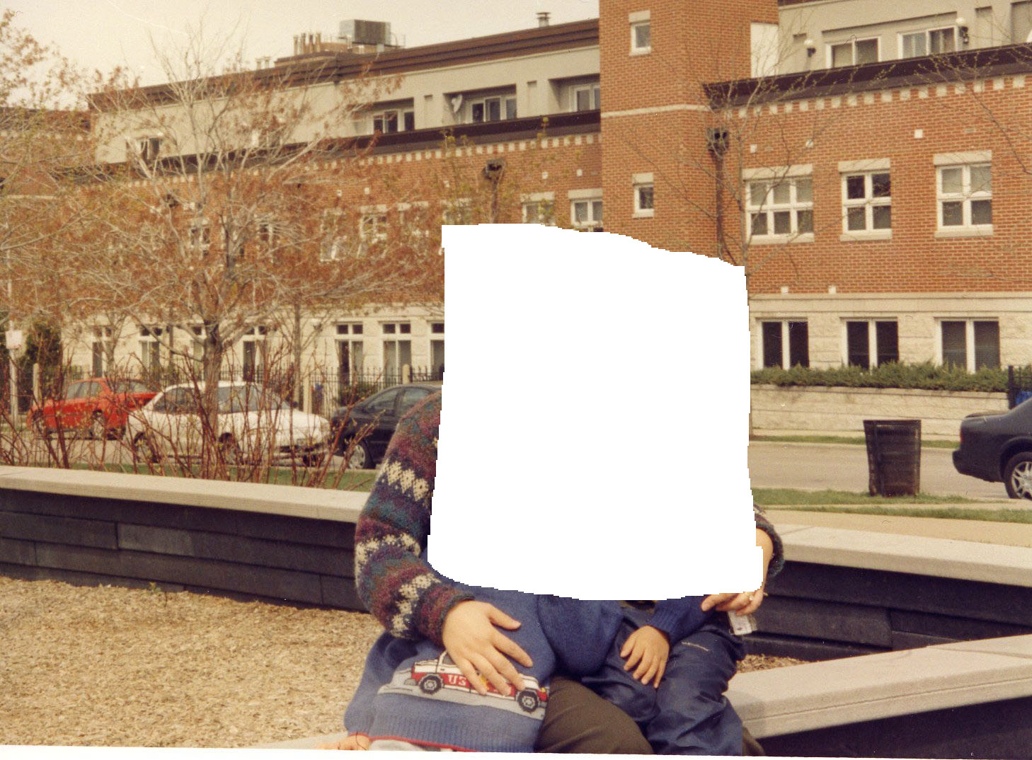

I scanned the color print into Photoshop and played with its color balance tool. I made the auto color adjustment and matched it with my own color adjustments. The auto color balance (change) is -50M and -10Y. This is such a large change and the Kodak viewing filter won't do it. Well a good eye(s) can catch this pretty quickly.
Here is the photo after Photoshop color change:
I'll make some changes with my filters to see this makes the print better.
Prof_Pixel
Feb 17, 2012
1,917
Penfield, NY
For a 'quick and dirty' starting point in color printing, look for some medium density gray area in the image - like the ledge they are sitting on. Notice that in your original shop print it's pretty neutral. None of your other prints come close to being this neutral.
