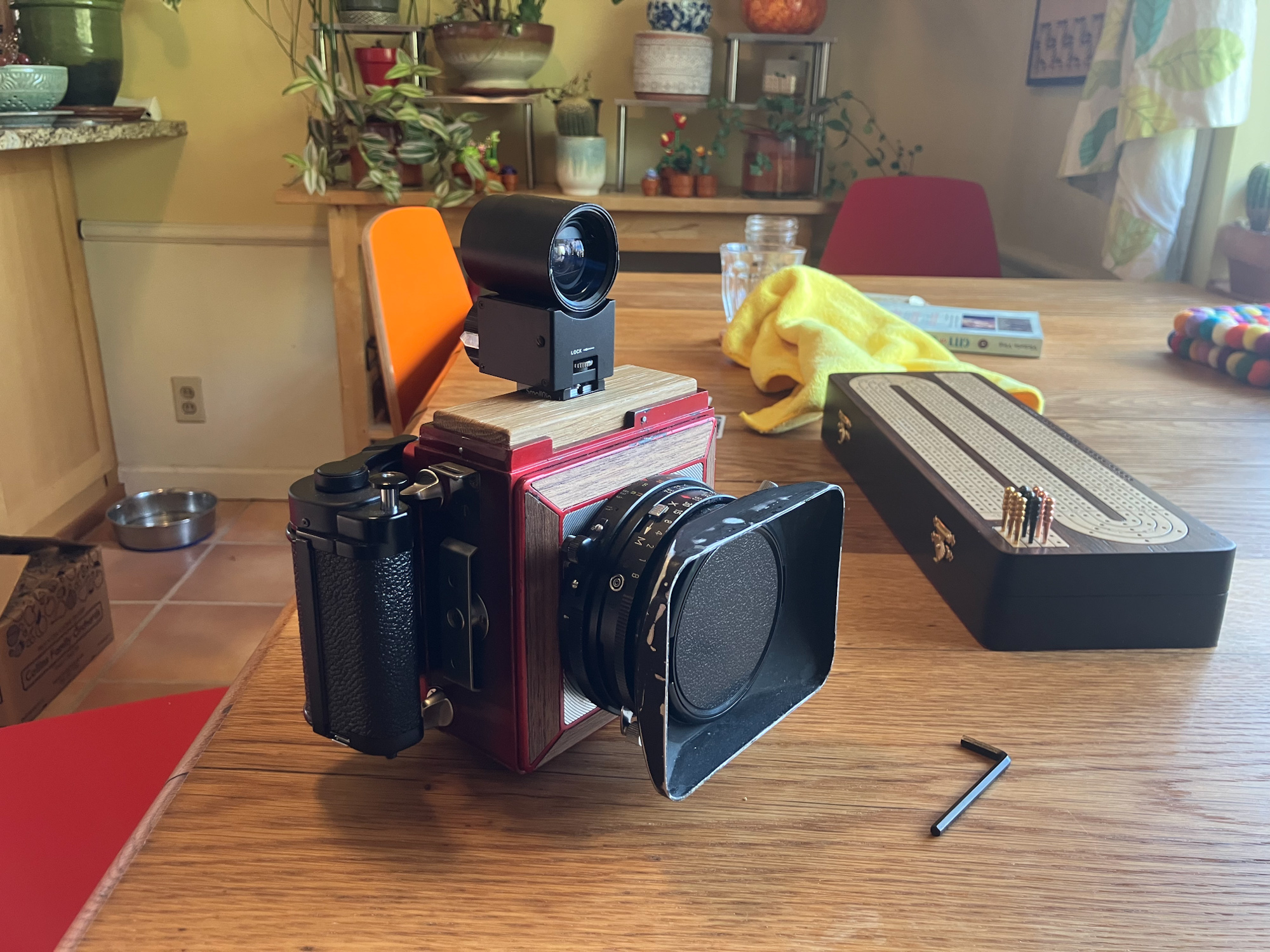

I stripped the top off a junker original press body and used it this summer as a fun zone focus camera with 50mm.
Pretty fun if you like the press lenses and backs but were looking for something a bit more portable. Swapping the 50 for the 90 and the accessory viewfinder for the sports finder drops the weight a substantial amount more.
Very cool pink Standard you've got there. How are your wrists?, those 50mm lenses weigh a ton.
