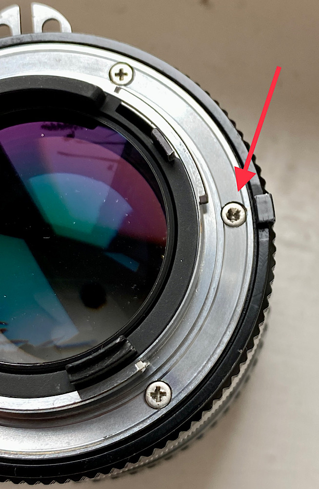

Stuck screws that cannot be removed from their threads are one of the biggest annoyances when repairing photographic equipment. Because you either damage the screw heads when trying to unscrew with force or you have to cancel the repair project.
Screwhead damaged by force 🤬
How can you tame such stubborn screws?
Phillips (cross-head) screws in older Japanese devices are almost always JIS standard screws. You should definitely get suitable JIS screwdrivers that do not overtighten the screw heads.
When loosening stuck screws that are secured with adhesive - like bayonet screws in Nikkor lenses - heating, for example with a soldering tip, has proven to be a good solution. The heat loosens the adhesive.
It is also recommended to loosen rusted screws using a screwdriver and hammer.
If the screw head is so damaged that the screwdriver no longer grips, a slot can be milled so that a slotted screwdriver can hold again.
Screws can also be drilled out, which is very difficult with the small screws in photographic devices.

The first thing I do in these situations is not try too much. Too much trying destroys screw heads. If first attempt is difficult, then a bit of penetrating oil or heat. Never a second attempt with more muscle.
  • If the lens mount is metal, a drop of acetone, wait a few seconds and try.
  • If the lens mount is plastic, a drop of alcohol, wait a few second and try.
  • Briefly touch the head of a hot soldering iron to the screw and attempt to remove immediately.
  • Shock the screw by lightly tapping on the center of the head with a flat punch and a tiny hammer: Do not repeat more than once and attempt removing in between.
  • Stripped screw heads: Rotary hobby tool with thin cut-off disc to make new slots.
