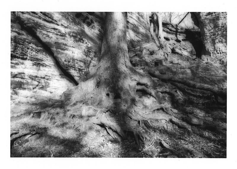

I like this look which I believe is created in the enlarging stage and I see a different photographers utilising.
It's almost like a soft filter (but I know that these images did not use an on-camera soft filter) and was told it was done in the dark room.
Can anyone explain or point me towards resources (or the correct term) for this effect? Thanks!

Stocking stretched over a frame, cellophane and hazy lenses wide open have worked for me.

Funny these look just like the images from my Summar that has most of the internal black paint missing and hazy rear element. So I would think the effect is a combination of diffusion and/or scatter, like thin nylon over the lens

Mike, what makes you think this effect was achieved at the printing stage and not already at taking?

You can make your own adjustable filter. Two pieces of 1/4 inch glass (tape the edges so you don't get cut) and place a small amount of baby oil between them. You can control the amount and rotate them over each other to get the desired amount of diffusion. Focus to have a sharp image the hold the "filter" under the enlarging lens and move it around until you see what you want. This way you preserve your well focused negative and can have as much diffusion as you want.

@AgX if you use a diffusing filter on the camera, it spreads the highlights, giving a light glow to an image. Using a diffusing filter beneath your enlarging lens spreads the shadows, giving the effect seen above in Mr. Chalners' examples.
I've read a post from Mr. Bob Carnie stating that using a diffusing filter whilst enlarging during use of a very low contrast (00,0,½) filter will spread the highlights, whilst doing so during use of a high contrast filter (4,5) will show the above effect. I haven't tried that for myself, but I can definitely confirm the effect a diffusing filter has during 'normal, non-split' enlarging.

One thing I did think about was exposing for part of the time slightly unfocussed (and mostly properly focussed) - anyone have any thoughts or experience on this?

I've done a bit of research but in this instance I asked the photographer at what stage it was achieved. Also, I own a few diffusion filters like Black Pro Mist etc. so have a bit of an understanding of the effects of filters at shooting stage.
Yes, highlight spread is the effect of a foggy rear element, whereas the images above have shadow spread. nice insight.

It's a standard filter you screw to front of your camera lens. It comes in different sizes and strengths. It softens highlights and is meant to soften skin without losing skin tone, but is meant to look a little dreamy.
Which would give a very different result than the examples. Those examples have shadows migrating into the highlights, rather than the reverse. The query about the filter name was probably inspired by the fact that "Black" is part of the name.

Single layer of stocking, multiple layers, different weaves, different colors, ... just for starters.

here are two examples of using the home made diffuser I mentioned above. It was used under the enlarger lens. These are phone photos of the prints which are too large to fit my scanner.

I don't have a picture. It's just two thick square pieces of glass 6 inches x 6 inches with black tape covering the sharp edges. Put a small amount of baby oil between them. You can rotate them over each other after previously sharp focusing. Hold the "sandwich" under the lens. Once you like what you see, make a test print as usual. Note the position the glass was in relation to the enlarging lens to make the final prints. It's cheap, easy and will last. I made mine 40 years ago. Just change the oil from time to time.

This is an example using some cellophane under the enlarger lens.

This is an example zooming the enlarger lens during exposure, which is a different effect than zooming the camera lens.

Printing stage, there is the stockings trick.
Also, you can defocus your lens for 1/2 the printing time. This will create a sharp and yet soft print. The more you defocus, the more diffuse the look.
Obviously, there is a difference in the look wether you defocus in front or back.
