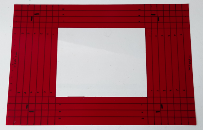

For aligning negative + paper I use masks cut from Rubylith; I cut an opening in the red film to the size of the negative (e.g. 4x5 with or without rebate), then draw lines spaced at 1cm along all edges, radiating outward from the negative. This allows for easy centering of the paper/substrate over the negative without having to actually see the negative.
A handful of these masks cover my needs and they last pretty much forever. I've been using this approach for years.
