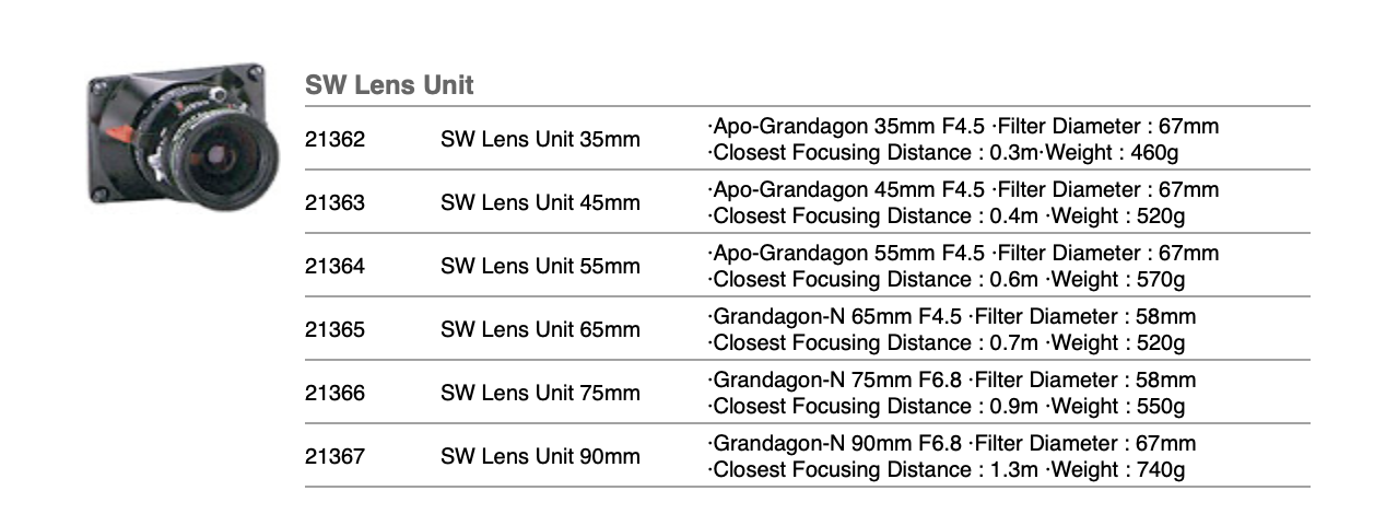

I looked through all my Horseman literature and I only have information on the 6x9 camera. In that case it appears the lenses all came already on the cone, forming a 'lens unit.'

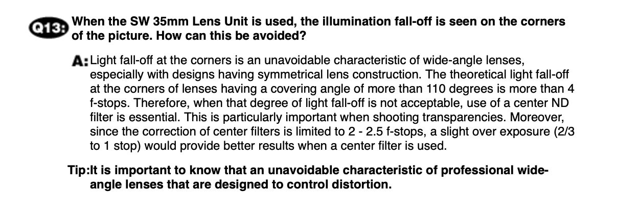

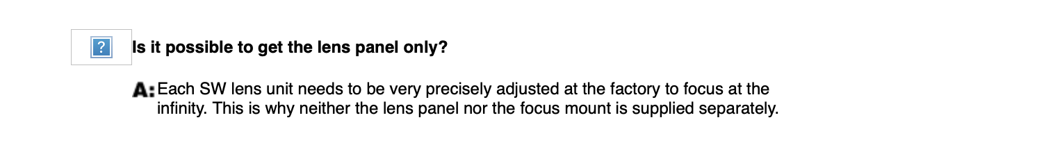

There was a FAQ for these cameras with the following information about vignetting and availability of the lensboards individually.

ic-racer: the 135 Apo-Sironar-S was indeed offered on a cone-with-helical for the SW612 cameras - it was Horseman catalog number 510017. Now discontinued, alas.

Yes, the lens came on the lens cone from the manufacturer. It is not a third-party cone. All of the stock lenses for the 612 were produced in versions supplied with the cone/lensboard with focus helicoid. The 135mm was the longest lens offered.
