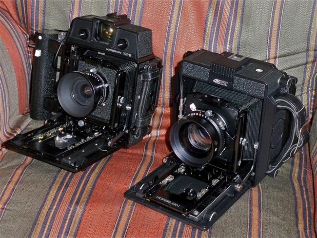

I got my Horseman FA instead of getting the 4x5 extension back for my Horseman VH-R 6x9cm camera. The front standard on both cameras is the same, so I did not need to learn anything new moving to the FA. Over ten years later the FA is still my main and only 4x5 camera. It works best within the imitation of its own lenses. For example the Topcor 90 might be the only f5.6 90mm that will fit the camera. And the 210 takes the special "C-1" lensboard. And the 150 mounts with a special retaining ring that accepts the 300mm Converter.
I did manage to acquire all the lenses for it over the years:
90mm 5.6 Topcor
150mm 5.6 Topcor
180 5.6 Topcor
210 5.6 Topcor
300mm Converter for the 150mm
