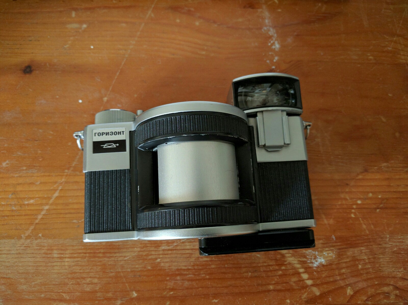

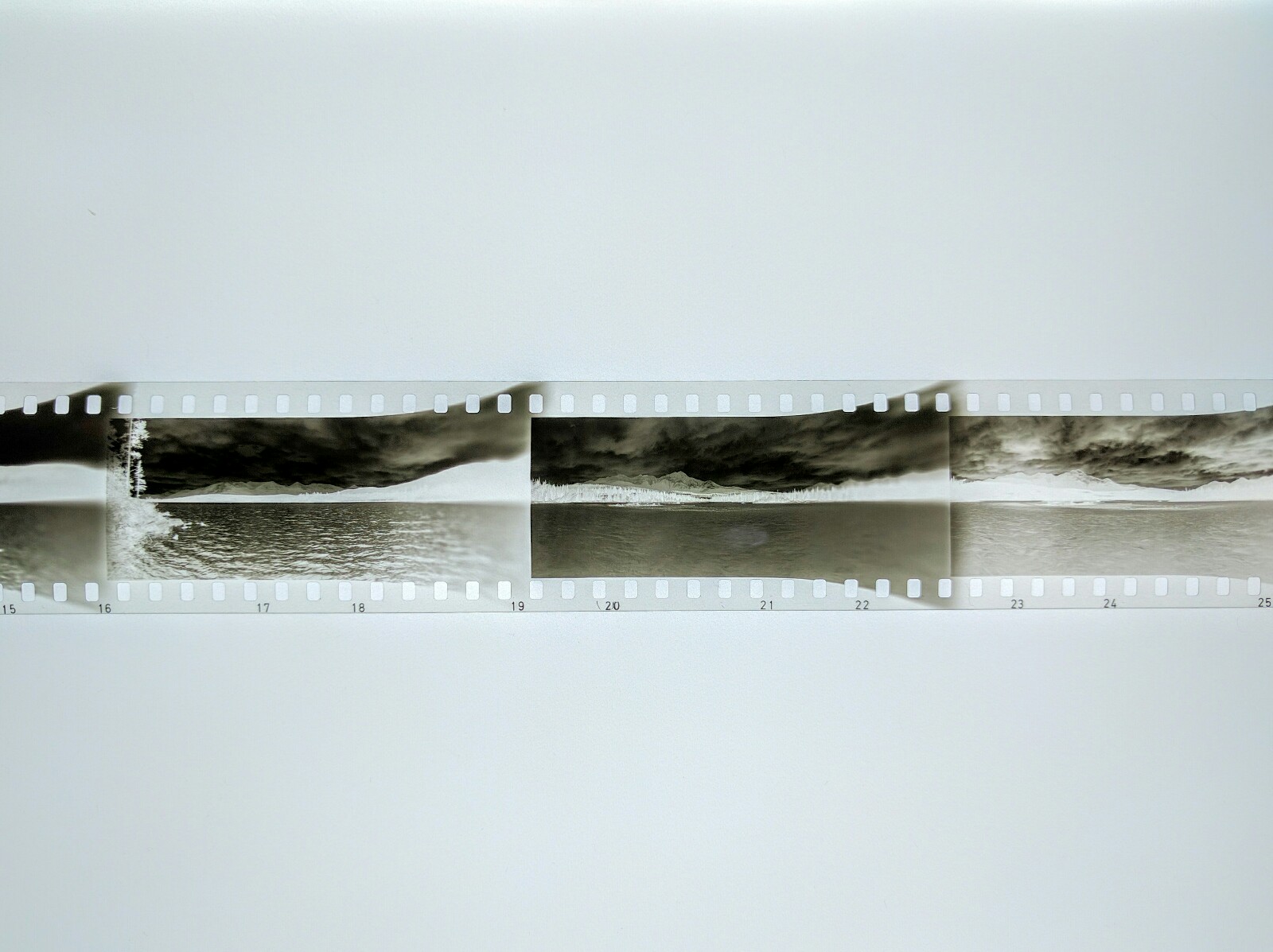

Hope someone can shed some light on this. I've been shooting a Horizont swing lens camera for a few years and have had it cla'd and seals replaced not so long ago; it's been fine until very recently. I just developed the last two rolls that have been through it and discovered this bizarre artifact on every frame as if the film is lifting away from the film plane at the end of the lens circuit. Here are a couple photos of the negatives and the camera.
Any insight is much appreciated.
Thanks,
Matt
You gave the best explanation for this artefact yourself:
Film being "loose" at one side of the frame.
I don't know whether such is technically possible, but it completely explains the artefact.
I suppose that's possible, even likely, though I have been loading by the same method without trouble for several years. I'm trying to visualize how this would recur precisely in every frame and can't see it.
Well, I just loaded a new roll and immediately realized I'd neglected to go under the first bar on the last roll. I suppose pulling the film across the back has become automatic since I've started shooting more 35mm cameras.
Thanks for sorting me out gentlemen,
Matt
You did not load film properly. Just follow picture attached to inside of the film chamber.
