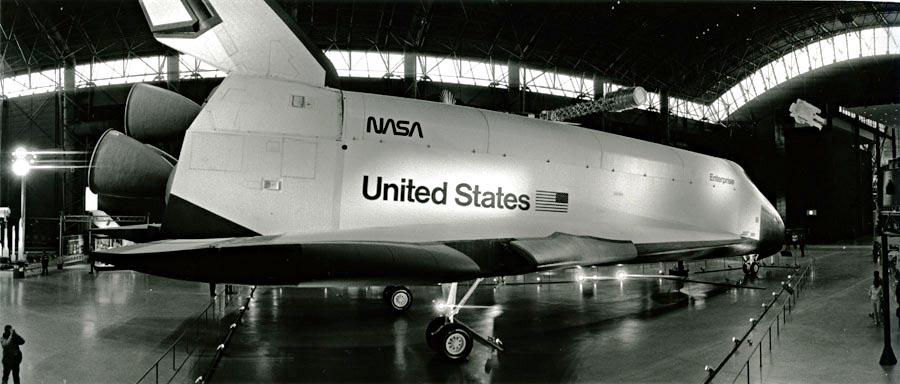

I print on 16x20 paper cut in half for 8x20. You'll be fine.
