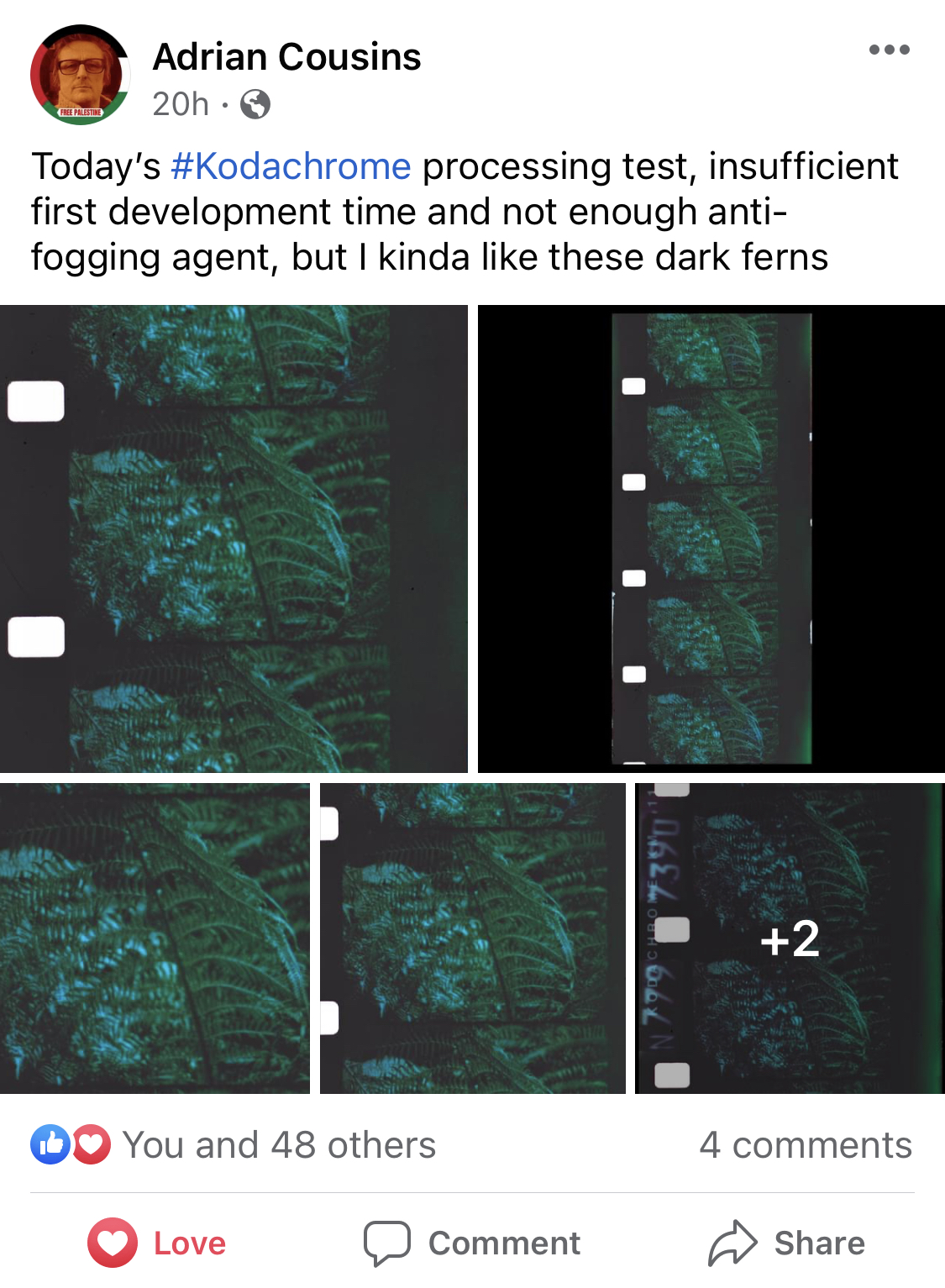

I highly recommend talking with Adrian Cousins because his experiments continue with the available color couplers and dyes plus he’s dealing with having to add restrainer to the first developer since the available Kodachrome is aging.
He gets beautiful artistic muted colors from Kodachrome but not the accurate colors that the process was famous for in its heyday.

he actually processes Kodachrome in color?
Yes, he processes Kodachrome in color. Note: it’s for himself - he does not offer processing as a service to others.
