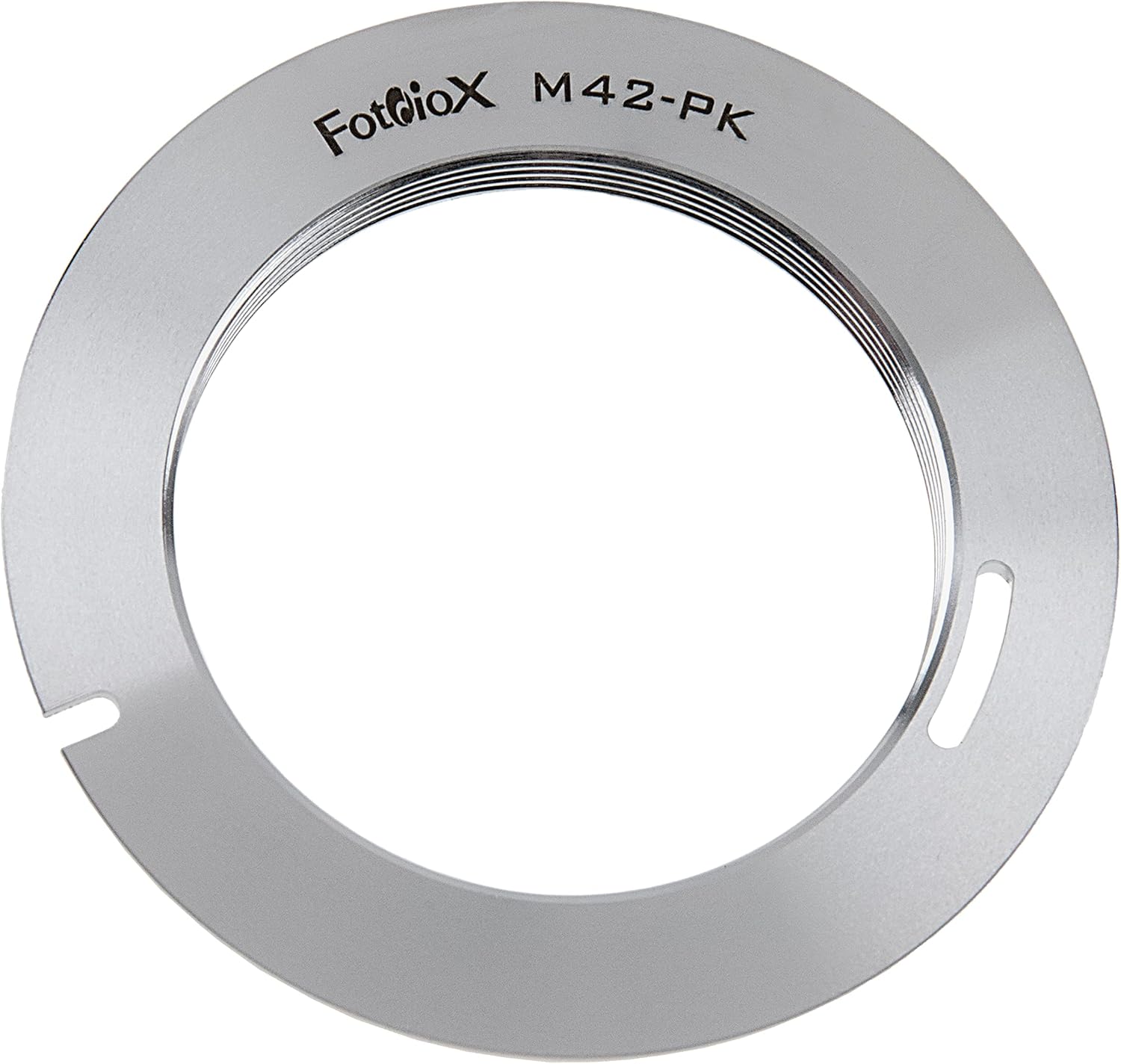

I received a Honeywell Pentax from a friend the other day, and it works. The issue is the mirror gets locked up most of the time. It has two lenses with it, but they are the screw on mount. I have a friend with the Pentax K1000 I was thinking of gifting the two lenses to her.
My question is, what adaptor would she need to use these lenses, or is that even worth it? I tried googling, but am unsure which adapter would be best. The costs were all over the place from $12-$100.
Thank you
It's an M42 lens to a Pentax K-Mount adapter. They're pretty common, Pentax made one for the K1000 originally. Keep in mind that you will not have open aperture metering, nor auto-diaphragming with these lenses on the K1000 since it has nothing to trip the stop down pin on the back of the lens mount. The lenses you have would need to have an auto-manual switch to be used at anything other than wide open.

I think the lower cost adapters will work just as well as the more expensive. Have a Pentax M42 to K, just machined metal, the following is $14 on Amazon and looks to be same as the Pentax branded
Fotodiox Pro Lens Mount Adapter - M42 Screw Mount SLR Lens to Pentax K (PK) Mount​
Thank you Paul, That is good to know! It's hard to tell these days what is cheap and what is real.
Generally, this type of adapter will not allow infinity focus with the M42 lenses, it is too thick. The adapters that fit inside the PK mount, flush with the surface will allow infinity focus with many M42 lenses. They are the ones you want.
