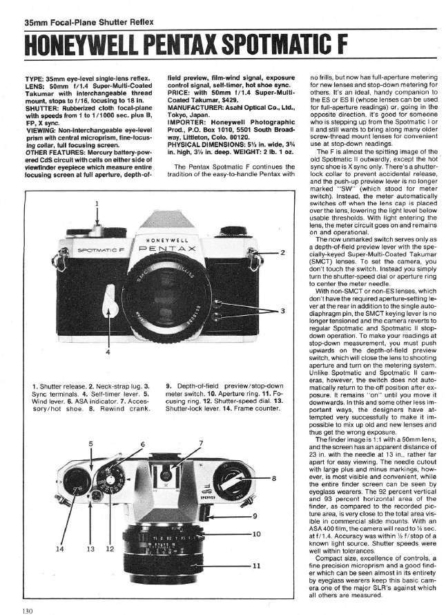

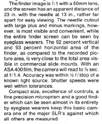

Well, I admit to being a bit skeptical, so I pulled the 1974 Modern Photography review of the Spotmatic F. Their figures on viewfinder coverage contradict your assertion, quoting 92% vertical and 93% horizontal coverage versus 85%. They also make no mention of any offset. Their overall conclusions at the end also seem less disparaging.

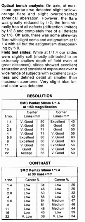

Also, the January 1981 Modern photography test of the SMC Pentax 50mm f/1.4. Again, I would argue, a lot less disparaging.

Upon reviewing the thread i noticed that the lens chart posted was for a 1981 SMC Pentax. So that means that the 1973 or 74 chart I remembered for the SMC Takumar may indeed possibly be correct. Although for the purpose of the original posters jam complaint on his pre-Spotmatic camera it's really off topic. But early on, I suppose he's satisfied with the replies on that subject. Yes, ALL of these models are mechanically identical and ALL of them sooner or later developed the jam issue. As an aside, when Honeywell adopted the "Spotmatic" name, it inferred the in-camera meter was a spot meter, when it was actually averaging. So there's no rhyme or reason as to why they chose "Spotmatic".
