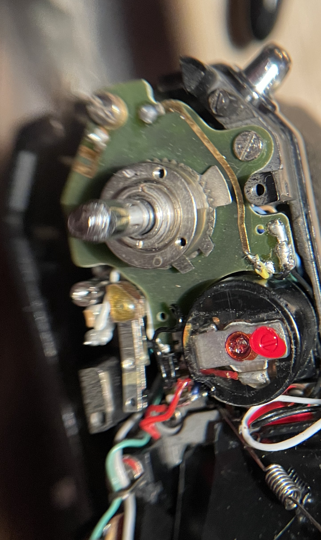

Looks like I spotted the point that was broken. I touched two points on the CdS circuit board and they respond to light. Then I touched one point on the board and one on ground and the multimeter did not respond to light.
Then I touched the place where body and board meet and it moved!
Soldered it, now speeds all over 1000 but my guess is previous repair failed to diagnose, adjusted it like nuts and gave up.
Will swap in my circuit board to see if speeds fall in range before going further. But this broken junction might have been it.

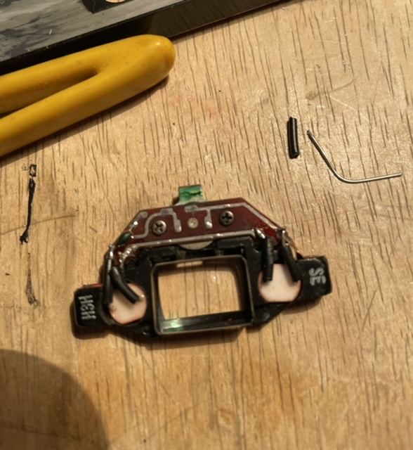

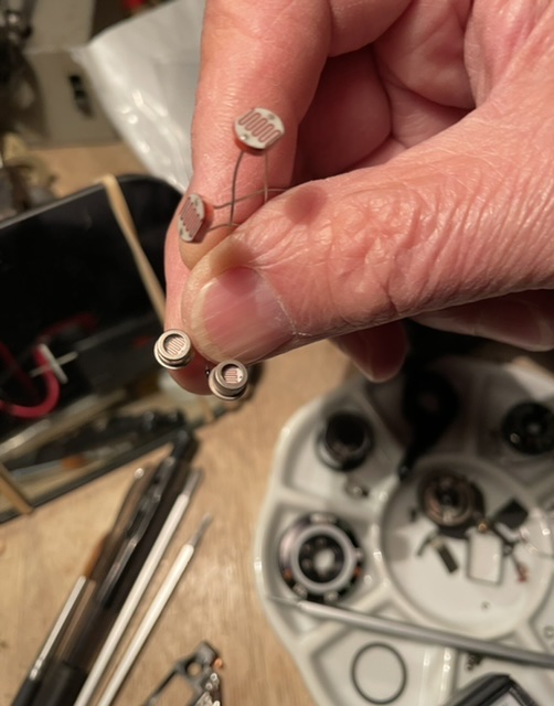

CdS were indeed bad, metering 6 and 10 ohms in the dark. Lucky for me I bought a bag of assorted CdS from Radio Shack before they went under.
I have replaced them and initial test shows I can get full range of shutter speeds by dialing the light up and down. So it will calibrate! I made a rookie mistake routing the leads, I should have gone to the notch. The insulation will be against the upper case pressing against a lead. I don’t like it but it will close.
I left the seal replacement work to the end so there is that work ahead of me.
But to sum it up. The connector to the CdS was broken, the mirror return was stuck, the shutter switch was cracked, and the CdS were bad.

Hi @flavio81 I’m certain the properties of the substitute CdS are wildly different enough from factory CdS that the few ohms adjustments available on board are not enough.
Considering dropping in a few variable resistors of my own.

Try sourcing the CdS cells from a Spotmatic F or K1000.
Well I picked up another ESII, has a different ( type III ) board. Also same issue with CdS cells (about 4K ohms with little response to light).
These Japanese 20 dollar ESII must come from the factory returns bin.
I’ll keep an eye out for Spotmatic F’s
The first ESII is still kicking my butt.
Sure learned a lot.
I have put 0.6 ND filters over the cells which are larger than original so they were too sensitive.

All because the CdS were bad and I tried replacing yhem with what I had on hand.

The trick is to clean the contacts. When I was getting unreliable speeds I found two places where contact was inefficient. The eyepiece (CdS to ground) was finger tight. That was my fault. The next place I cleaned was the lower body capacitor section.
At first I suspected bad capacitor and started to remove the unit. Then, seeing it was sealed, I put it back. But I cleaned the contact under one of the screws, and cleaned the screw itself.
I think cleaning contact points is pretty important.

Ack this happened before. Soon as I take off the top, the “bad one” works. I’ll be looking for a short somewhere between the upper deck and the top. Maybe I will address the low light non-linearity.
As mentioned the issue was reproducible, it followed putting the top on, and went away with the top off. Solder connection on the right. I loosened the two silver screws and twisted the circuit board clockwise to move that solder away from where it probably touched. Filed the edge because solder went to the edge of the board. Problem positively went away.
