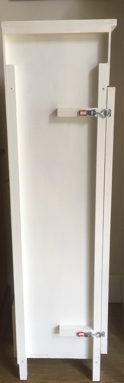

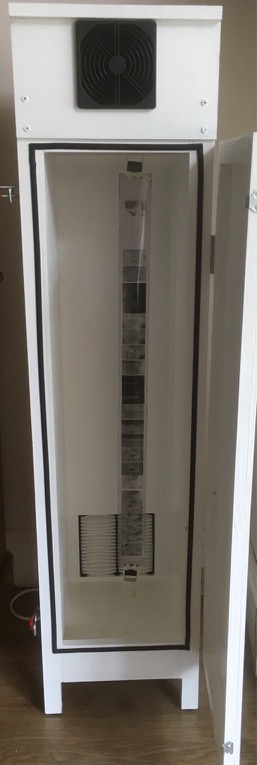

I thought I'd show my recently completed drying cabinet, in case anyone is looking for ideas.
It's basically four slabs of thin MDF glued and screwed to four lengths of 30mm square PSE. The MDF only cost me £4 as it was some offcuts at B&Q's giant panel saw.
There is a USB PC fan at the top front which draws air in through the filter at the bottom rear. The filter is from a Daewoo Getz, chosen because it had dimensions listed on eBay.
A length of draught excluder around the opening and a couple of adjustable tension catches ensure that the door is sealed and air only enters through the filter. So far (after 12 films) it seems to be doing a decent job of drying without any dust sticking to the emulsion. That's quite a miracle as I have a hairy dog and live near a main road.
Total cost is about £30.
It's only tall enough for 120 film but as that's all I use it's not a problem.

Only thing I could suggest as an addition is to put an incandescent light bulb near the bottom (and shielded from water dripping down to it) , to generate some heat which aids in drying negatives or prints faster

Does it not need some kind of a heat source?
Dec 23, 2021
19
Dartmoor
I can confirm that it dries a film within a few hours as it is.
My house is well-insulated and maintains a fairly steady temperature of around 18-20º C all year round.

I built my. Dying cabinet in 2001 without additional heat. Never any issues.
Typically it is advised to let instead the air stream downwards to pick up less dust. Im an not sure if this would be an issue even without a filter. Unless a smooth floor has not been wiped for ages and one is going around the dryer during operation. Anyway, if necessary one just could flip the fan...
