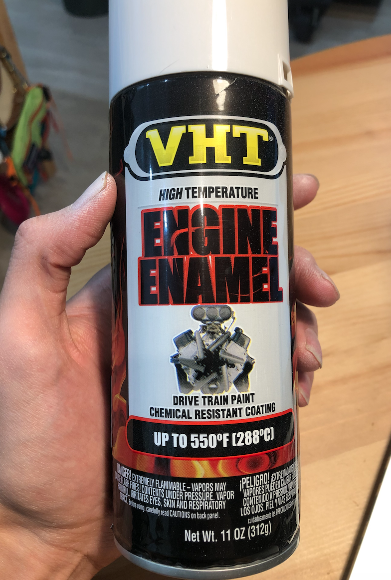

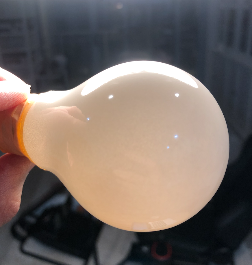

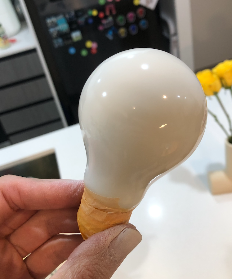

Since the purchased bulbs had issues(https://www.photrio.com/forum/threads/dr-fischer-bulb-quality-is-doubtful.210737/#post-2853544), I attempted to make these bulbs myself. Here are my attempts. I will conduct uniformity tests over the weekend after the paint has dried completely.

This approach might work fine -- I assume you are using a standard household light bulb. You don't say -- but if there is an inscription on the top of the bulb, it still might show through.
I don't quite under stand your problem, however. The original problem might have been a bad bulb or your enlarger or how they were used together. If there is a problem other than the bulb, your new approach might not solve the "problem". Some enlarger heads allow you to position the bulb. Does yours?

Even though the paint is white, it has some opacity. If the paint thickness isn't even all around, you might end up with some hot spots.

the result should be better than original one

I try to use high temp paint
Right, I get that. I see that it's VHT Engine Enamel, which has a minimum 20-min. @ 200°F cure - if not slightly longer and hotter, in my opinion - so I was just curious if you were going to suspend it and bake it, or just turn it on and let it cook for awhile, or what.

There is some possibility the bulb will crack if left on too long. Your paint may constrict uniform expansion as the temperature rises, if it's expansion rate is different than the glass. It may also just flake off. But it'll likely be fine. Good luck.
you are right, The smell becomes very unpleasant when the temperature rises, I stop test
