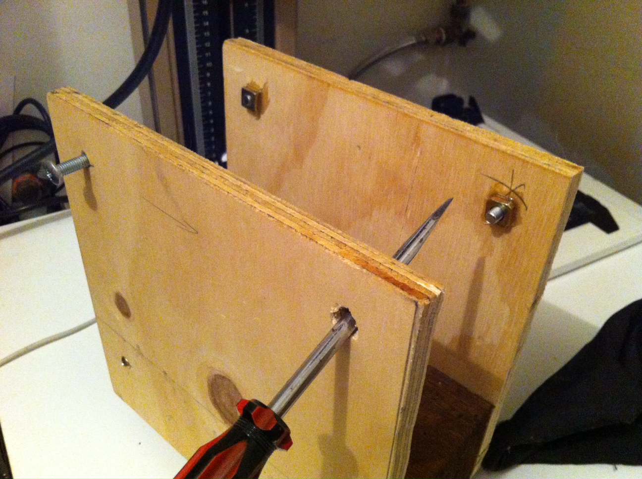

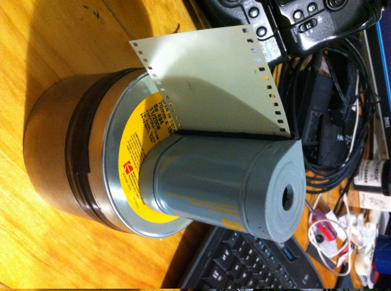

I've been looking for a 70mm loader on eBay for a while and I refuse to pay the $250 that these things seem to sell for so I hacked one up out of a couple bits of wood and M6 bolts this evening. The bolts screw in/out to support the two spools and the big screwdriver is how you turn the takeup spool. Obviously this is not a daylight loader :wink:
One puzzle I did have is that once the spool was loaded (I went to about 0.5mm smaller than the spool flanges) and installed in the cassette, it did a big unwinding inside the cassette after about a minute. I suspect that means the back of the film will be dragging on the inside of the cassette, so I hope I don't get any problems with scratches.

Nice, I do the same thing. Load the film in my darkroom. I gave up trying to buy a loader a long time ago. Can't believe how rare and expensive they are.

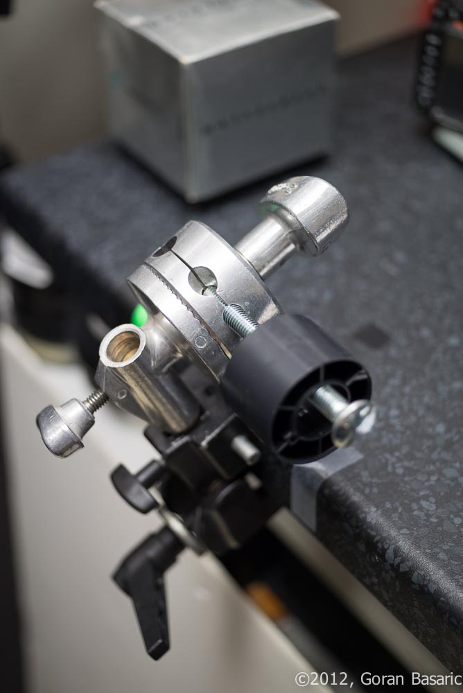

Gorbas: I can see a bolt supporting a core there - is that where your source spool goes? Does anything else support the cassette spool or do you just hand-hold that?
I'm loading cassettes into the back in the daylight and assuming the felt traps work OK. The Mamiya back requires you to wind on two frames after closing the back before it reaches "1" on the counter, so that will pull enough fresh film from the spool. While I could no doubt load in the dark and get two more frames, I don't know the back well enough to do that yet and it's fiddlier than a 120 back. The whole bottom comes off in order to insert the cassettes, and it has to go back on quite precisely.

Hi Polyglot, On my picture, plastic core is only for illustration, since my 70mm reel still lives in the dark. You are right, the bolt is holding my film reel. I'm holding film spool in my hands and just roll it. On the end I insert spool into cassette.
I loaded Double-X Aerographic film 2405 to film back on the room light and had severe light leaks. From now on I'm doing it in total darkness. 2405 is with "ivory" colour backing and transmitted light a lot. I'm cinematographer by training and dealt a lot with daylight loading of 16mm film on 100' rolls and never seen such leaks. Yes, with Hasselblad back you also had to wind a few frames after loading the 70mm back. When I reached the end of film i unloaded it from the magazine and had light leaks from that end too. One fine lesson in handling 70mm film! Just rolled 2 cassettes today and loaded one all the way to magazine in the dark.

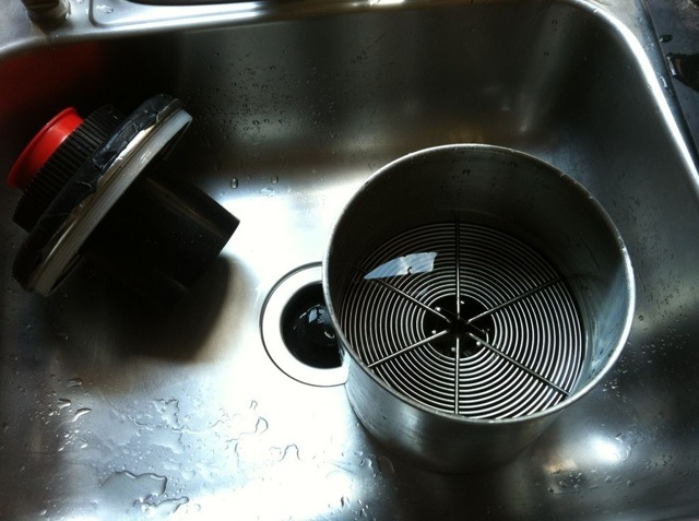

Thanks, some kind of SS spiral...
Made a custom daylight tank with a JOBO hand tank and a store pot that fits exactly the size of the spiral, but the spiral is really hard to load, it doesn't look like the metal spun is perfectly even and so it skips tracks :/ I'm afraid to touch the film as I don't know how fingerprint oils affect film but if I could I could feel the feeding better but I can't so sometimes I skip tracks and everything gets messed up.

You needn't be afraid of touching the back of the film at all. Is that enough to guide it onto the rails?
Well since I've never done it I'm not sure, I have a shoot tomorrow night so I'll finish off my current roll and see what happens. Thanks.

Stone NYC, I like your processing tank! Brilliant! I'm going "ghetto" route, with processing in open SS dish in the dark.
I think, since capacity of my reel is 100", that wires on it are thicker and easier to load? While loading I'm keeping reel vertically and keep spinning the reel with film slightly squeezed so it can enter space between wires.
