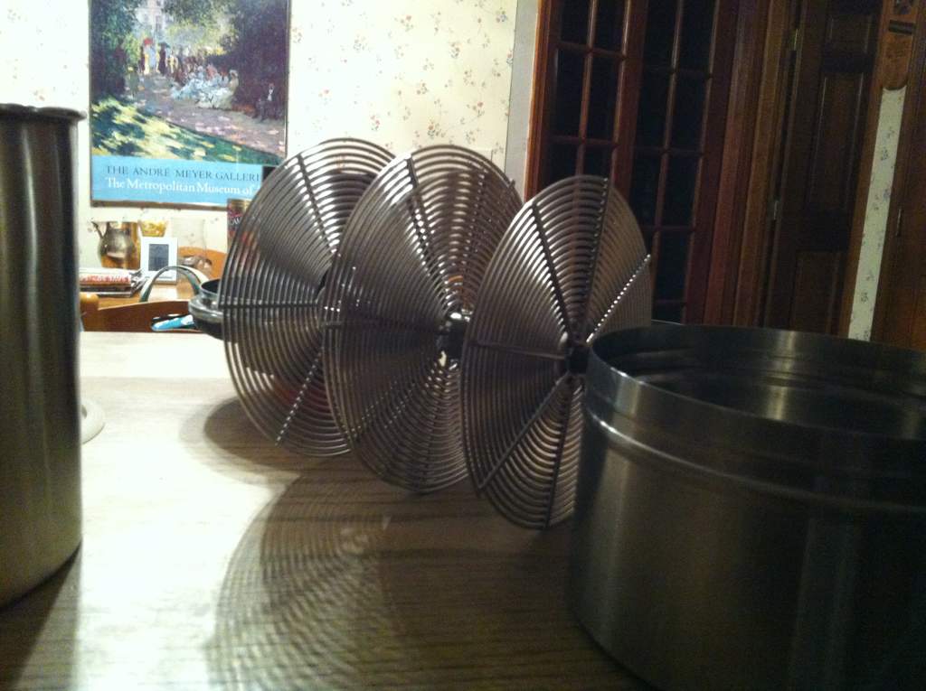

Hi 70m Guys, There is processing tank on sale:
http://www.ebay.com/itm/Vintage-Nik...575?pt=LH_DefaultDomain_0&hash=item20cff7752f
Why do people use all capital letters in the adds? This one is weird add!
Hey guys, not to start a war, but I've been bidding on this for 3 days so far and do plan to win it, so just know I will be taking this home so please don't bid against me and force me to spend extra money :/
~Stone

Deal! As far as I'm concerned it's yours! Good luck bidding!
Thanks on the plus side if I win I'll be selling my home made one, probably for less than the one on eBay goes for. :smile:
~Stone

Someone just bid against me on the 70mm tank :sad: I hope it isn't someone here... :sad:

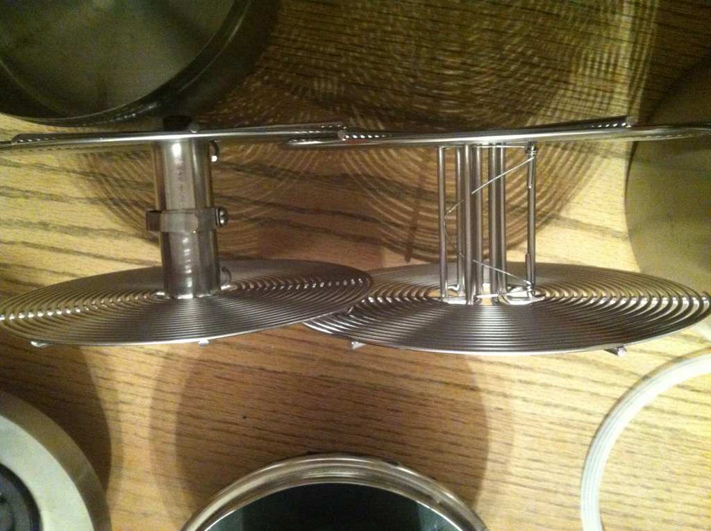

Wasn't me! My current system of cutting into ~220-lengths and running them in the Jobo is working very well and I processed 5m of 2405 the other night. I used my hacked loader to hold the spool and prevent it from unwinding while I wind it onto the Jobo spiral.
Which reminds me, the tape-as-marker trick worked well. Pull the darkslide after every 20 frames (for RB/RZ; it'd be every 32 on 6x6), make a loop of tape and stick it to the film with the sticking-up tab pointing away from the takeup reel, i.e. so that it goes cleanly into the cassette without any folding or likelihood of felt damage. When spooling the film for development, you can easily feel the tape sticking up and snip the roll at that point. That gives you half a frame of exposed leader at each end which is just nice for hanging the film up. You can also put a tape marker on the film while initially winding it onto the takeup spool (one stroke before the counter reaches 1) so that you know exactly how much to cut off the leader.

StoneNYC
Aug 5, 2012
8,345
Antarctica
8x10 Format
I'm curious, how are you able to fit 70mm onto a reel made for 120/220? Isn't the film about 5mm too wide?
It's not a 120/220 tank it's a 116 tank, that is the same width as 70mm...
On a side note... It's mine... One guy bid against me, his only bid .... Still I guessed I should make a final bid ... $350... The final sale was $342... Ugh!!! I'm going to owe my father $342... I'll never live this down...
~Stone
Mamiya: 7 II, RZ67 Pro II / Canon: 1V, AE-1, 5DmkII / Kodak: No 1 Pocket Autographic, No 1A Pocket Autographic | Sent w/ iPhone using Tapatalk
(there was a url link here which no longer exists). Principle works the same with Jobo 2501 reels as it does with Paterson reels. The only trick is that when you're reversing half of a reel into the other half, there is ONE orientation where they click slightly and get about 1mm closer together. They need to be in that position.
I'm seriously considering cutting the centre of a couple reels (I have 8 and rarely need more than 6 at a time) and then gluing it inside a little extension tube to make it the extra little bit longer and self-supporting without being on a core. That would allow me to process more than one 220-length at a time. Otherwise, I have the silly situation that I can run 6 rolls of 120 in a single process, but I can run only 1/3 of a 15' spool of 70mm.

OMG OMG OMG!!!!

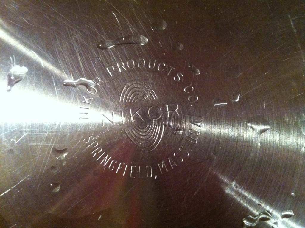

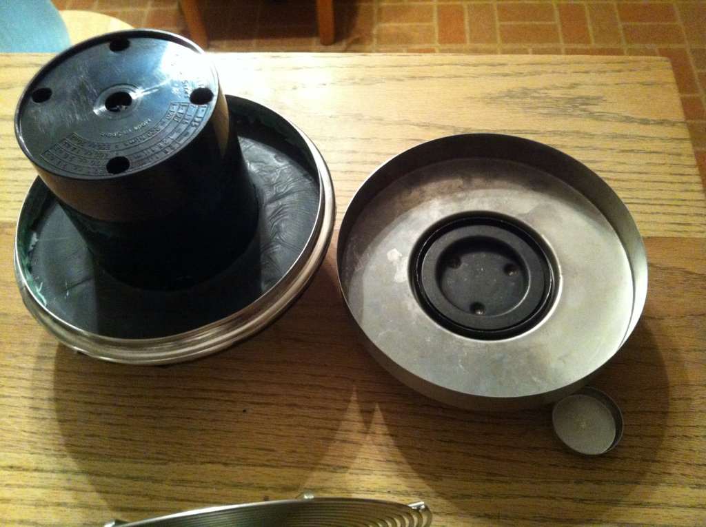

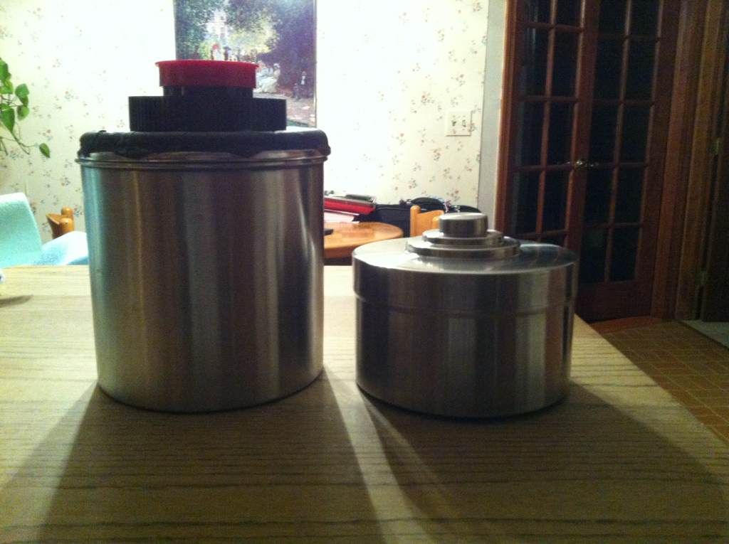

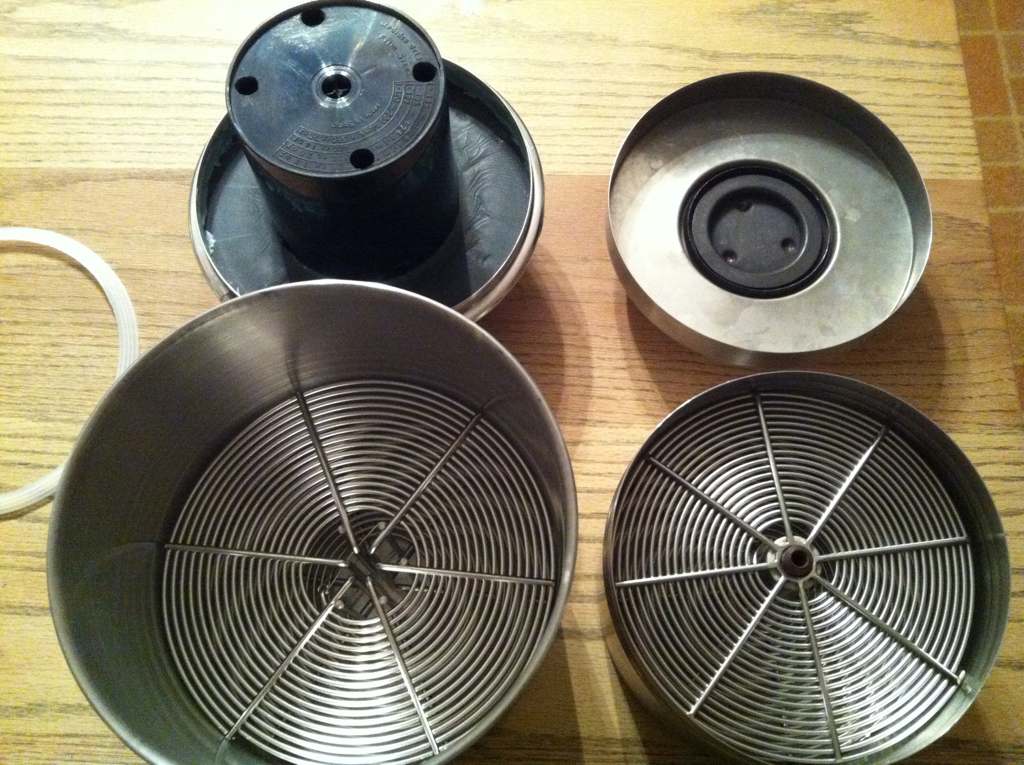

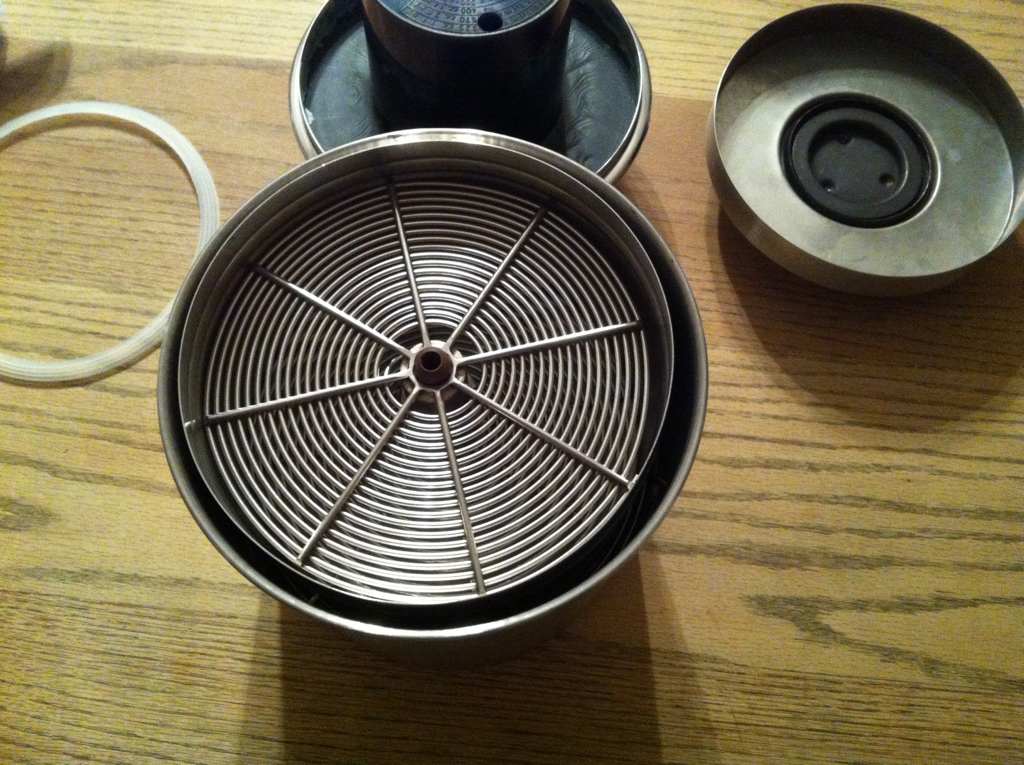

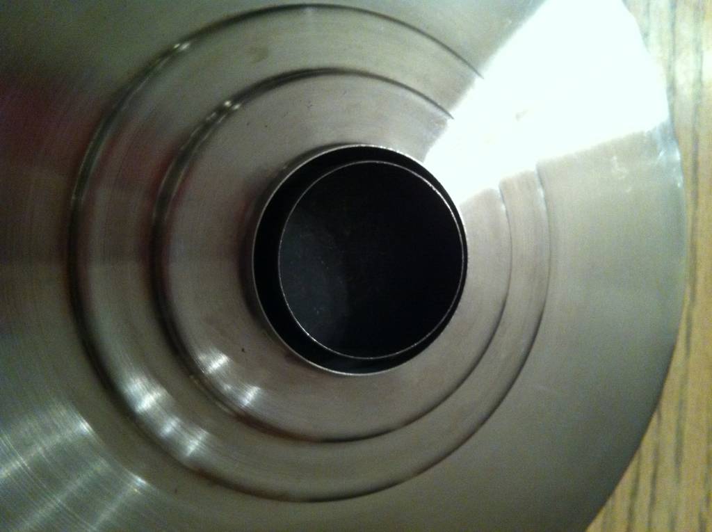

Well, Stone, With your latest purchases of 70mm bulk loader and those two processing tanks you are The King of 70mm! Congratulation! Comparing those 2 tanks, you will save on some chemistry too! What is capacity of your new reel?
Actually it's only slight, and really I just use the 2 L photographers formulary bottle so it's not any different, technically probably I could use 1.8L instead but I like simple math so 2L is easier to measure.
The large tank I was still able to cover the spiral, just barely. Had to be sure it was always level. Now I have a little play at least.
Once I confirm the Nikor is leak proof and easier to load, I'll sell the larger home made tank.
It will be a month before I get through a 65 shot roll...
Wish me luck!

We all need that luck! :smile:)
So, capacity of your reel is 65 -6x7 shoots? Reel I'm using takes 100" or 40-45 - 6x6. Just right amount for few hours of shooting.
Well the reel takes 5 meters, but the canister takes 3.6-5.2 meters depending on the base of the film.
So I just load till its full, I have specific 15 feet "bulk rolls" that I have to re-roll as they don't fit in the cans (must go to another kind of 70mm back) but there's always a little extra than 15 feet (4.6m) so I just shoot it all, most I've gotten was 64 shots.
Once the film came out of the spiral and wrapped around once more, but the emulsion faces inward so it didn't scratch the film and developed just fine. I wonder if the new spool takes less than 5 meters, I think it's the same just that the space between is tighter... We will find out soon.
