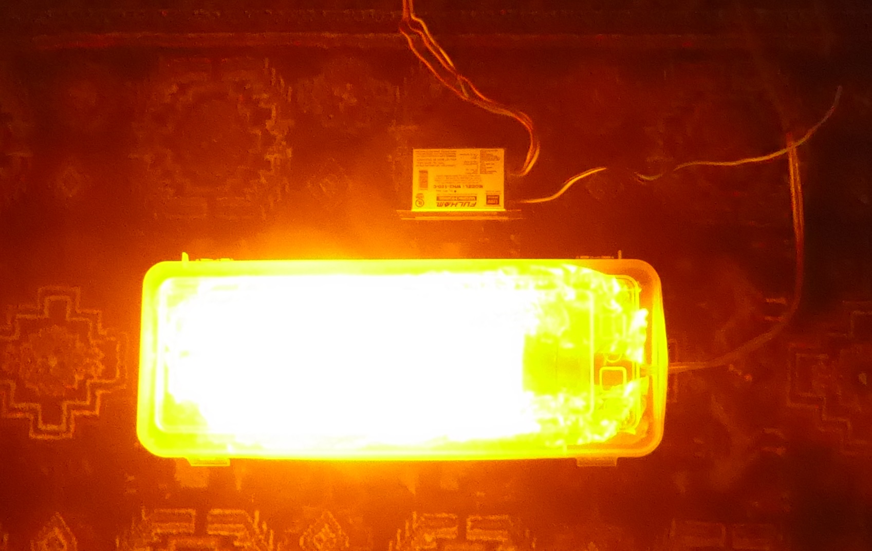

A bit late to this thread, but I also had the Thomas safelight decades ago but it seems it was thrown out. I was interested in LPS light and wanted to recreate that several years ago. I found it wasn't too difficult to get a 35W Philips bulb, but the original ballast was much harder. On a tip, I tried a modern 35W solid-state fluorescent light ballast and that worked perfectly!
The socket does not actually support the bulb so I decided to just solder the ballast directly to the pins. I put the bulb inside a clear plastic 12" pencil box. I put aluminum foil behind it as a reflector which didn't really work because the shape has no accuracy.
I don't have any idea what to do about the Thomas filters, as I was just interested in the light - not the safelight.
I used this ballast from Amazon: Fulham Lighting WH2-120-C. The bulb was from eBay.
