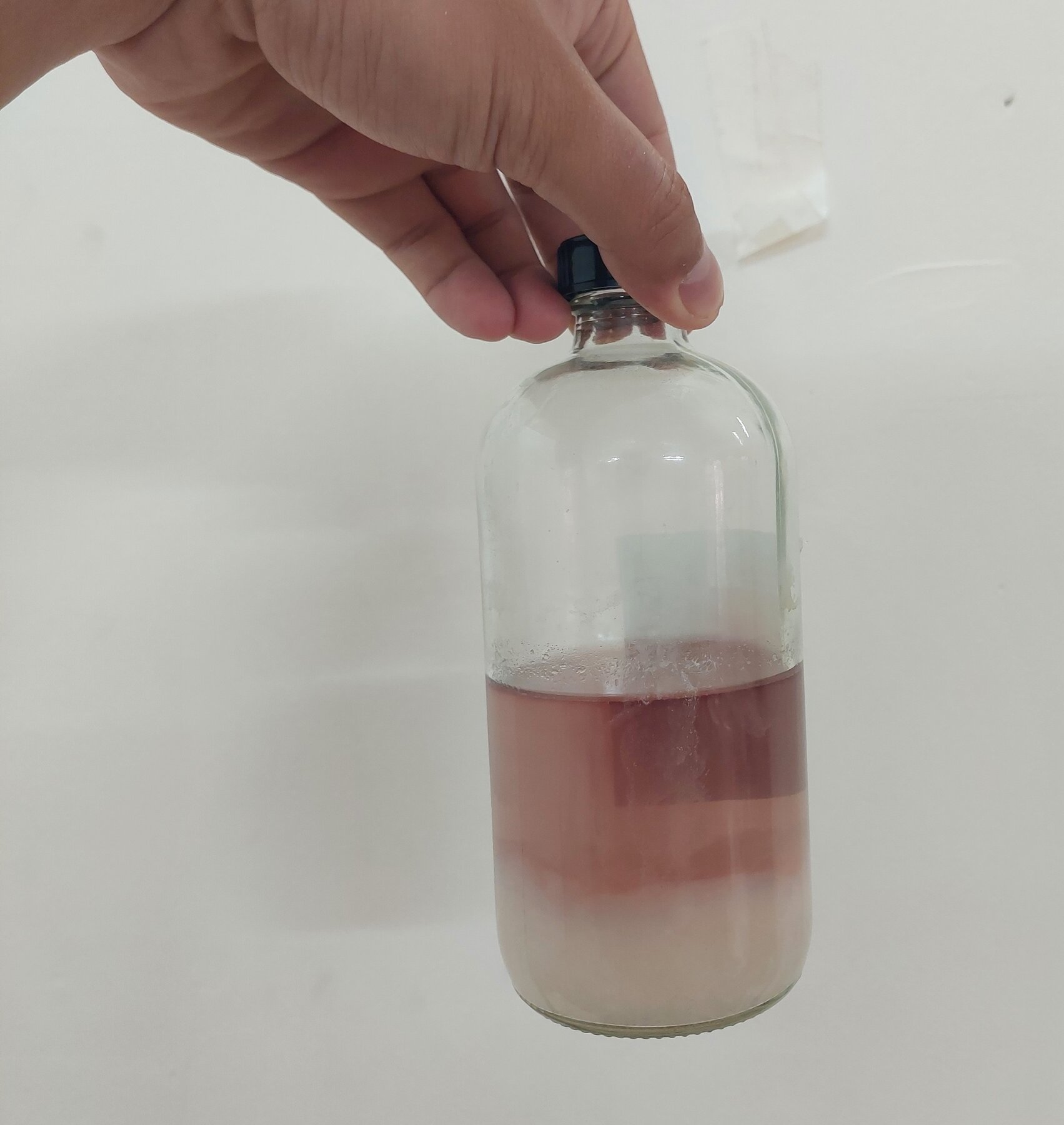

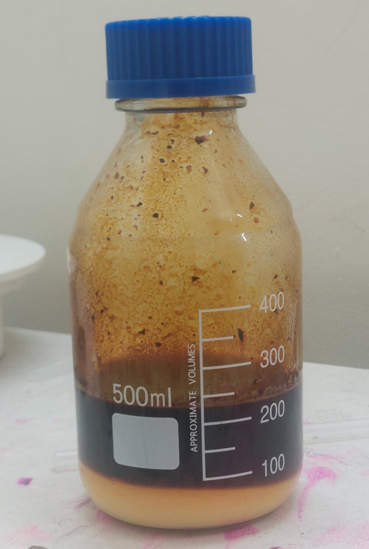

Hi OGs, I came back with the result. These are, so far, the 2 batches that worked.
The darker one I do exactly like DrFrakenfilm tutorial, the result came out with a thick layer of milky stuff that I told ya. It worked, but somehow stronger than the Rodinal chart on massive dev chart, with the same amount of time it renders harsh contrast and big big grains
The lighter one, I split them in half.
- 100g of water was used dissolve 32g of Na2SO3
- 50g of warm water (50 - 60°C) was used to dissolve 15g of crushed tylenol, then I filtered it out through a coffee filter paper.
The filtered tylenol now pour into a 100g of water + NaOH (I wait until it cool down to room temperature before I pour Tylenol in)
- I mixed the two together and waited for 72h then got the result.
With this one, it's weak. I think some acetaminophen didn't pass the filter paper. I use it to develop a Ilford Pan 100, which should be 9 minutes, but I left it there for 10,5 minutes and it still dark. The grain is awful guys, I'll attach the photo.
I think I'll do more research next time, there's still something missing that I don't know it yet. Thank you guys a lot for helping me.

Hello, you are getting overactivity and large grains on the film due to an excessive amount of sodium hydroxide. For the second attempt - Tylenol should not be filtered. This is because most of it cannot dissolve, and during filtration you remove it along with the inert particles.
Thank you @Raghu Kuvempunagar !
I've just ordered it, kinda pricy but I think it will worth it!
@lamerko yeah I do think filter the tylenol was a bad idea, but there must be some way to remove the starch and wax in the capsule aight? Btw I only use 8g of sodium hydroxide for the lighter batch. Maybe because the lack of acetaminophen so the sodium hydroxide cannot fully react, that's why it creat excessive sodium hydroxide I think.
The inert fillers from the tablets can be removed at the very end, once the whole process is complete and you have a working concentrate. This is because Tylenol/paracetamol, as well as the base p-aminophenol, have very low solubility in water. Initially, when you add the crushed Tylenol tablets, only a small portion will dissolve, so you shouldn't filter at the beginning.
For everything to work, you need to cleave the acetate group from Tylenol via hydrolysis using a large excess of hydroxide. If there isn’t enough, the hydrolysis will be too slow, incomplete, or may not occur at all. The goal is to form the soluble p-aminophenolate salt, which in this case requires an additional 5-6 grams of sodium hydroxide.
By the way, once the whole process is complete, you can slightly adjust the pH to account for the large excess of hydroxide.”
