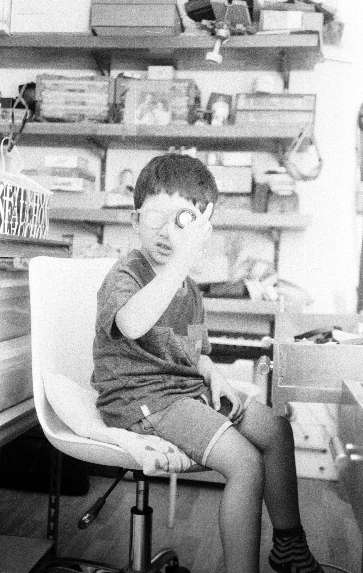

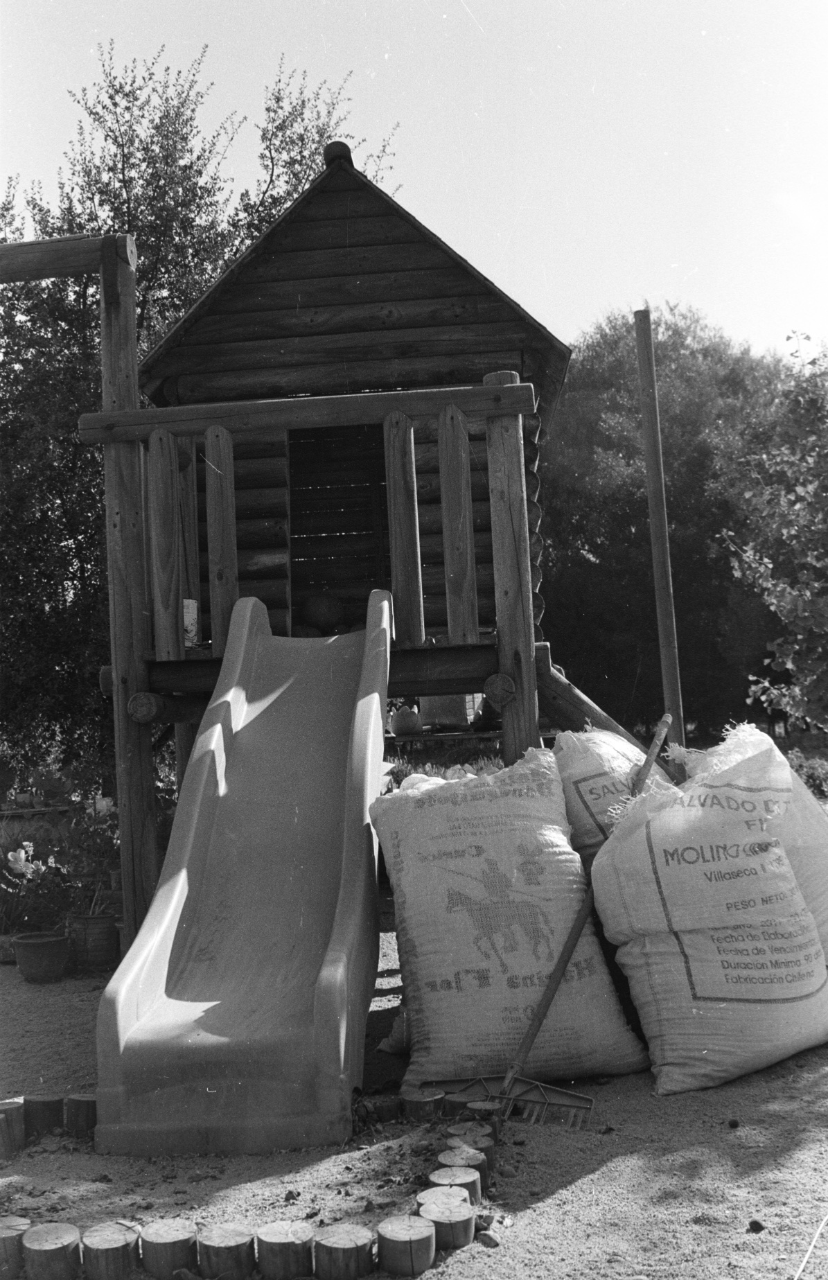

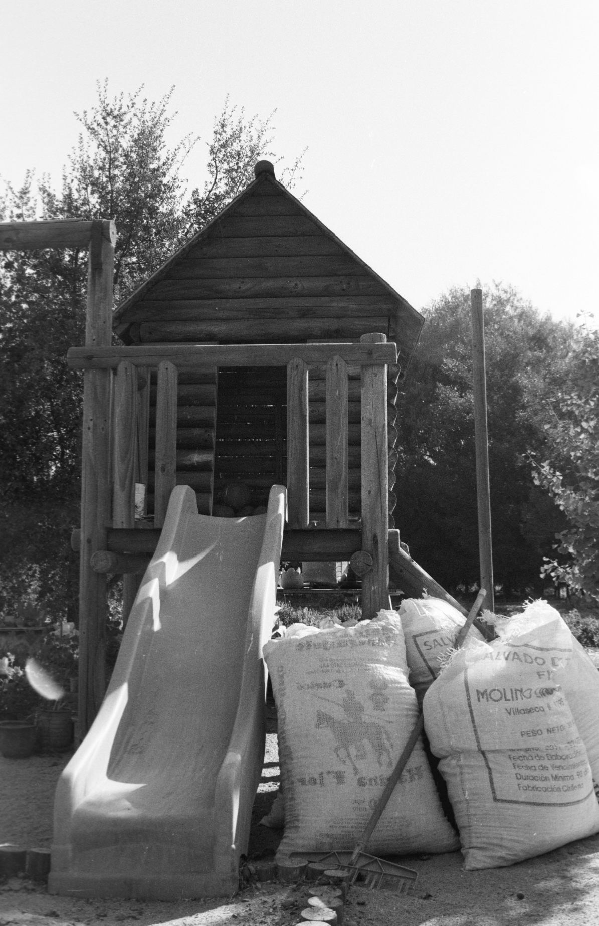

Here are the samples
This is two are Ilford FP4
Traditional D76 1+1 11min
https://drive.google.com/open?id=1-QO3c6Y_vOtu5ZwwQnWKEHrmu2oK-Eg6
Cafenol (corrected recipe)
  • 10 teaspoons cooffe
  • 6 tablespoos pool pH Up
  • 3 gr vitamin C
  • Water to complete 500ml
Developed for 15 minutes
https://drive.google.com/open?id=1GmIgLsEpQ9I-DZkfWeEq6bTGDvDg06Kv
Finaly Parodinal 1+50 for 11 minutes, Kentmere 400, too much grain
https://drive.google.com/file/d/1SsVfWbxB6_FucBajAiYcyGOw0eXsX5Vy/view?usp=sharing

That's not a very equal comparison -- 100 speed film in a highly solvent developer, vs. 400 speed in a high acutance type. Swap the two and you'll probably like the results more.

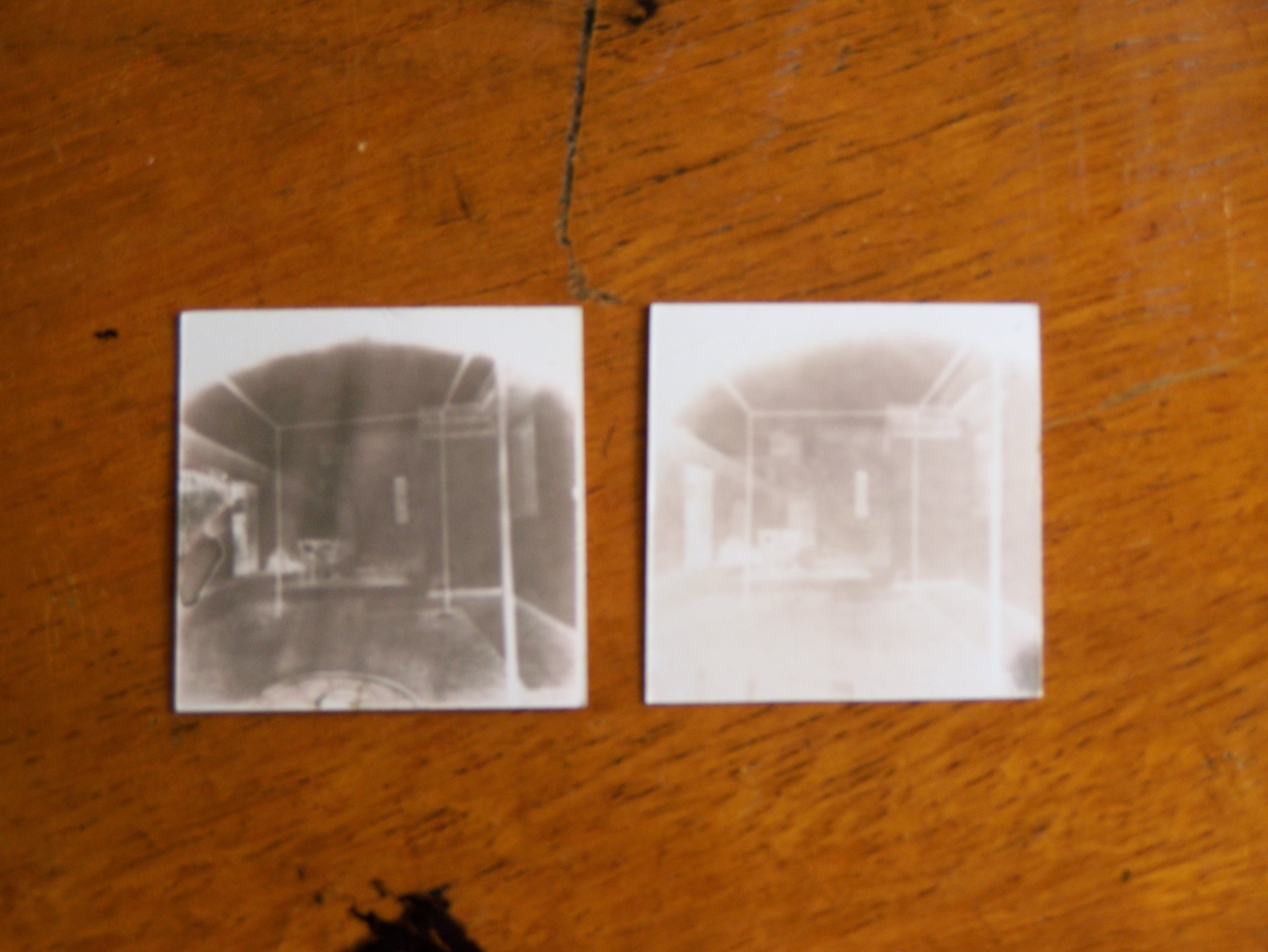

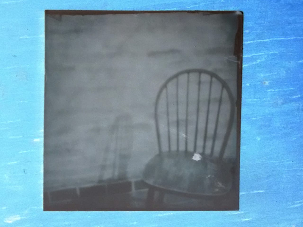

Well... paper arrived yesterday.
I made an experiment, but note it was probably gross by photographic standards.
I mixed 2.5 grs of acetaminophen (in the form of two and a half tablets of 1 gram) and 15.70 grs of lye pellets into 50ml of water.
The lye dissolved completely and the tablets incorporated. First the solution was milky, and then it started becoming more rose coloured, like Donald said it should be.
I then exposed a photograph on my pinhole camera from a cut of rc paper, for one minute. Today is an overcast day.
I got into the darkroom, took the paper out of the camera and just put it into that mixture of "rude parodinal" dilluted with water to make 237 ml and then added 237ml more to the tray. I was able to see and image appear onto the paper, and left it for two minutes into that mixture to fully develop. Mi stop bath was a splash of bottled lemon juice on tap water (I know, very unscientific) and the fixer Ilford Rapid Fixer 1+9 for 2 minutes. I washed for two minutes.
My result:
Now, the image is very soft. It's my cellphone. The real image has detail in shadows and mid tones. (Iḿ not sure for the highlights because since the sky was completely cloudy, I don't think there could be much detail anyway) To me, it's overexposed. But that's not the issue.}
I obviously had problem with development. The image has lighter streaks all over it (Since they're lighter in the negative, it's not light gaps) And there's a chemical... thing... in the edge.
I think maybe my crude developer is too harsh for the emulsion, too cold, too little time, or too little agitation.
Maybe you can tell better. :smile:
Regarding Rafael, I bought the paper an the fixer on Mercado Libre. If my Rodinal doesn't work I'll but things there then. (Compré el papel y fijador en Mercado Libre. Si mi "Rodinal" no funciona, entonces compraré as cosas allí.)
For the way you made the developer, I don't think that negative looks terrible. Normally, with the sodium sulfite, you'd let your Parodinal stand for 24-72 hours to turn pink. You may have underdeveloped, however; Parodinal at the usual dilutions is much less active than common paper developers at printing dilutions (like Dektol 1+2). Longer in the developer might have evened out your development. The unevenness might also be due to stop bath that was too weak, so didn't stop the developer at the same time over the whole sheet -- ordinary white vinegar, 1+1 in water, is the same as common commercial stop bath.
The "chemical...thing..." is probably an area that either didn't get fully fixed or didn't wash completely. At this stage, I wouldn't worry much about it.

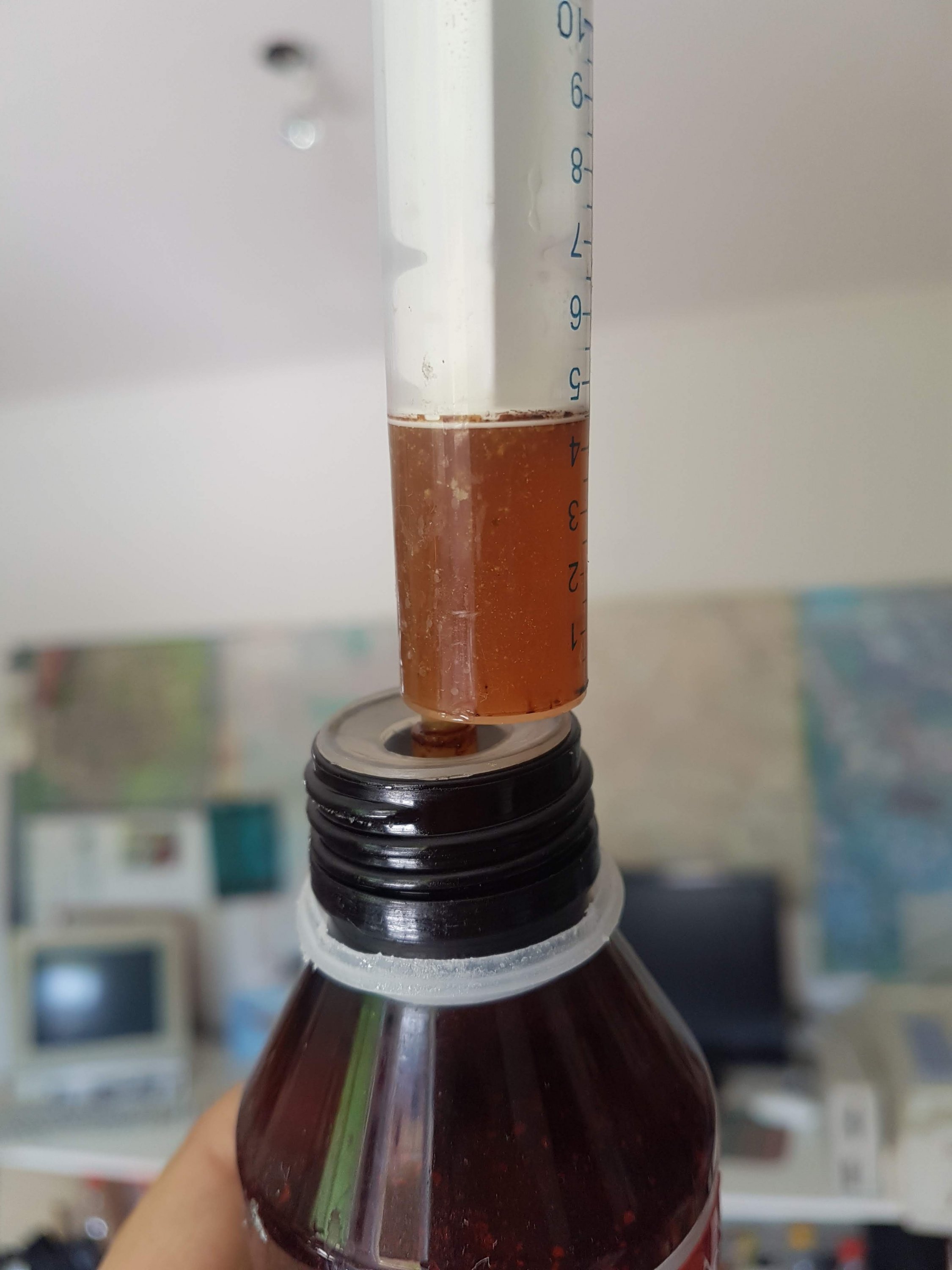

The other day I tried using it as a paper developer, I had to dilute it 1+200 because it was to fast. I don't know if my parodinal is ok because 1/4 to 1/3 of the bottle is filled with crystals

@Rafael Saffirio For best concentrate longevity, you need to have some crystals in the liquid, but I've never had more than a thin layer on the bottom of the bottle when I've made it.
Max's developer turned color fast because he didn't have sodium sulfite, so the p-aminophenol started to oxidize immediately; his developer probably would have looked like coffee after three days.

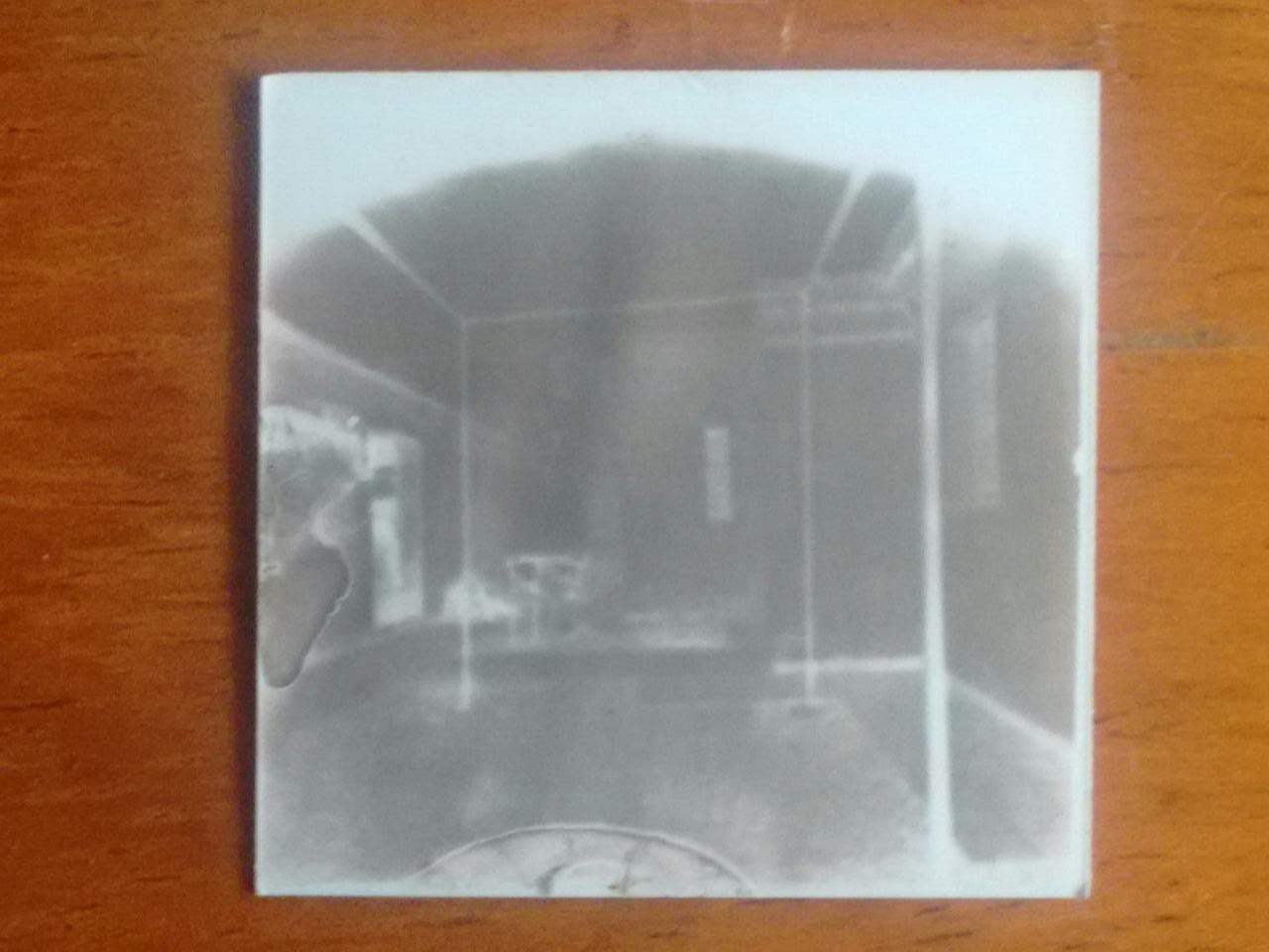

I made a second test:
That's the second test next to to the one I posted earlier.
This time the crude rodinal (if I can call it like that) was grey-ish in colour.
I constantly agitated it in both dev and fixer. The uneven development now isn't a problem. It seems to have been underdeveloped because the exposure was the same.
The density was gorgeous right before getting into the fixer. When I washed it it had come up like this.
My rodinal just doesn't last as much as three days. I left it overnight in the tray and today it was dark coca-cola-like so.. whatever. I don't really mind. It's cheap and easy, if not quick and dirty.
I'll make the developer again, same method described. I'm going to wait 15 minutes and not gonna dilute it too much. (Just add enough water to make 237 ml)

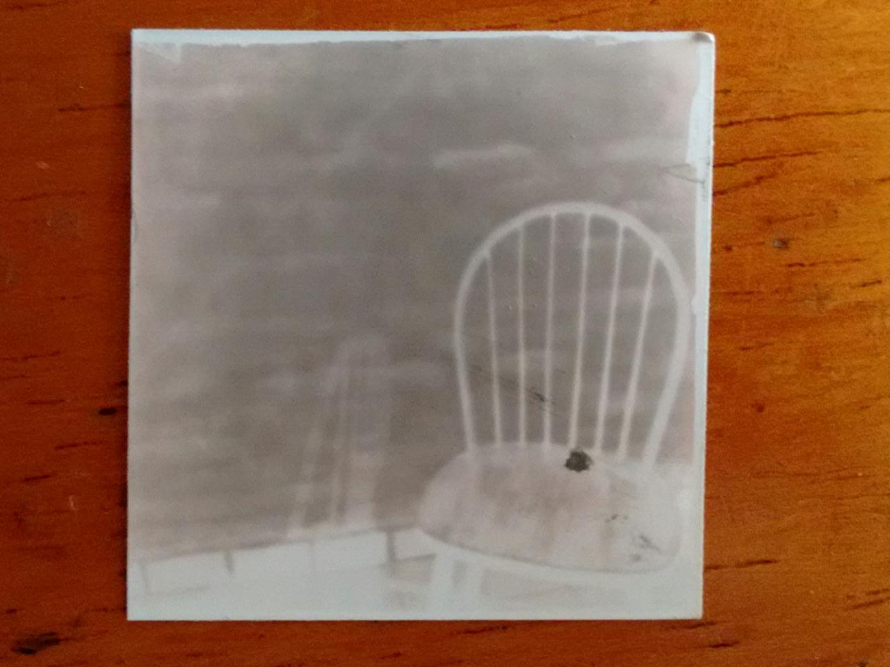

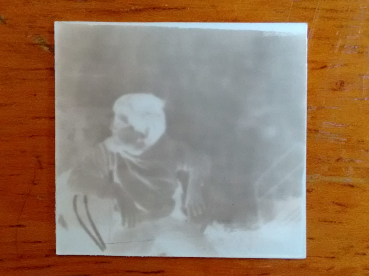

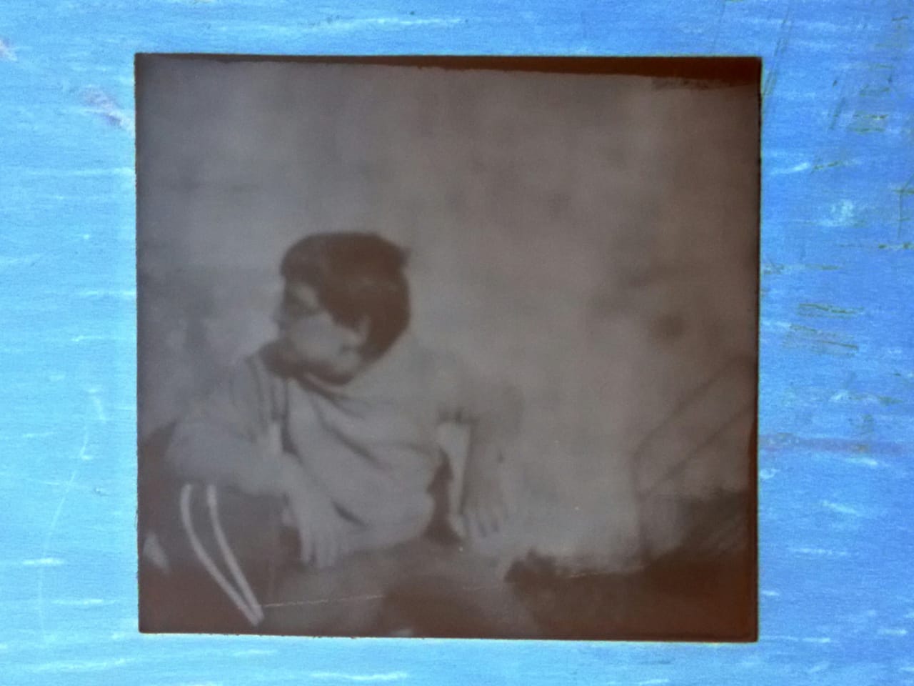

I made two further tests with the developer I described: 2.5 g acetaminophen 15.70 g lye pellets into 50 ml water (I add the lye to the tablets already in suspension) wait 15 minutes (it gets milky pink) add water to make 237 ml. I used it when it was brownish coloured like the one Rafael made.
I insert both the photo of the negative and the digital inversions (in case you're curious)
I honestly really thank you for the feedback given! It's helping me a lot to discover the paper negatives and the silver gelatin process!
