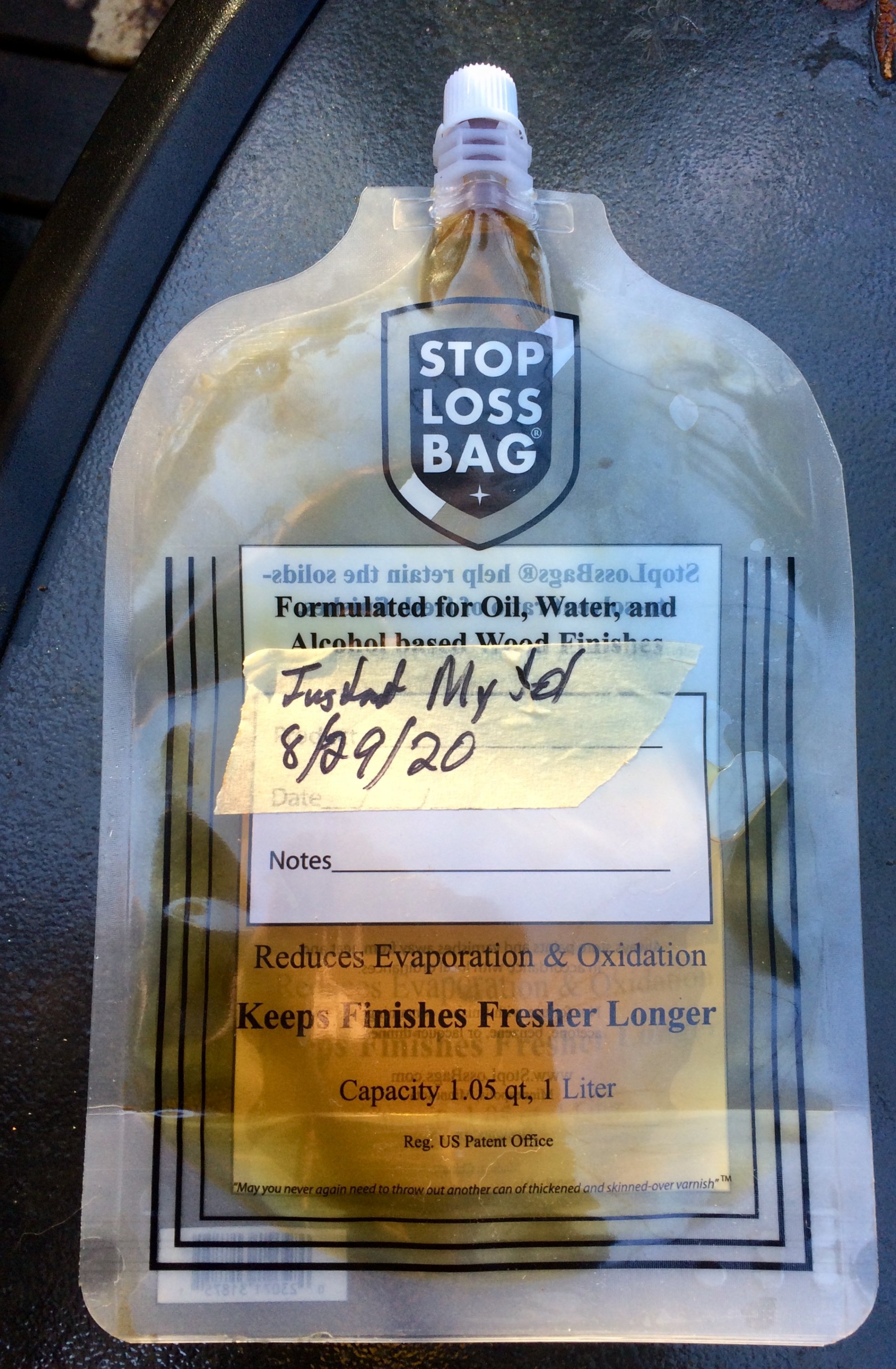

I don't know if this has been mentioned, but Jordan also listed a version of Instant Mytol where most of the materials were in glycol/TEA for greater shelf life. One adds the sulphite with the stock when mixing the working solution. 1+19 is like Xtol stock and 1+39 is like 1+1. I have found that it works like regular Instant Mytol which in turn works similarly to Xtol. In my experience the shelf life of the stock sol. in glass was not quite as good as PC-TEA but still respectable and usually I use it up well before hitting the wall with shelf life. I am now trying it in a wood finish/IV bag.
"This formula can be mixed as an organic solution as well. Combine 13.4 ml triethanolamine and about 20 ml of propylene glycol and heat in a water bath or on a hot plate. Add 11.5 g ascorbic acid and 0.15 g phenidone and stir until dissolved (it could take quite a while -- magnetic stirring will help -- addition of 1-2 ml of water may also aid dissolution). Then dilute with propylene glycol to a final volume of 50 ml. This organic solution should keep almost indefinitely. To use, dilute 1+19 with water containing 60 g/L sodium sulfite."
https://www.photrio.com/forum/resources/instant-mytol.179/
