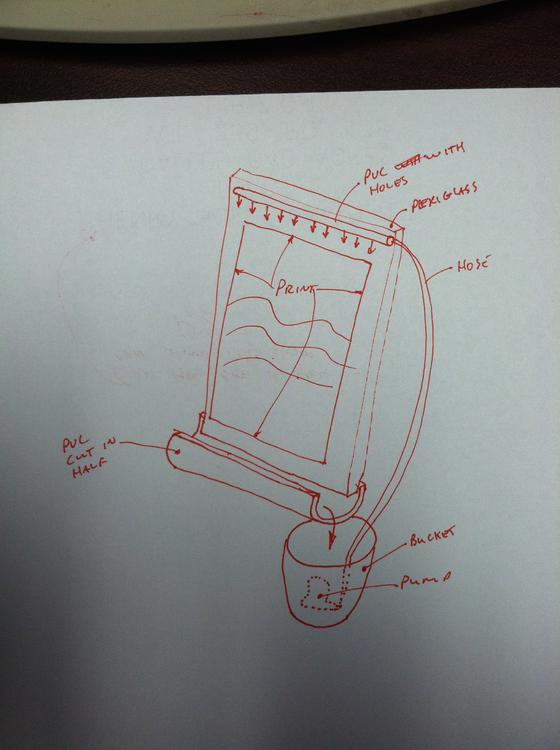

The largest that I have made so far is 20x24 inches. I'd like to buy a roll of mural paper and stretch out my Durst 184 legs a little. If I was to do this I would build something similar to this or use drums. I bought a 12v low volume pump a while back just for this use.
