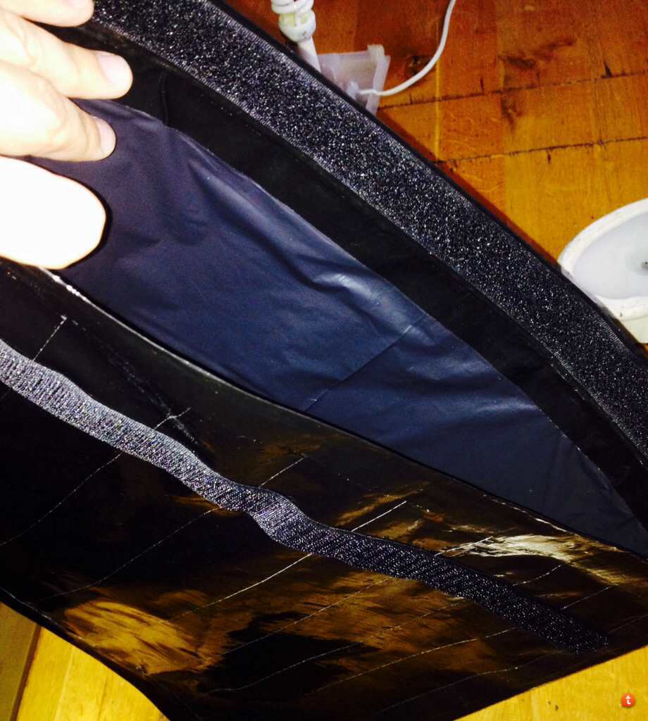

So I was in need of a light tight bag for a film test and realised (thankfully before taking my film out the can) I didn't have one!
So in true Blue Peter style (UK residents will know the reference) I made my own with a bin liner, some sticky back gaffer tape and some Velcro!!
Doubled the bag, taped each end up and the covered the entire bag with black gaffer tape. Made a lip at the top with gaffer and stuck some Velcro on it.. Hey presto, a light tight bag for temp storage of exposed and undeveloped film :smile:
Just thought I'd share my day!

I think the layer of gaffer tape does the trick! :wink:

Well I just used it and it works a treat! Hurrah :smile:
