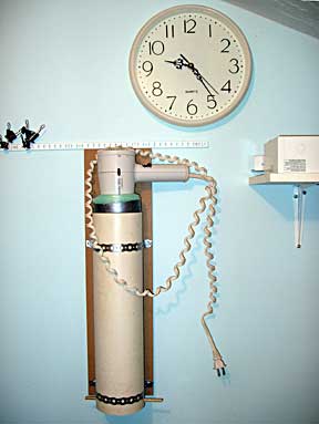

Upon removing my stainless steel reels from my tank after coating the negs with Photo Flo, I shake the reels mightily to cast off residual Flo, then I place the reels in the tube and start the hair dryer on cool. This way, I never get residual Flo effects and my negs are wonderfully clean! My sister built it based on my suggestion, but she set her dryer to warm, and artifacts in the wash water stuck to the film, ruining it. So, never use this method with your dryer set to warm or hot; use the cool setting, only.

Do note that how fast your film dries in the drain pipe device will be based on the power of your hair dryer. Mine is a Supersolano (Italian) 1800 watt dryer and, depending on the temperature of the air in my garage, it dries my film in 12-17 minutes (depending on the season of the year). Again, always set your hair dryer on 'cool'.

James, you are attempting to introduce unnecessary addendums to this method of drying film. Most importantly, the reason the dryer is mounted at the top is to force the blasts of cool air out of the dryer at the bottom so as to keep dust from entering at the bottom and contaminating the film. There is no need for additional "venting areas" along the sides of the pipe, for the dryer successfully dries the film every time. Third, don't scrimp on the hair dryer you buy: Good quality, more expensive ones, many under $100, generally have three settings--cool, warm, and hot. The stronger the wattage, the faster your film will dry.

Chuck: This drain pipe/hair dryer device does not involve taking the film off of the reel. You merely insert the reel with the film still within it in through the bottom and push a pencil through the two holes below it so it cannot fall through the bottom. Second, there is no need to concern yourself with a hair dryer pulling in dust, inasmuch as I've tested three different manufacturers' dryers and none did that. I have used this device at least 50 times so far and my negatives are startingly clean. My experiences and deep frustration with dirty negatives are HISTORY!

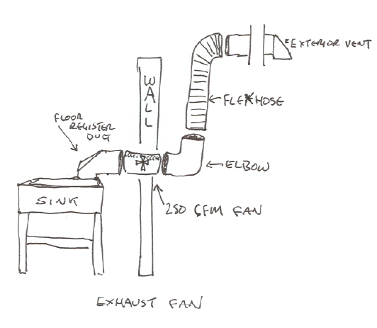

I'm planning to build a drier as part of my ventilating system. It's encorporated into the intake and the second sketch is of the exhaust portion of my system. I would welcome any comments.
