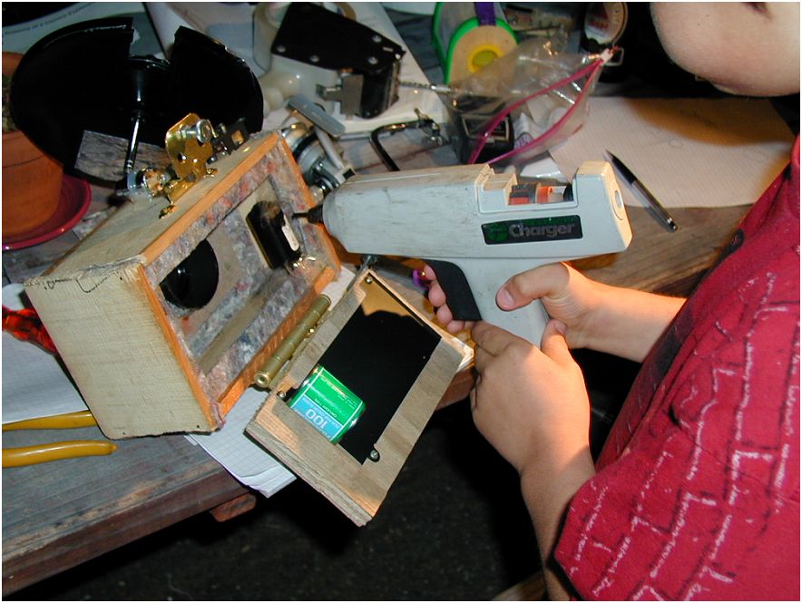

Here's that young man making a camera... this was back in 2001.
Sometimes you have to make something just to prove you can.
