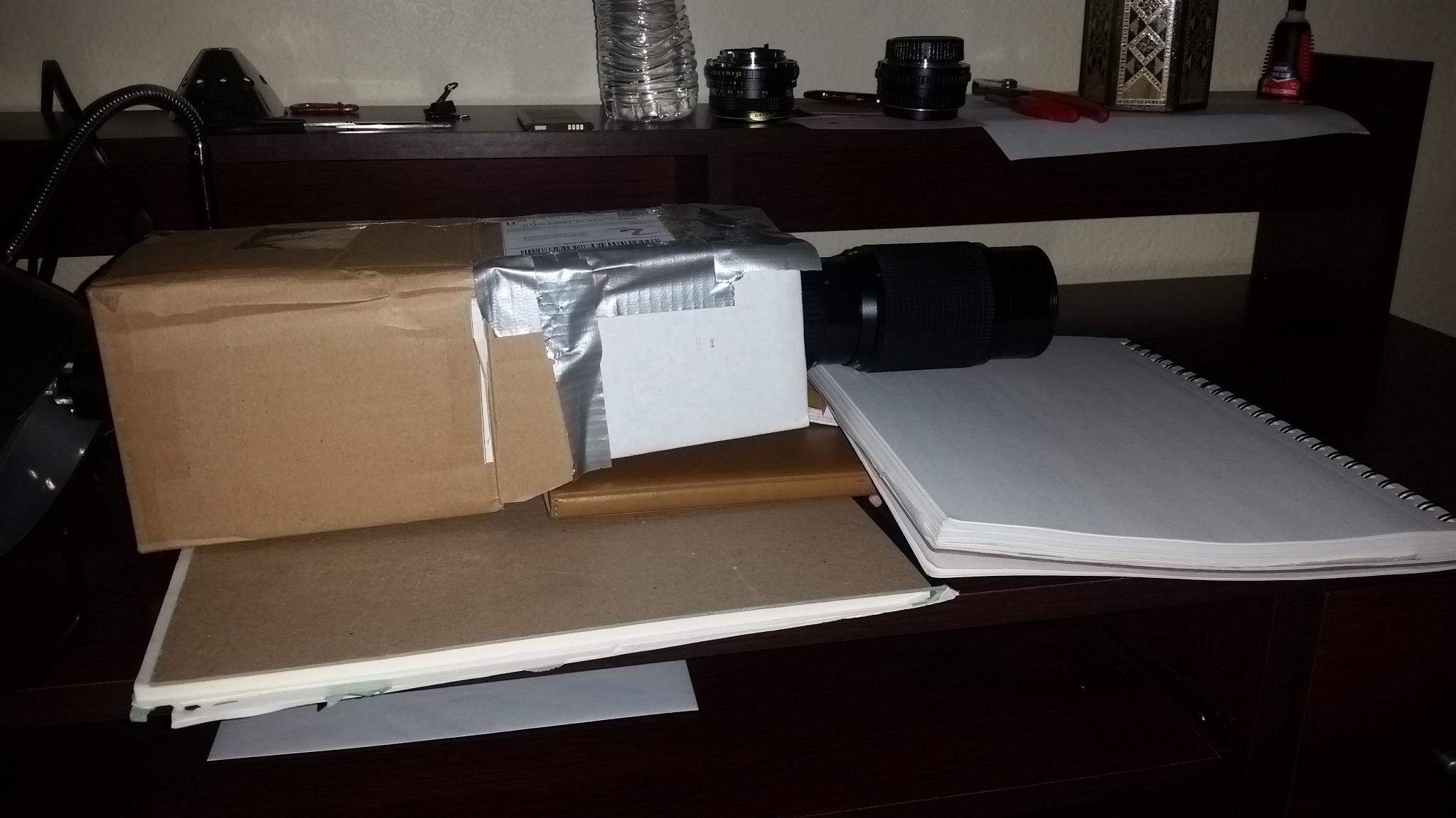

So essentially, being a broke as hell college student who also loves building things, I've decided to build my own enlarger for bw. I got the inspiration from a YouTube video
( ). I wanted to start with a prototype, a proof of concept, so this is just the beginning. Basically I have a box with a light at one end, some parchment paper (with an S drawn on it) in the middle to diffuse and disperse the light abut and a zoom lense at the end. Initially I tried a macro lense thinking that might work well (I'm new to photography, a more experienced person may not have made my assumption) but I could only get it to focus very close to the projected surface. After playing with some different lenses I found a zoom lense worked best, it had superior focusing capabilites. The next step includes making the thing light proof, making it vertical instead of horizontal, making a sturdier film plane, adding real ground glass as opposed to parchment paper. Finally I would like to see if I could find a broken camera with which to salvage a shutter system from and build into my little Frankenstein. Below are some photos. Please give input on how to improve and what problems I may face.
This is the contraption, very simple

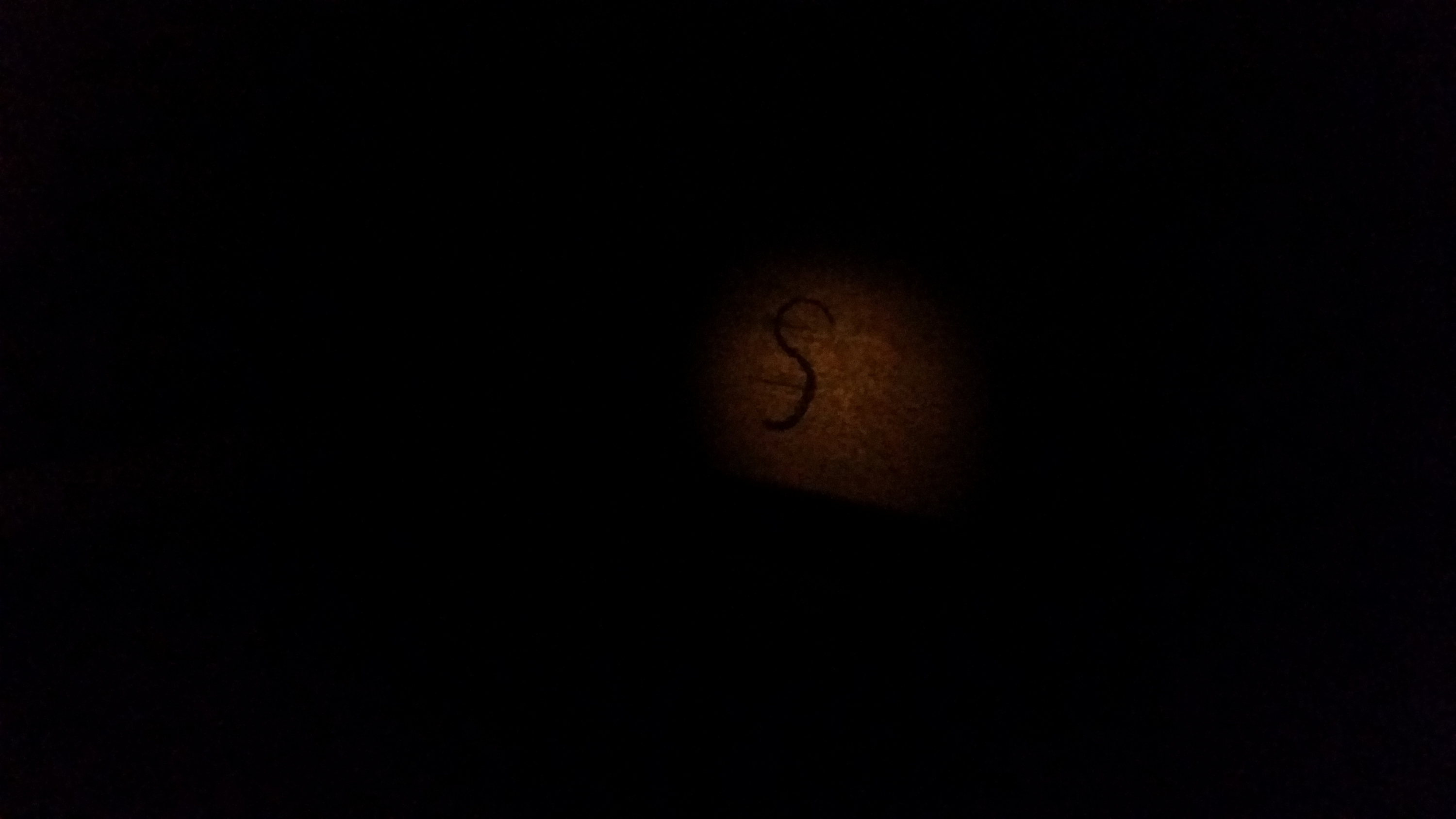

Below is the first projection, it's against a wall, the image may not show but the S is in focus, and the light is a bit brighter

The enlarger in the video seems very impractical. While it demonstrates the basic principles of an enlarger, it fails to address several considerations such as even illumination of the image and precise focusing. Using a broken SLR with a macro lens would facilitate focusing and film transport. A few zoom lenses might provide close enough focusing and acceptable image quality. If you have the right equipment available, you might fabricate a substitute for the camera body from wood which could incorporate a few features lacking in a camera body. The negative can be evenly illuminated through one or more layers of opal glass, which could also hold the film flat in the film gate. Condenser lenses instead of such a diffuse light source might be more efficient, but more difficult to arrange, and they would require more space. The vertical setup is not as sturdy as your horizontal arrangement. Considering the slight value of old enlargers, the whole project seems impractical.

The tolerances involved in making a really useful enlarger are beyond the capabilities of the average home hobbyist without a working machine shop available to him.

You can make a professional and properly aligned enlarger w/o a machine shop. I'm looking at my two Federal enlargers right now, and they're so simple and well designed that I could build one like them w/ a few tools, a level, and some carpenter squares for alignment. Getting the proper materials is the real problem though.
However, I have machine shop skills (ex tool and die maker), and the mechanical skills too (ex certified mechanic) and understand what to do. Having said that, you don't need ALL those skills to build an enlarger, not at all. You just need to understand the process of building something, be skilled to some degree w/ tools, and have those proper tools and the correct materials. Unfortunately, those things will surely cost more than just buying an enlarger. People are giving them away these days.
If I could do it, others can too. And that would be my approach, copy an existing design as much as possible. While the op should be commended for trying, it needs to be much more better built and of the correct materials. For instance, you need a diffuser of some sort to properly diffuse the light, which is not difficult to procure or build, but you do need it, or the image will be bright in the center and too dark towards the corners.
In the end, rather than trying to reinvent the wheel, I decided that spending $18 each for my enlargers plus shipping was the smarter way to go. Had to buy the correct bulb for one, a few other odds and ends, repaint one base, and buy better lenses, but I now have two very nice and properly aligned enlargers that can print from 35mm to to 6x9 negs, and print them larger than 16x20 for around $60 each.
