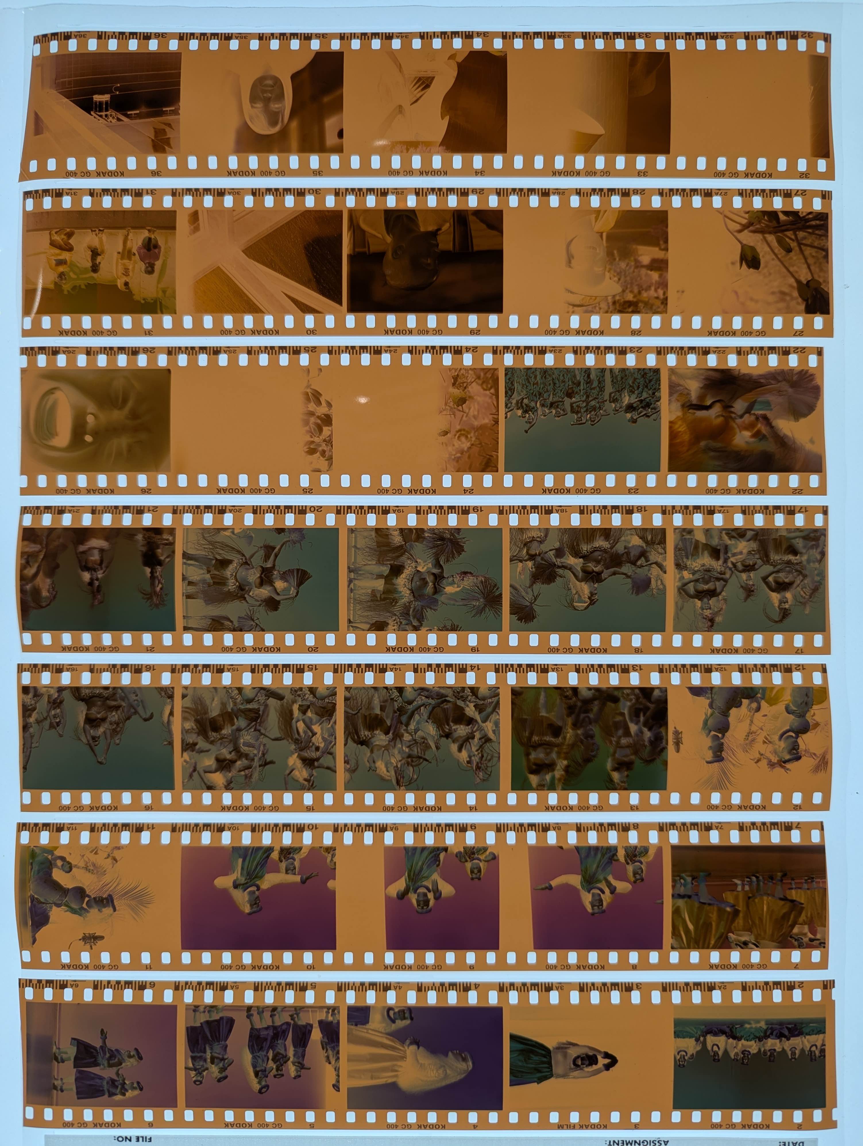

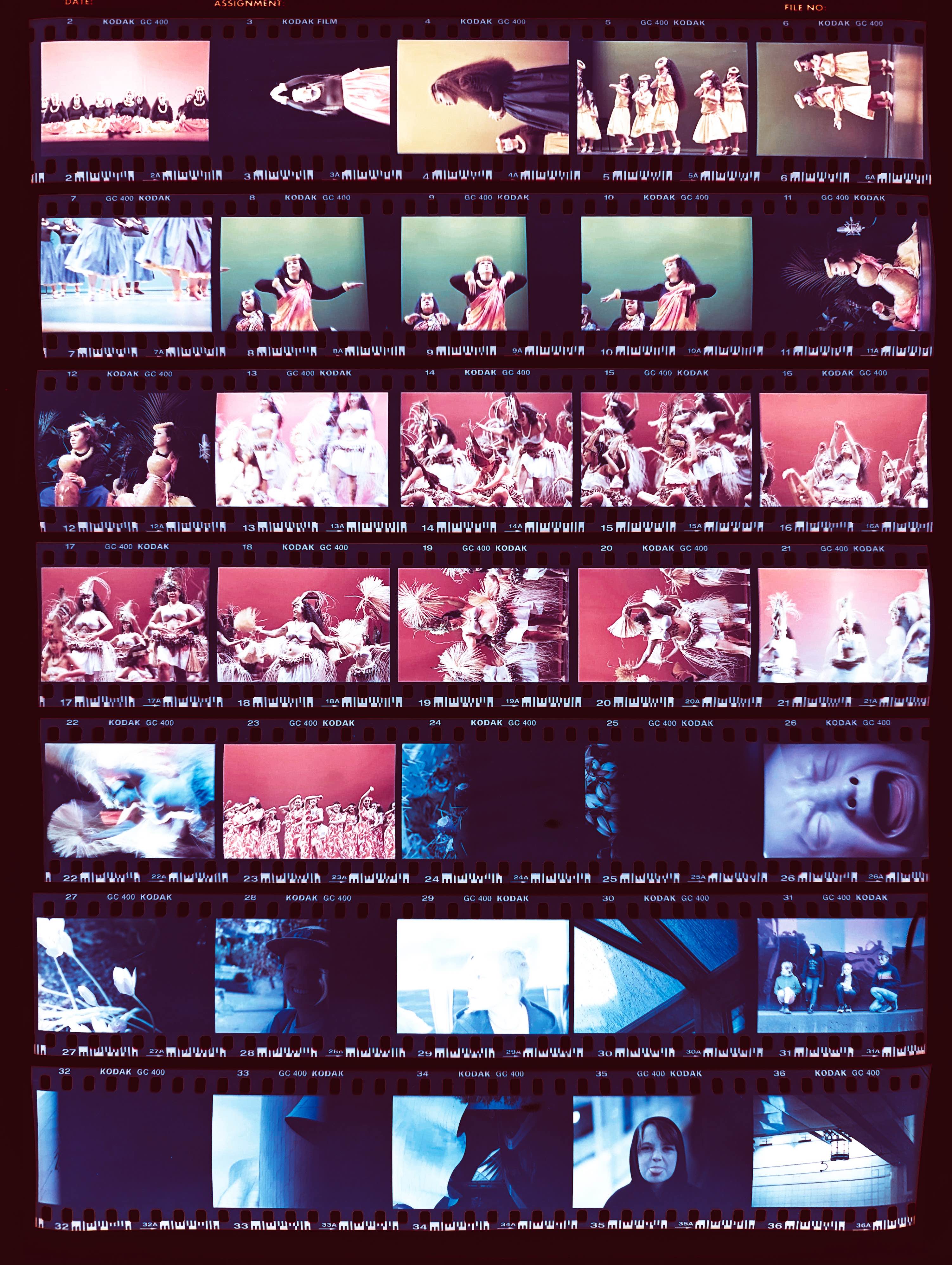

I tried the full dev, bleach, fix set today. Proper inversions will need to wait until I can actually scan them. But there are definitely images! (note the last half are wonky because the camera was having issues)
At first glance contrast seems to be very high for C41 (after adjusting the photo for white balance of the backlight). But this could also be due to the photo of the strips. I'm sure they can be scanned alright though!

Oh! One wrinkle might also be that I used a rotary developer with continuous agitation, but did not adjust the dev times. So it could be quite over developed.
This will not make much of a difference.
For your homebrew C41 developer, did you adjust the pH to the target value? One of the common issues with homebrewing C41 developer is the pH ends up not exactly right, in which case the developer will end up significantly over- or underactive.

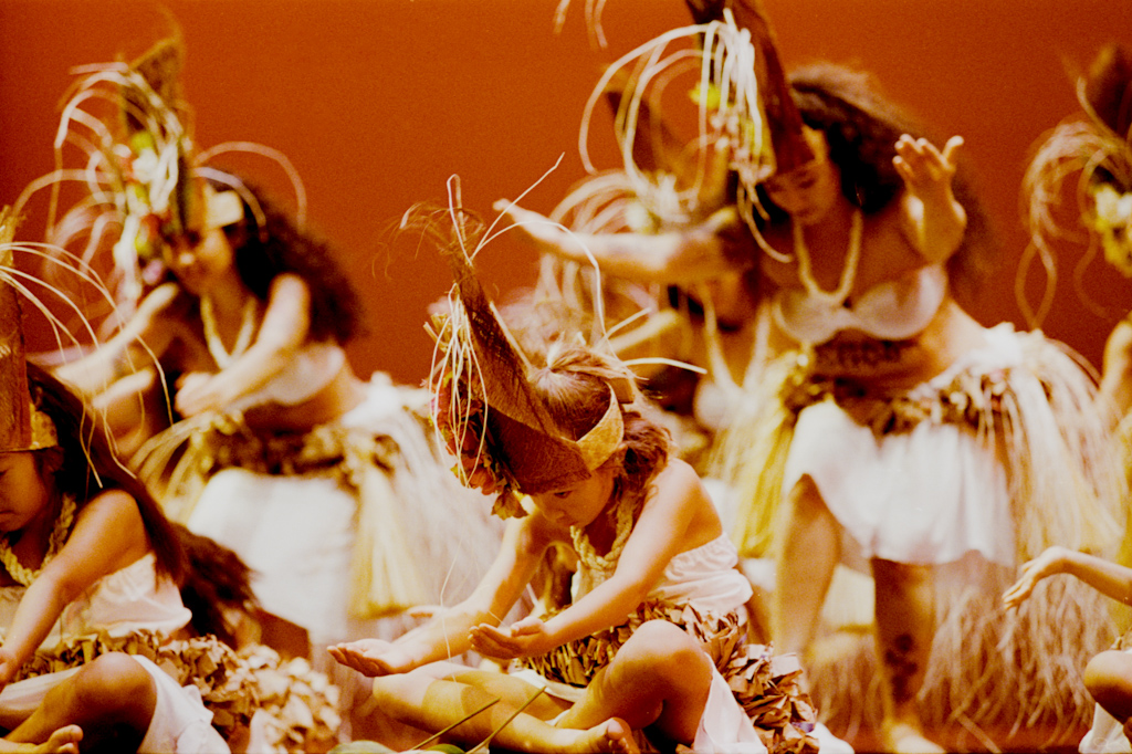

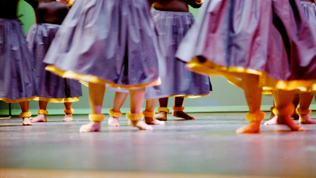

I didn’t, I have a ph meter and could test the dev. I’ve attached three good frames from the roll. The half of the roll from the hula turned out excellent other than blurry shots from difficulty hand holding at very low speeds.
Oddly the other half of the roll ended up with a pretty extreme blue cast. The camera itself was showing signs of capping and given my low amount of experience with the dev I’m having a hard time guessing what could be at fault.
Happy to post examples of the failures but I’ll need to shrink and convert them :smile:
You're mostly looking at the effects of different shooting/lighting conditions. I'm going to guess that the dancing was shot under relatively warm (Tungsten-comparable, in terms of color temperature) artificial light. The 'cool blue' shots look like daylight, partial shade etc. - overall a much higher color temperature. Overdevelopment can be a contributing factor as it'll emphasize such differences.
