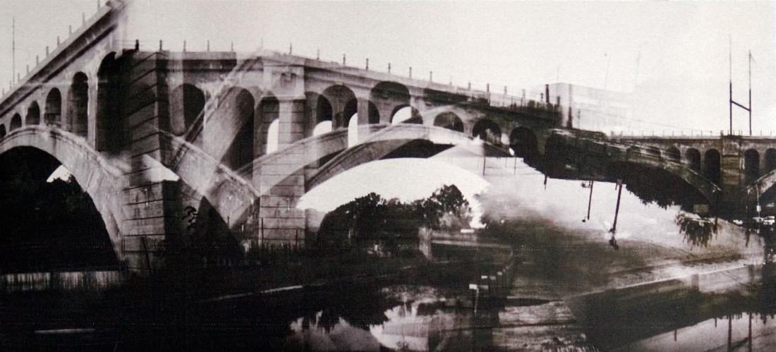

Hi, I've been working with holgas for panoramas for a bit, and enjoying it. But I'd like to enlarge the images more than just 2 or 3x. When I do so, the lack of sharpness overwhelms the image for me. I'd like something with a bit more focus to hang the rest of the image around. The holga film back seems to be one of the keys to making these images.
So, the question: does anyone know how or what other lens can be easily attached to the holga, either over the holga lens or replacing it. Or, perhaps a web site describing such that would help me. I've been working my way through the flicker site to no avail. I've got a Yashica lens taped over it now, but the weather is not cooperating for these tests.
Thanks for your help. An example image is attached.
Anne

Looks like your "arches" is a pretty good result. I think as with any Holga image, the lack of sharpness and using double-exposure techniques can make for great art that is not always predictable.
