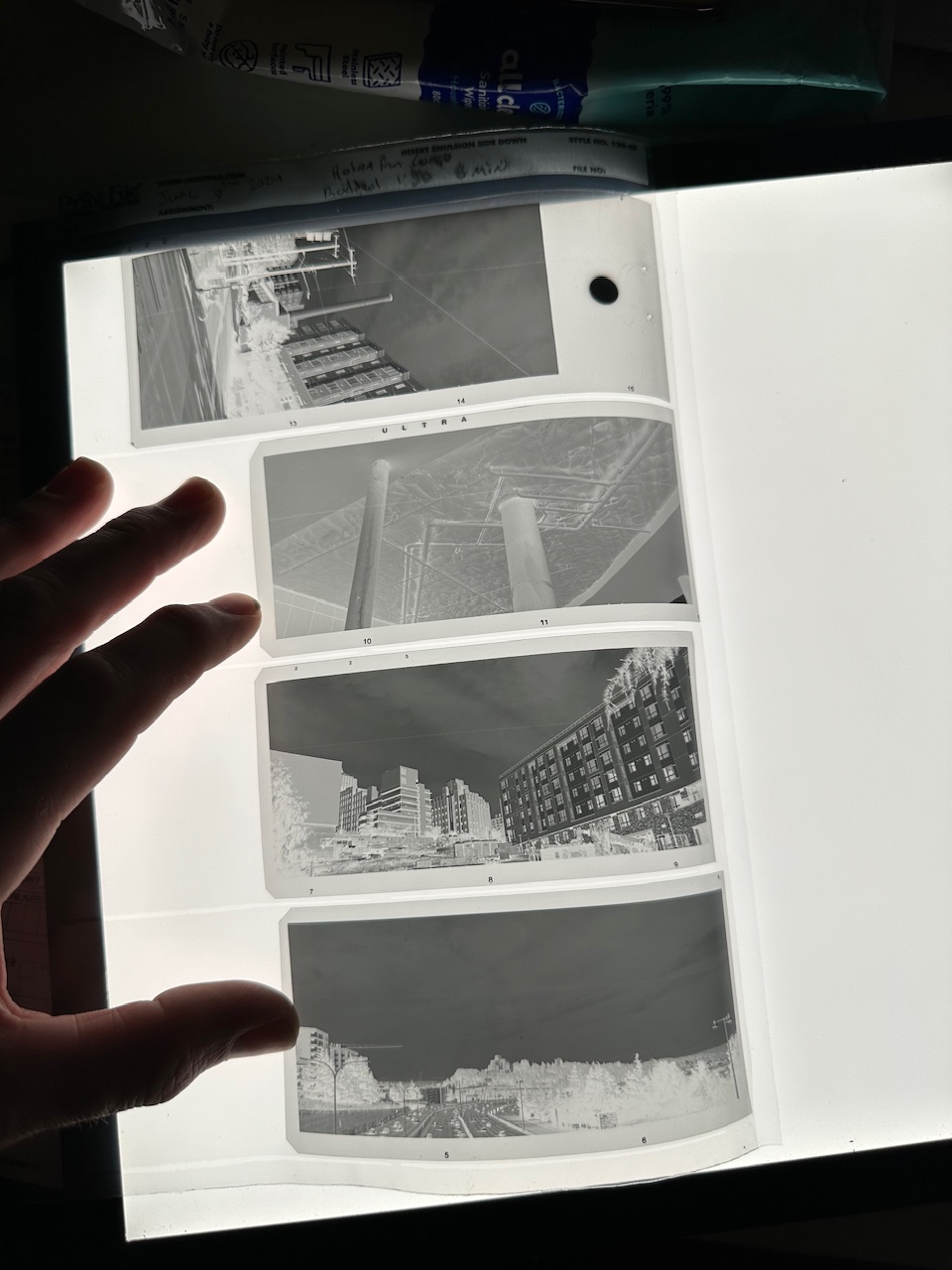

Ok. First outing went ok.
Frame spacing and film spacing were predictably weird with the 612 mask left out.
The lens (90mm Congo) seems great.
The disappointment is that in the roll with the 612 mask installed, I’ve got a nasty scratch running through the entire roll.
It should be easy to locate the offending burr or whatever based upon location on negatives.

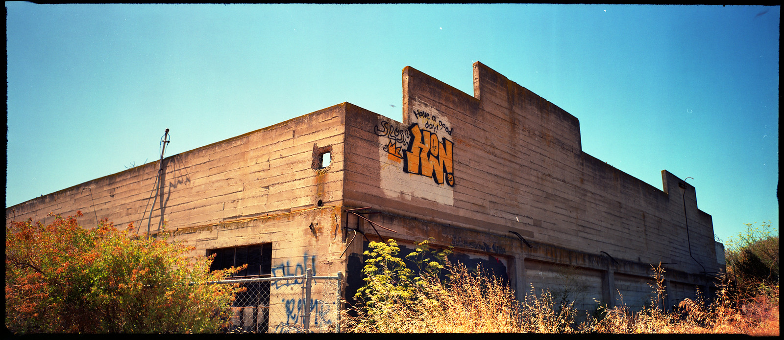

The Agfa Ultra 50 was a very contrasty and "color incorrectly" vibrant to start with, plus this roll is over 2 decade expired. Even with standard C41 process, I won't be surprised that there are color shifts and stuff. So I'm using it as it is, for its unique color palette. This is an accentuated version of colors in real world.
"Have a Nice Day" At Alviso Marina: Holga 120 Pan with Schneider Angulon 90/6.8 lens. Expired Agfa Ultra 50 film.

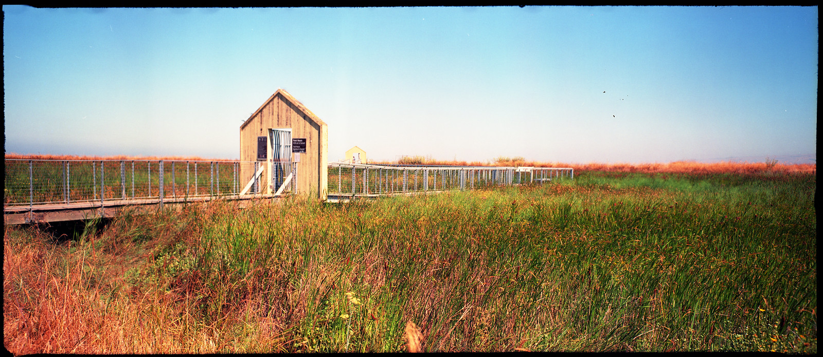

Congratulations @blee1996. Apart from nice composition and vibrant colors, My eye caught, and calculation verified, that your aspect ratio is >2; 2.30 in fact. Which I find nice, 2 being IMO a little short of panoramic. But how did you manage to achieve this with 120 film? Could it be that you pushed the width to the limit allowed by the Angulon coverage, and then had to devote not two, but three regular frames for each panoramic shot?
The Holga 120 Pan natively supports 6x12 frame, but as you noted the 6 is more like 5 while 12 is pretty true to length.
The Angulon 90/6.8, when stopped down to f/11 or smaller, seems to cover 6x12 ok. There are still some vignetting in the four corners, but not too bad.
The reason I chose the Angulon 90/6.8 is its much smaller size, which fits the toy-like Holga perfectly. a Super Angulon 90/8 will definitely have more coverage, but it will not hack nicely into the small camera frame of Holga. I have another 3D-printed 4x5 point'n shoot camera, which uses the Super Angulon 90/8.

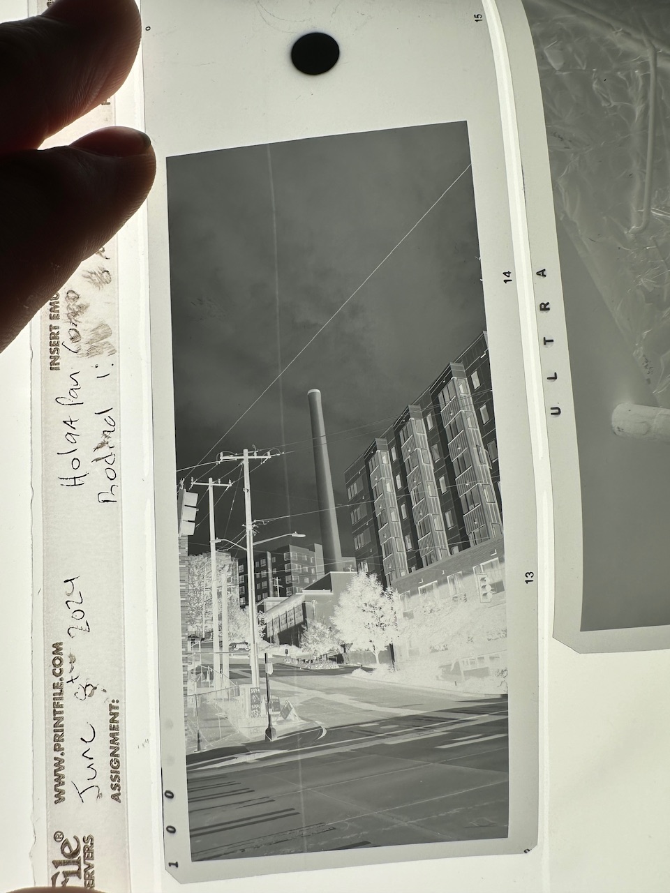

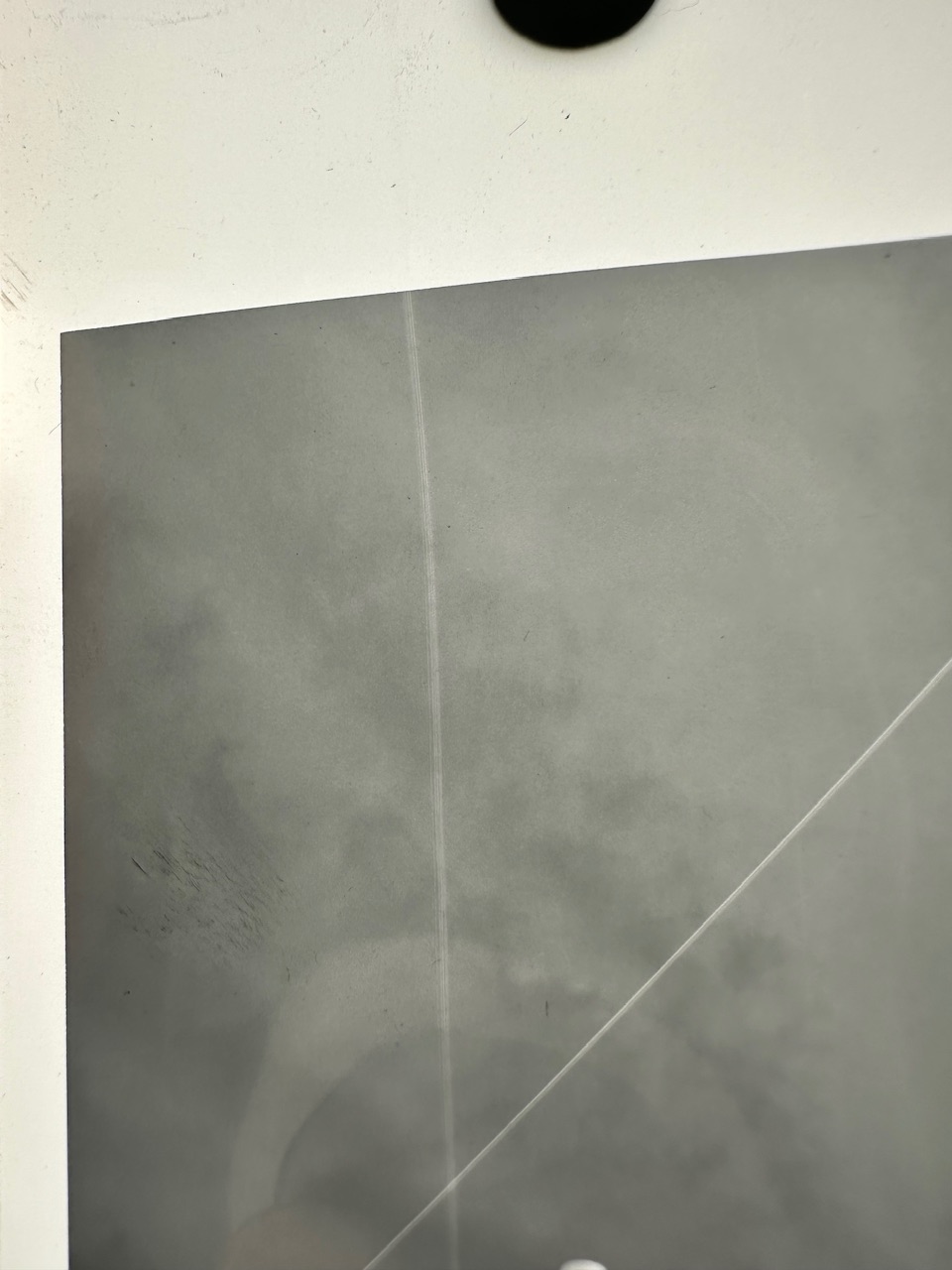

I finally processed my test roll that I hoped would be scratch free. It is not.
When is the film under the most tension, close to the feed/takeup spools, or when ready for exposure? My 1st and last frames have no scratching. Does the actual film contact the 2 pieces of foam inside, or does only the backing paper rub against those?
My sanding effort seems to have changed the character of the scratch but not fixed things, I guess I start with another round of sanding and another cleaning effort to rule out a piece of debris.
