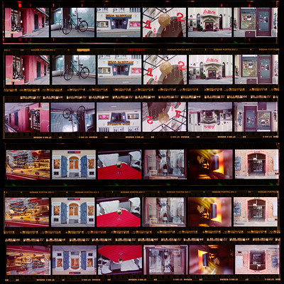

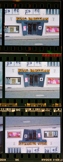

Top: SantaColor 800
Middle: Kodak Portra 800
Bottom: Kodak GT 800-5 (UltraMax 800/Lomo CN 800)
(click for full resolution)
I always thought that GT 800 was very close to Portra 800, but maybe not necessarily the same film. SantaColor 800 is even closer.
I couldn't shoot the comparison with the same lens/camera, so SantaColor is exposed slightly more. It also has the lowest fog (SantaColor 800 was fresh, Portra 800 a year old but stored in freezer, GT 800-5 was about two years old and wasn't stored cold for most of that time). With the same exposure I doubt I could spot the difference (either in color rendition or grain).
edit: One thing I forgot to mention is that I got light leaks on SantaColor 800 at the start of the roll. I shot it in my Nikon F80 which "wastes" at least two frames at the beginning if the roll, so the leaks didn't actually ruin any shots, but if I shot this roll in a different camera I would have at least 2 ruined frames. I wonder whether Optik Oldschool is aware of this and have a solution for this...
I suspect that the Portra 800 shot would look closer to the SantaColor one if you made the blacks a little darker. I would ordinarily lower it until I can't see much grain on the non-exposed part of the film. So I agree, if you compared these with their "finished" look they would be pretty similar.
