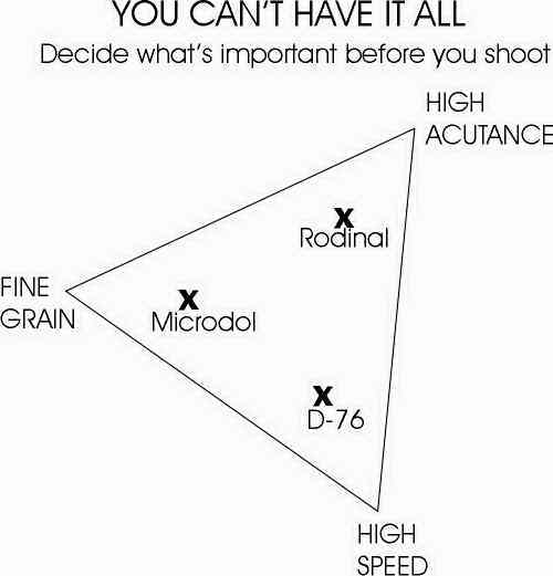

Do you use ABC film with ABC developer? The triangle above has been around for a long time and it hasn't changed. Of all the developers I have used, I think Xtol/XT-3 comes close to ticking all three points. I'm sure there are others, but of the developers purchased and homemade, those two come the closest for me.
