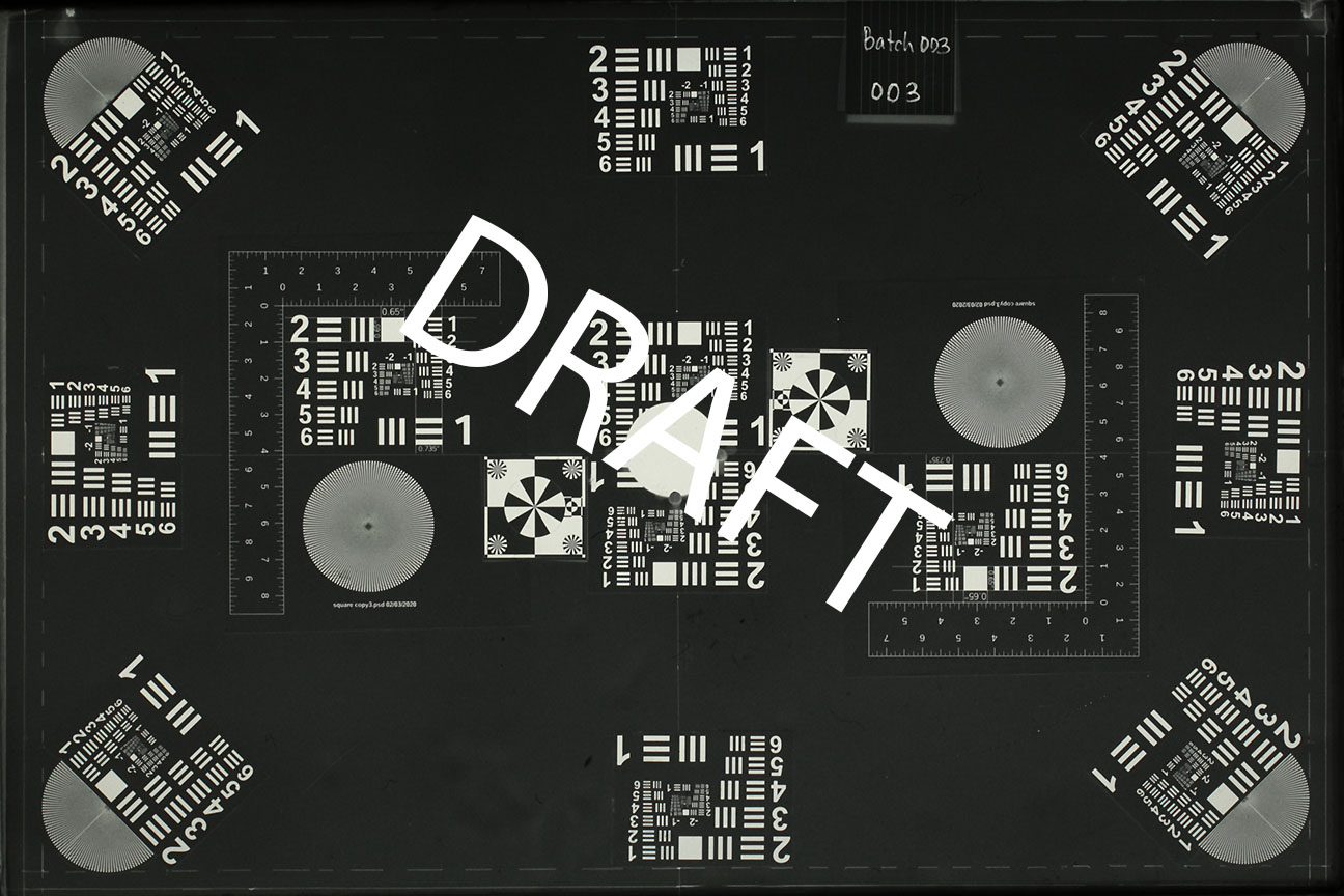

Hello everyone, just joined this forum. So i need an advice re Adox CMS 20 film. I am doing some project (making 35 mm reference target for DSLR scanning) and i need film both of highest possible contrast and resolution. So far I worked with expired Mikrat 300 but my 50 years old film understandably exhibits some fog ;-) . So i am about to use Adox CMS which is back in stock here in NYC. My plan was to get film and naitive Adox developer and ask Forum for recommendations on the regiment to achieve high contrast and keep film grain fine enough (basically i am more interested in high edge sharpness along with high resolution). Now I am hearing that non-adox developer would give me even higher contrast. If anyone can provide recommendations toward goal stated above based on the real/actual/first-hand results or manufacturers data sheets i will be very thankful. Attached is the Mikrat shot image , i need it to be done in high contrast and resolution. TIAIMG_9931_1.jpg
