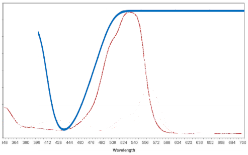

Have you quantified this by determining the ISO-R you hit in both instances? Also, are you referring to the Ilford paper OP is using? Papers differ massively in how they perform at the extremes.
Also, I'm not familiar with a Wratten #5. Is this from some other range than the Wratten range? #50 is a deep blue filter, but I can't find a spectrum for it. I wonder how the transmission spectra of these filters compare, hence the question. #5 filter, d'oh!
Ok, concerning those grade 5 and Wratten #47 filters, this is how they relate to each other in terms of density:
Blue = #47, red = grade 5.
The #47 shaves a little off of the longer wavelength blues. It's a small bit, but may be significant depending on far the sensitivity of the blue layer extends towards cyans and greens. You'd have to plot this against the spectral sensitivity of the paper's emulsions to figure that out.
Thanks for the spectral transmission chart, koraks.
I tested my (not the newest) MG grade 5 filter against the #47 Wratten gel I have with a Stouffer step wedge. I got one less stripe resolved when using the #47 filter compared to the grade 5 filter and two more stripes than the 170M setting on my Chromega head. That's a half-stop and a full-stop difference respectively, so not huge, but significant.
I did not test against a new-just-out-of-the-box grade 5 filter. Mine might be a bit weaker than brand new, but it hasn't been used that much. Paper was Ilford MB Classic FB.
