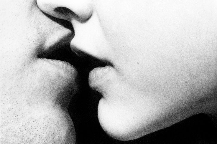

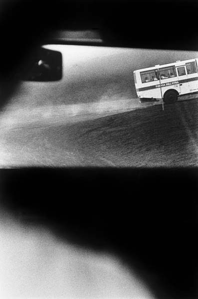

Hello everyone,
A quick introduction: I've been shooting b&w film for the last ten years and had a darkroom for about three years.
Unfortunately since moving to a new house the darkroom is gone but it's my intention to build a small one again and go back printing the analog way.
I consider my photography really experimental, I have used about every combination of film and developer out there and have never been really satisfied with the negatives I got.
I have a preference for really contrasty prints/ negatives and don't mind if there's grain if it reinforces the quality of the photograph. I very much like the style of people like Ralph Gibson or Renato D'agostin (see attached examples).
I know that Ralph Gibson used to shoot Tri-x at 200 iso in very bright sun and then overdevelops his negatives so they become very dense.
The problem is that where I live we do not have a lot of sun, in fact, in the winter there's lots of overcast days with very little contrast which would give me 'dull' negatives without crispy whites.
What could I do to get those contrasty negatives? The options I'm considering so far are:
1. Underexpose Tri-X at EI 800 or 1600 and develop longer in Rodinal, so I would lose shadow detail (black shadows) but midtones and highlights would become more crispy/ contrasty. The problem is that iso 800 / 1600 is too much for shooting in overcast light.
2. Overexpose Tri-X at EI 200 and overdevelop so I would op up shadows and get contrast in the highlights. The problem would be that EI 200 might give me too slow shutter speeds and I'm not sure if I'm interested in having lots of detail in the shadows. I like the 'chiaroscuro' look with really dense blacks and really dense whites.
3. Try stand development in Rodinal but I'm not really sure what this does to the negative contrast ?
I know that high contrast can be achieved in the darkroom with grades and filters etc. but at the moment I'm more interested in how to get the raw material, that is the negative.
Would be happy to hear your opinions:smile:
Thanks !
