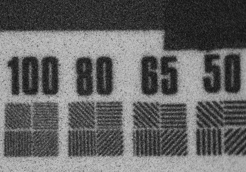

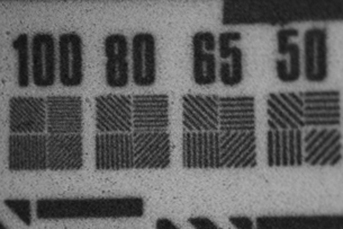

Here are T-max 100 in Xtol 1+0 and in FX-1 resized.
Originally this was a test to see if the acutance developer produced what Pat Gainer called ,IIRC, the picket fence effect,where the lines from the acutance developer merged. TMX seems resistant to edge effects and I could not see any picket fence effect with this particular film.
A very generous APUGger loaned me a set of chrome USAF targets and using Xtol and Acros, I think I was able to measure about 150 lpmm after a few trials. Like Sandy says, it's not easy, and I was still a ways from what Fuji says they get (200 lpmm).
My results with T-max 100 film in Xtol 1+0 (solvent) and FX-1 (Acutance) don't show much difference in resolution.Photomicrographs of negatives of test chart, numbers on chart are resolutions in line-pairs per millimeter.
Lens was Canon ef 50mm f1.8 at f5.6.
Yes, this proves the point. Lens and film emulsion control resolution to the largest degree. Exposure and development can optimize it, but not radically change it. However, overexposure and overdevelopment can really mess it up!
