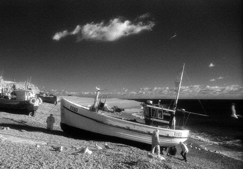

I bought some 1993 dated HIE at a camera fair,dont know how it was stored but it still seems to work OK.Here's one with the 87 opaque filter.

Nicely done Alan! Looks great! I can relax now and find worthy subjects for my precious....
