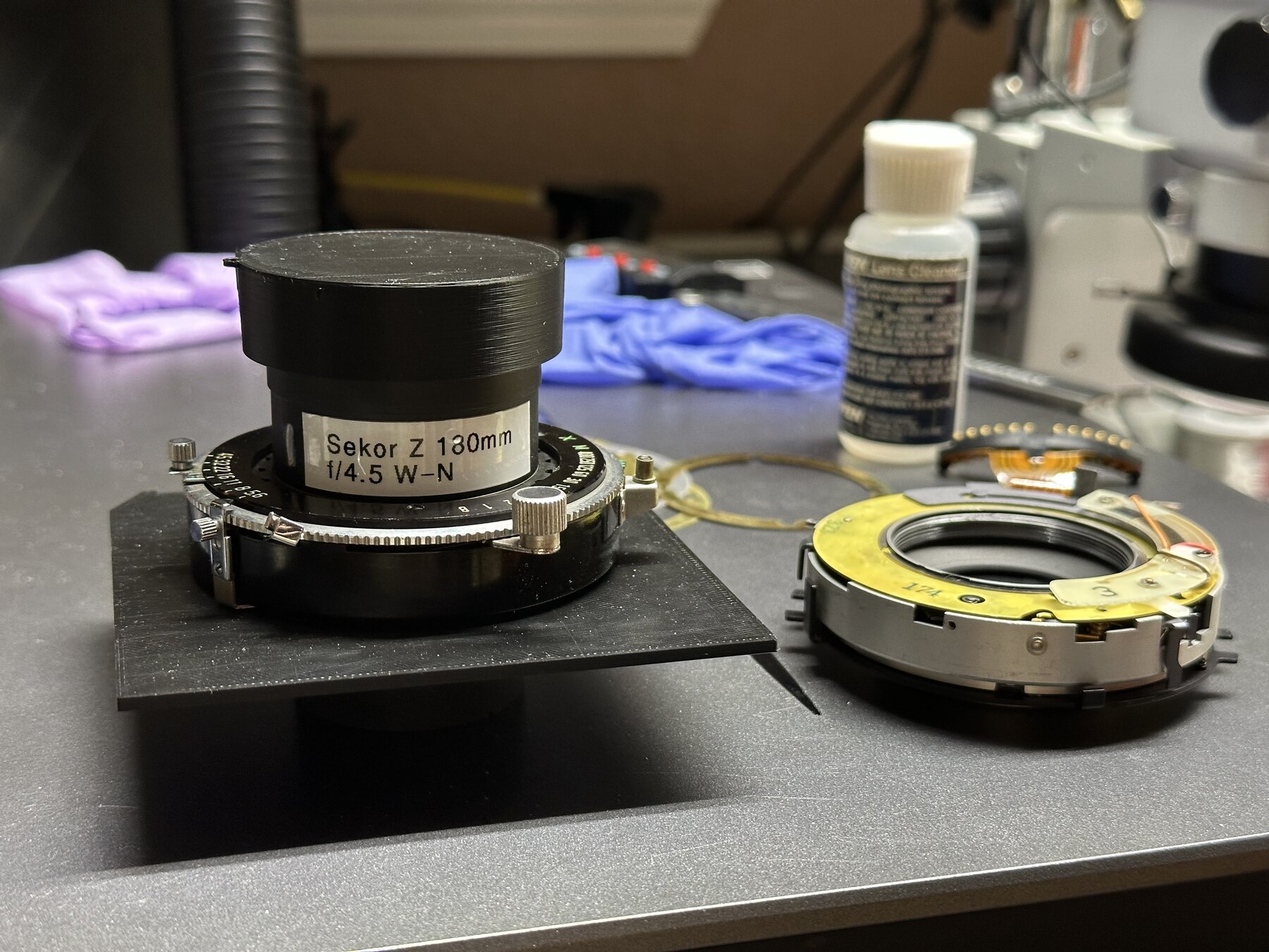

Too late, I’m afraid. I have three 4x5 cameras and one of my current projects is to mount the lens cells from a Sekor Z 180mm lens in a Seiko #1 manual shutter - I hope to finish that one this weekend.
Well, what’s done is done. It starts off all innocent with a #1, then before you know it you’re like, “Yeah, it’ll fit, but the weight is gonna be a problem. Maybe I could design a support and get someone to machine it for me…”. Good luck with that.

But first, playing with my discombobulated Mamiya 180mm lens - the manual shutter arrived today and it fits great, now I'm 3d printing a lens board and caps :smile:
