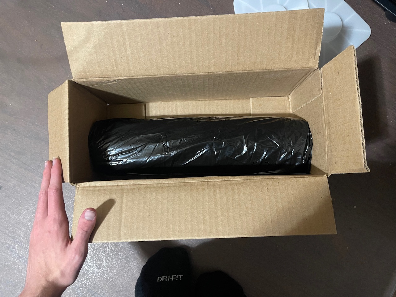

Well I received the roll today, and… well it’s interesting.

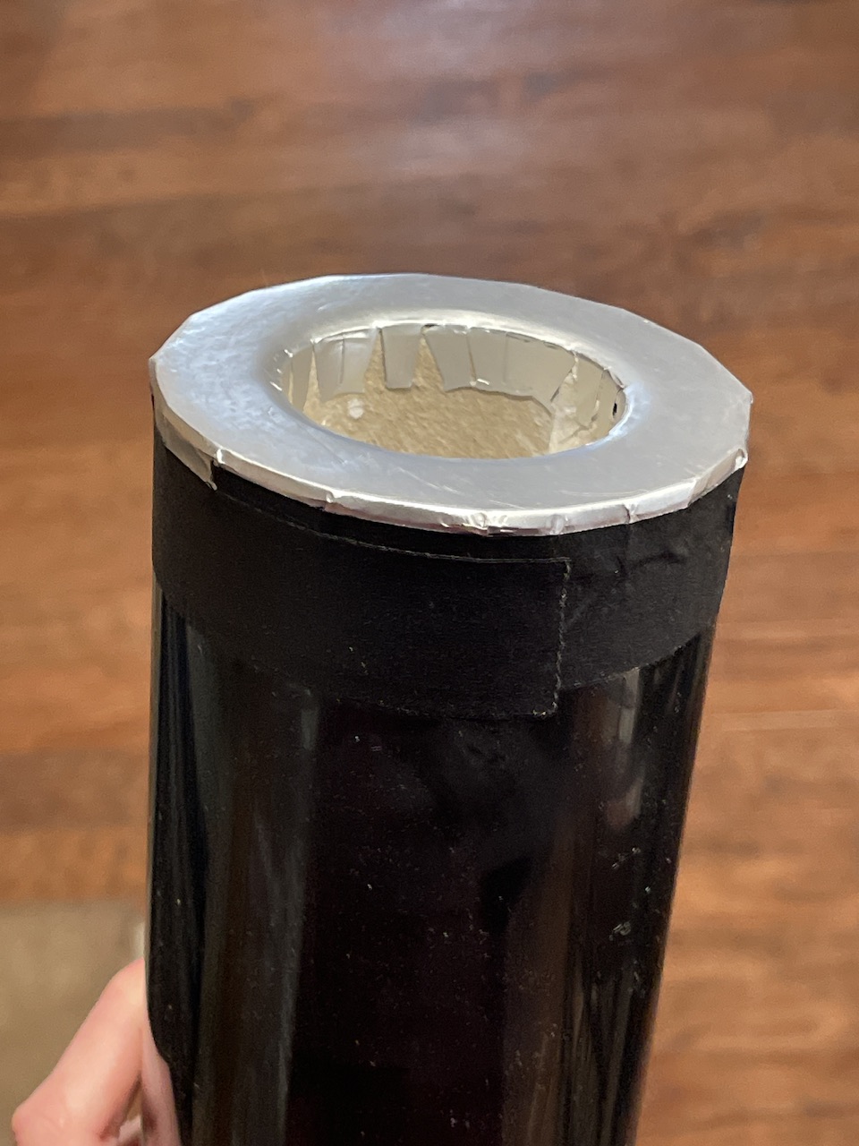

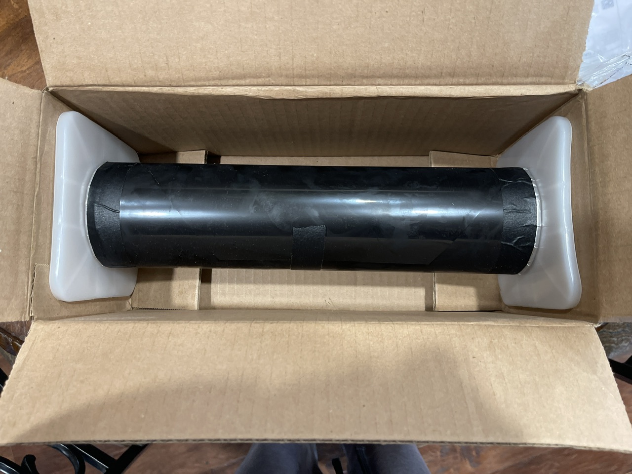

It came just as a bare roll with black leader wrapped around it and foil at the edges. The one specification number that I could find was on ultrafine, which said that this was supposedly a daylight roll. But I’m not sure how that would’ve worked because when I took off the leader, the foil things at the edges got really torn up and basically destroyed. So if I had taken the leader off in daylight, the roll would’ve been fogged at the edges at minimum.
I had to make my own packaging from a large black film bag, and some of that Astrum backing paper in order to store it since it didn’t come with a can.
One more surprise, this stuff is apparently not from Agfa. AFAIK Agfa’s imagesetter film is blue, this stuff is brown.IMG_4828.jpeg

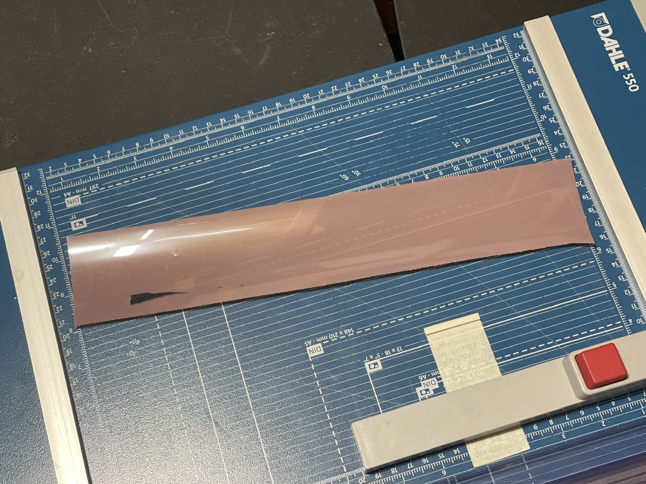

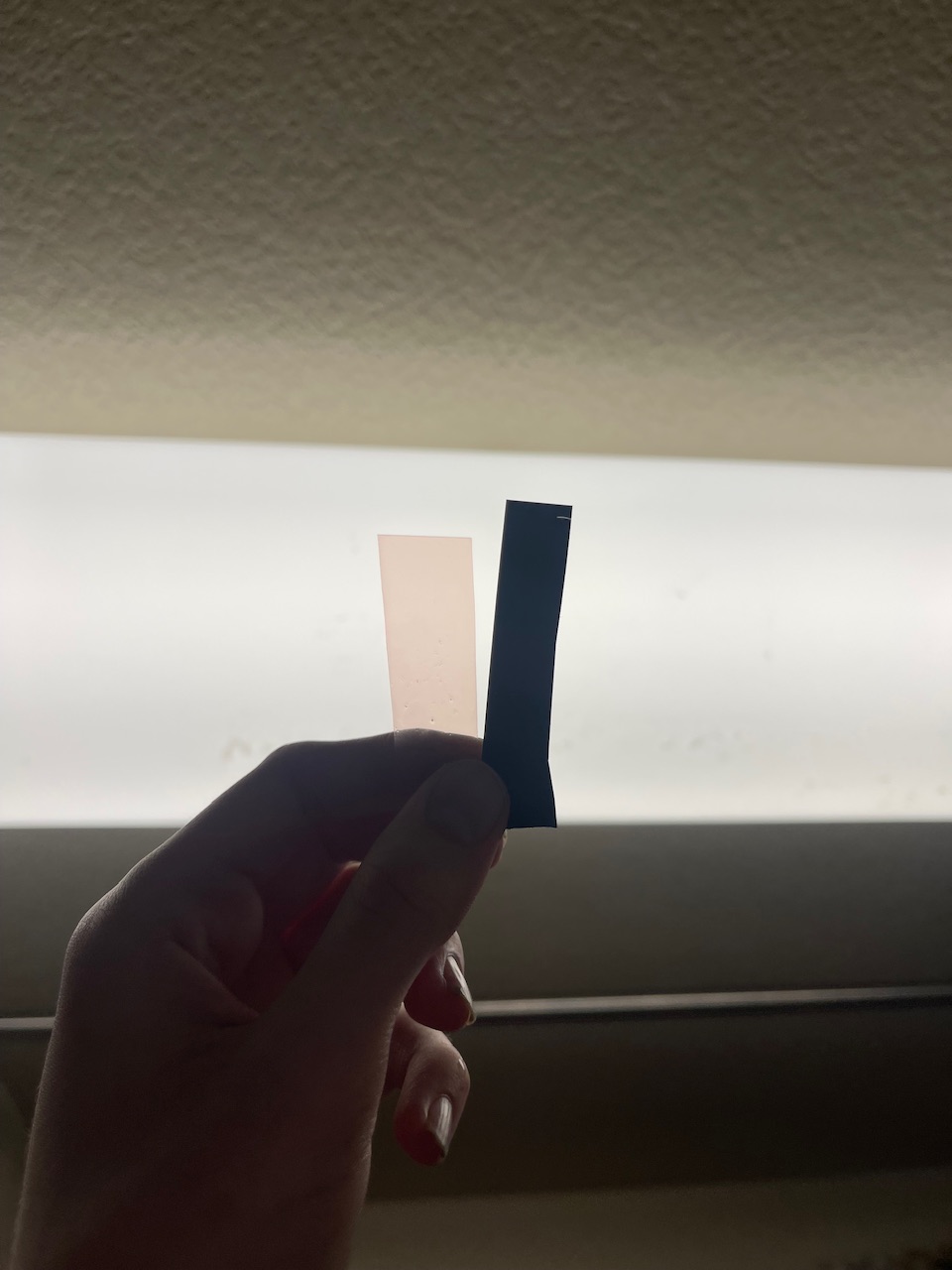

Clip tests with lightstruck film. Left is just fixed, right is developer and fix. The film appears to have a pink base, I’ve washed the fixer snip for a good little while, and it has not disappeared.

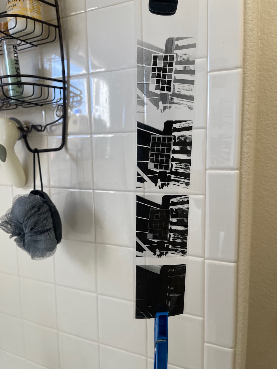

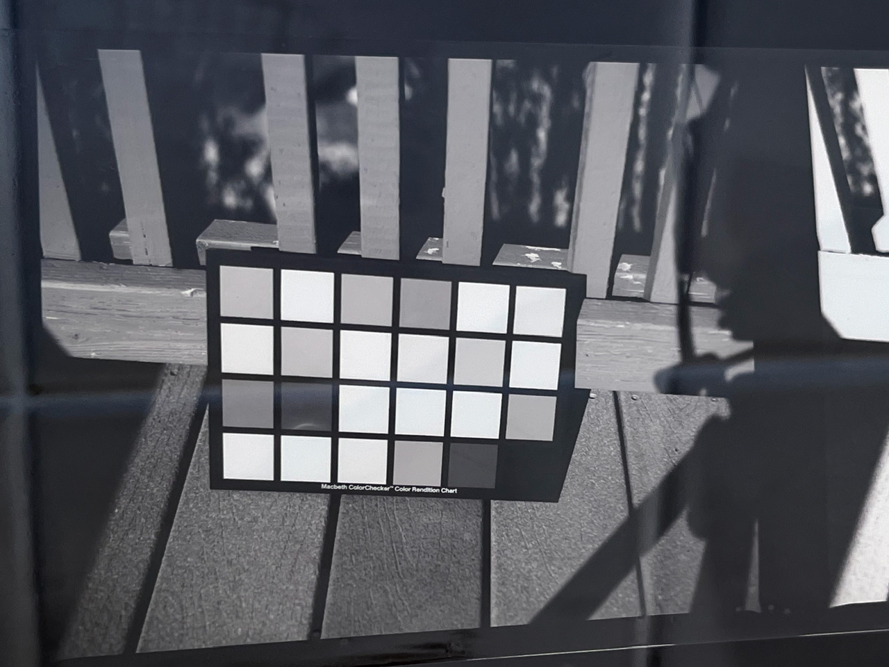

Took pics of a color checker, and developed in D-76 stock for 6 minutes. Exposed at EI 3, 1.5, 0.8, and 0.4. 3 looks correctly exposed, and from the color checker, it looks like this film does indeed have extended red sensitivity, and very little green sensitivity. Contrast is very high, as expected.
It looks a few stops under to me, but massively overdeveloped. Looks like around ISO0.6 should be OK, but you'll have to find a way to reel contrast back in. Also there's probably a lot of halation and light piping going on at that point.
Honestly, I’m not sure how to tell the difference. To me it just seems like a ridiculously high contrast film, which is what it’s supposed to be. But idk.
For evaluating film speed, I look for detail in the darkest shadows. I can see some detail in the shadows at 0.8, so to me, that looks closer to correct than 3.
You need to cut development hy a lot. This will not be easy. Which developers do you have on hand? If it's just D76, try diluting 1+8.
You'll probably have to run a few cycles of exposure and development tests to get this right, but I don't see any issues with making it work.
i’ll play around with different developers and exposures, see what happens. Honestly, I do like how EI 3 turned out, so for the moment I think I’ll stick with that for now.

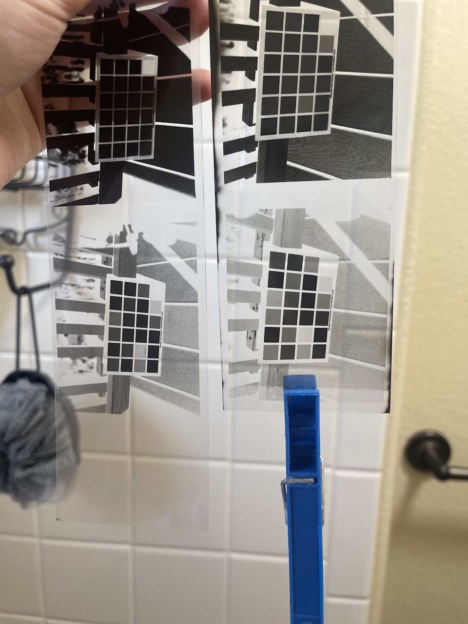

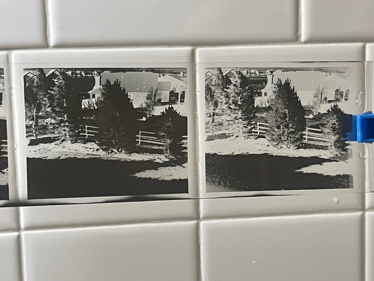

Well, I just developed another test strip for eight minutes in HC110 F. The overall density has decreased slightly, but so has the contrast. I would still say that EI 3 to 1.5 is probably the best exposure you’re going to get, although I think 1.5 is a bit overexposed and 3 is a bit underexposed, so I might need to adjust the developing time slightly, or rate at EI 1.

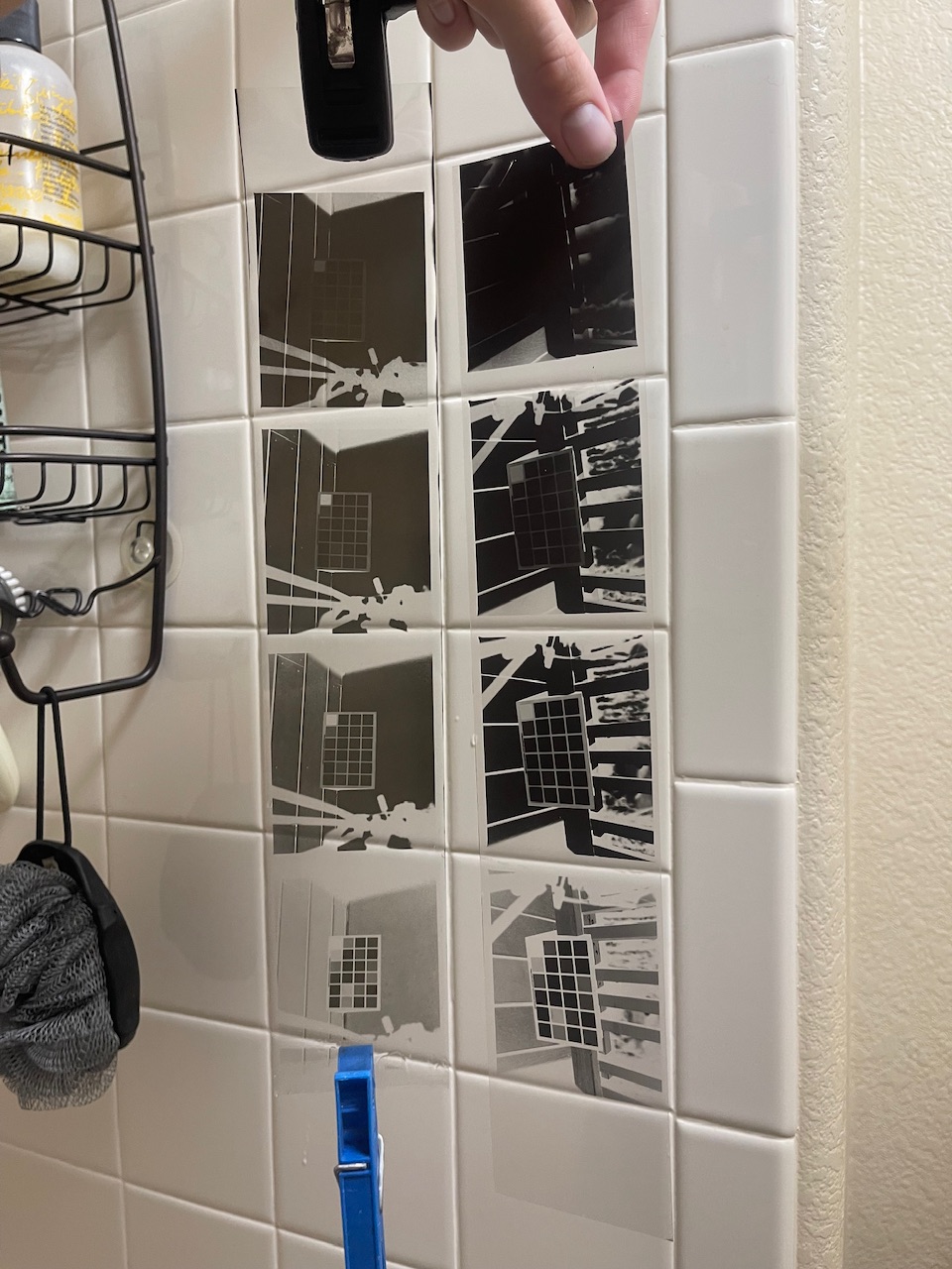

Just developed another roll of IR imagesetting film, and 9 minutes in HC-110 F looks to work great! I’ll be developing a roll I exposed behind an IR filter next with this time to see what happens.

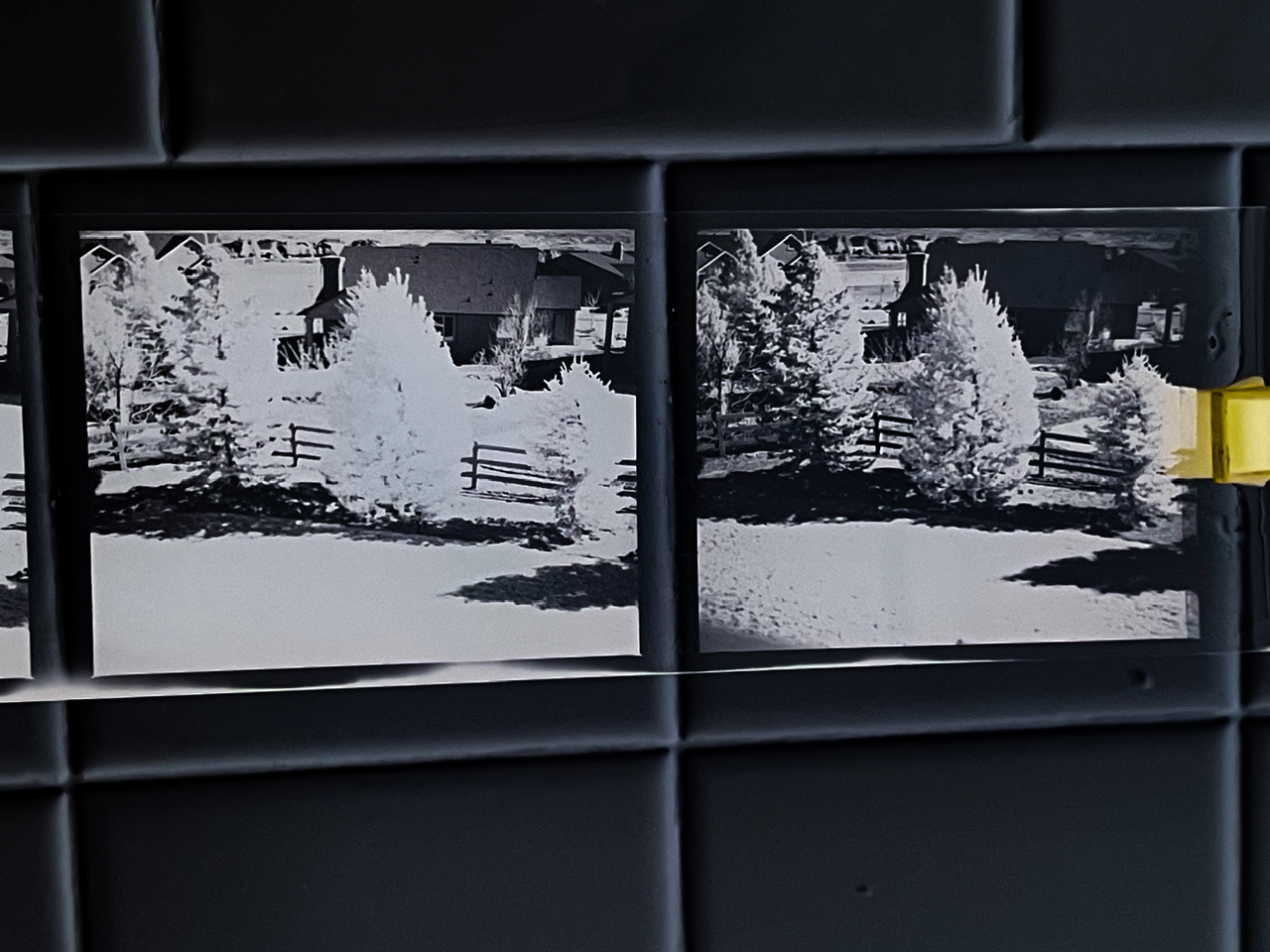

Guys… It works. It works as an IR film. And it works really well. Negatives shown here EI 0.8 and 0.4, developed in HC 110 F for 9 minutes.
