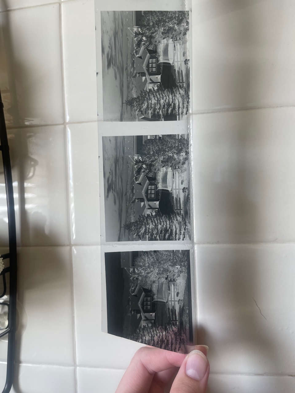

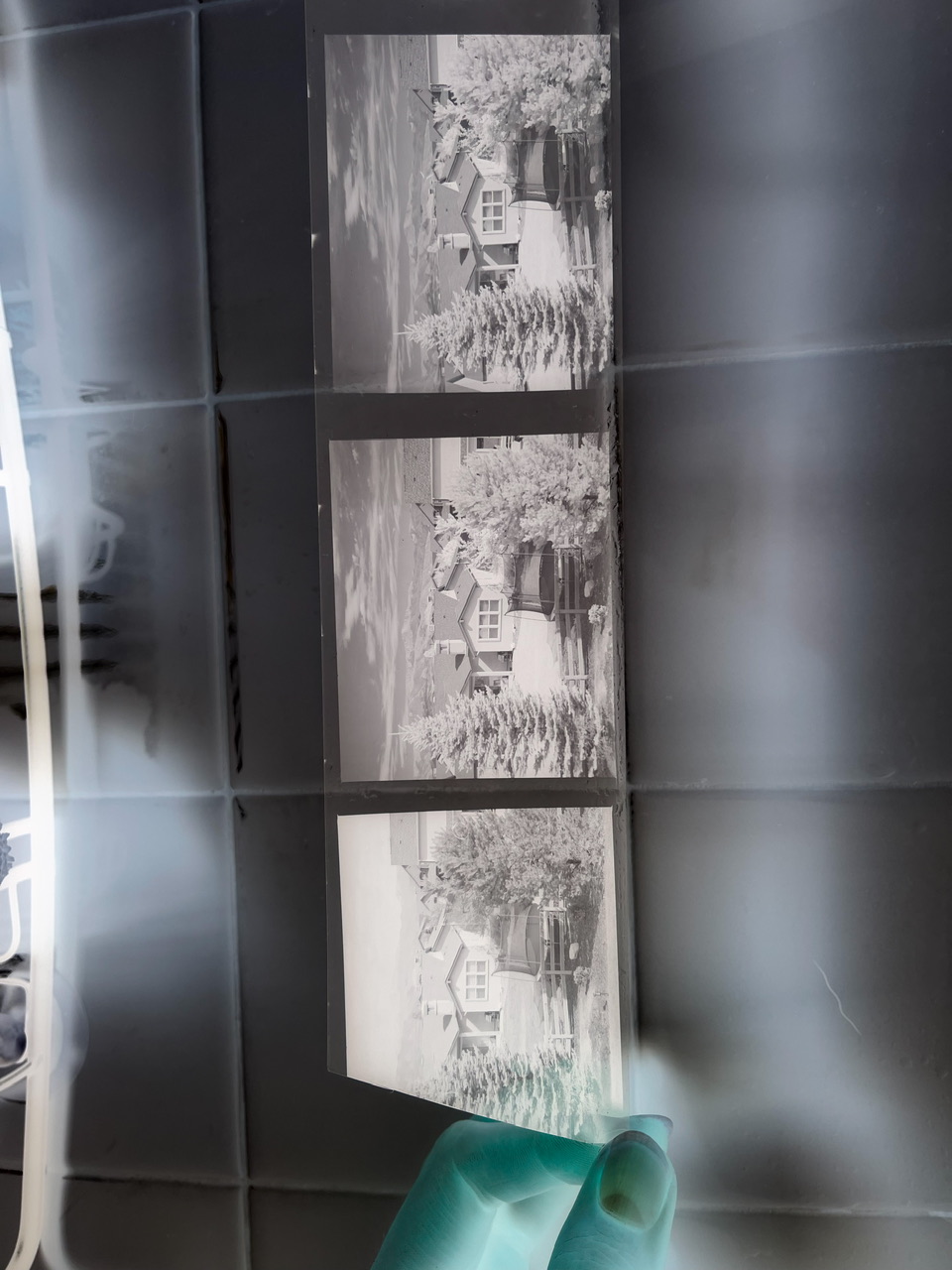

Not exactly sure where else to put this, but I did an experiment stripping the antihal off Aviphot 200 to see what would happen, and although it can be done, I honestly don’t see any halation whatsoever…
Top to bottom:
EI 25 IR
EI 12 IR
EI 100
Very rough inversion.

A potentially stupid question then: did you wash it off before making exposures?
What I did was:
1. 5s distilled water rinse followed by
2. 10s distilled water rinse, finished with
3. 100% IPA bath to stop the removal process and to make my Aviphot dry very quickly.
4. Go out and make some exposures. Landing on the side of underexposure might be beneficial as halation increases the effective exposure and blows highlights easily.
The gives a very clean AH removal.
Best to shoot such a treated film ASAP and to load/unload it in complete darkness.
What I did was:
Yes, before exposure.
I did 15s in water followed by 15s in 91% IPA which stripped the antihal off the film without removing any sensitized dyes. Dries on like 5 minutes which is nice. Basically zero gelatin on my strip though.
